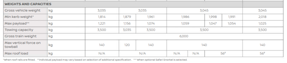

This may of been explained before but can someone fill me in on how a vehicle weighing 2910kg GVW can tow 3.5t when its GTW is only 6t? I didn't think it was that heavy empty and apparently its one of the lighter trucks??

Ive googled it. Basically after taking into account its kerb weight plus me Ill have about 300kg to play with before I'm over the train weight. Thanks for pointing that out Fred - I hadnt considered it before but that should be fine for what I carry
The gvw of it is including the payload which i think is around 900kg on the nissan so empty nissan =2000kg + trailer @3500kg is 5500kg so 500kg inc driverand fuel left for payload
Is about 250kg on ranger

Ollie you'd need to put the pickup on a weighbridge the book figure doesn't take into account towbar and any other options.
Price seems good but that rear coil spring looks wrong when loaded or towing the arse end squats down although heard they did an update. Ranger has over the last few years always won every group test and came top for towing.
My 3.2 auto ranger weighs in at around 2.3t if I tow 3.5t with my in pickup I'm lucky to have a spare 100kg which doesn't go far with a few bits of kit on the back.
I'm debating paying the money and getting wabtec to do the gvm and gtw upgrade which on the ranger is a vb semi-air rear air bag that sits between the axle and chassis. That way would get a 7t gtw and ability to carry a ton on the pickup
