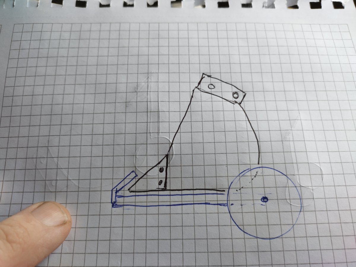

Me being lazy🤫 I would have the ‘pair of discs’ on an axle to to the right width then weld a short end of channel that the discs axle fits in snuggly on the back of the bucket, so just locate the axle pull a digging length, lift the bucket of the axle pull the trench and repeat👍 all done without leaving the cab😉
Similar idea if I`m reading yours right, 2 discs on an axle with some form of channels going forward, with a lip on the front edge to hook the cutting edge/teeth into and then sit the bottom of the bucket onto the channels in use?

I really like this idea Mogs . I could actually get that made up locally as well quite quick .
Any chance you can scribble a cross section of it ? I would have the discs slightly wider than the bucket so it cuts a little wider than the dig

My idea or @Mogman s?
Do I need to get my crayons out? 🖍️:LOL:

Your ideas go me thinking . Could I weld a length of channel full width on the back of bucket that drops down over the axle which has 2 sleeves welded on it leaving the width of the bucket between them and then the discs attached to the axle after the sleeves . This would keep the discs evenly spaced slightly wider than the bucket and as in Mogs/Craig’s version held in by the force of the bucket until I lift up then it’ll come off
This kind of idea I'm thinking.
