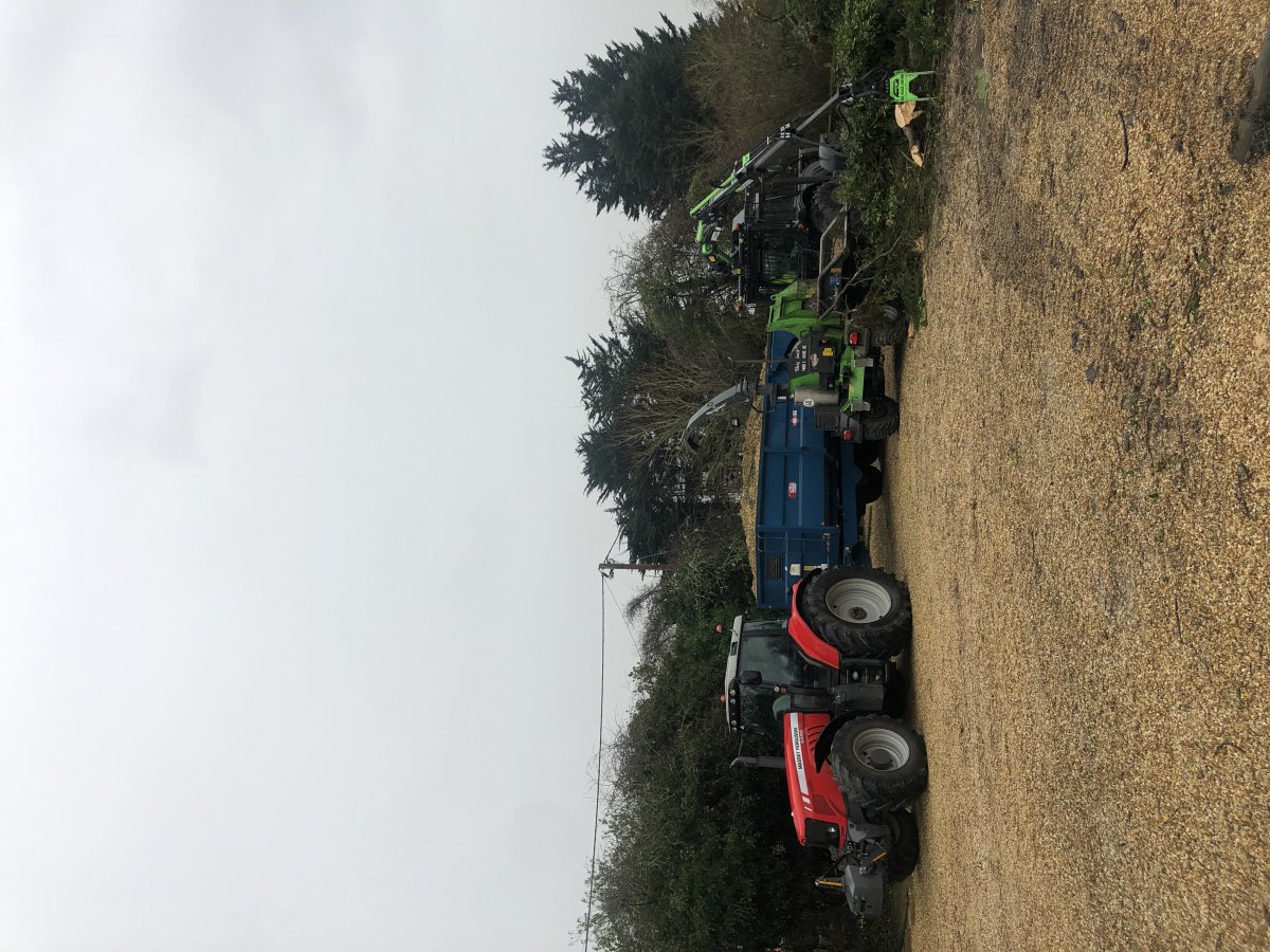

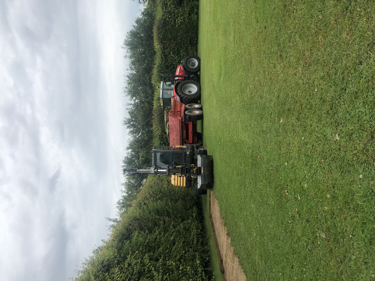

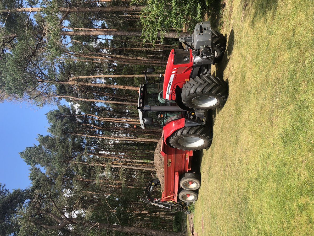

the multipurpose trailers are great but nothing beats the right trailer for the job
the herbst dump trailer serves me pretty well, good capacity, tows well and good visibility for getting it in places.
of course when i’ve got big loads to move i break out the te20 and tipping trailer

This one in grey? Would be ideal as like you said it’s straight on no messing.
Had my eye on the NC equivalent but they are nearly 5k more! Very nice lay made though!
Yeah, that grey one - that’s what I’d go for if buying again. Mine came from Arfon Roberts in North Wales, he was as cheap as anywhere.
Broughan trailers look to be about the best made that I’ve seen, but are strong money in comparison.

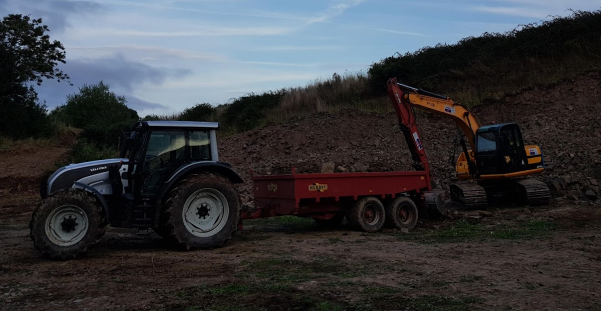

I know it doesn't really count as I'm a farmer but we've got a valtra n101 and a herbst 10t multipurpose dump and it tows our jz70 along a treat in there. Only thing to fault with the herbst trailer is the tailgate is a bit funny and has broken off when it got hit by a large rock. Upcoming project fixing that to post ;)
(Yeah I know thats a rental js145 I think but couldn't find any of it with the jz70 in the trailer, I'll keep looking..!)
That valtra has a mean loader on it too.
That’s tidy, would probably do me , reackon you’d get a 6 ton dumper in it?
honey_badger
honey_badger
Not sure I've never driven a dumper or done much work close to them. If you've got a width or anyone knows a width I'm happy to take a measurement. Its quite tight on the blade of the jz70 though. I imagine it'd fit in.
2.3 m wide
4.4long
Only 4.3 ton so that’s the easy bit

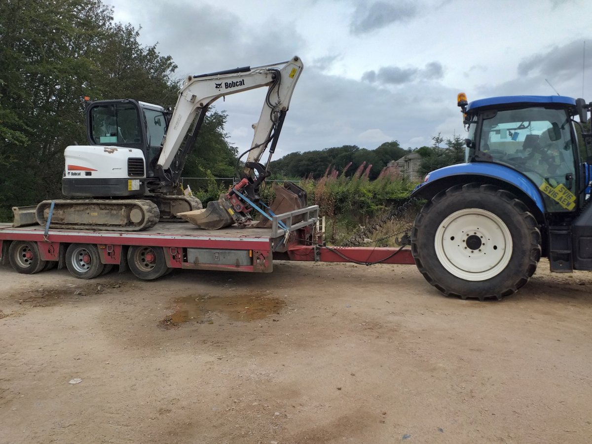

Don't look at the strapping. No idea what I was doing that day :unsure: :p Think it was just along tracks
We use a haulage company to shift stuff but sometimes your just a mile along the road or somethings broken down or something needs out one gate of a site and into the other!!!
Was a drag trailer but we changed the hitch and light bulbs and away we go. Lifting axle is handy. was even still tested till end of last year!!
that explains the long draw bar then

Measured it today. 2.34 wide, 4.3 something long. Those measurements are on the side of caution though. Can remeasure to greater accuracy if you want. The digger is a proper tight fit, was brought to fit though, and as it does. The dozer blade is proper tight only 10mm each side maybe even less.
