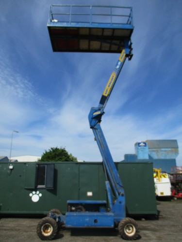

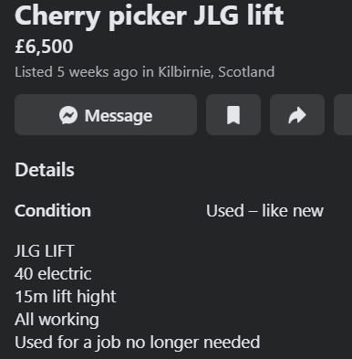

Been eyeing up cherry pickers as my roof needs a lot of slate maintenance the next few years and every time I go up with a ladder to fix 1 slate I seem to break another 3. The scissor lifts look fine for doing gutter work etc but problem is they only operate on one plane, I think you would kick yourself if you needed to do a job that required even just a small amount of reach, like working on a chimney stack or whatever, and also as mentioned the fact the ground needs to be flat is a pain in the arse, that would probably only be suitable for 50% of jobs in reality.
There's a JLG articulating boom lift near me that I spotted but doubt I'll take the plunge yet, allows 227kg lift, might be more suitable, albeit not towable..
As you are a company you will need to be on top of all the LOLER related stuff as well I presume? The 2nd hand bargains tend to come when stuffs missing these certs and they can't be arsed getting them!
looks tidy enough that, but a 'concrete' machine - zero ground clearance and very narrow wheels ... doesn't look to have done a great deal/had a hard life -- no mention of VAT either :giggle:

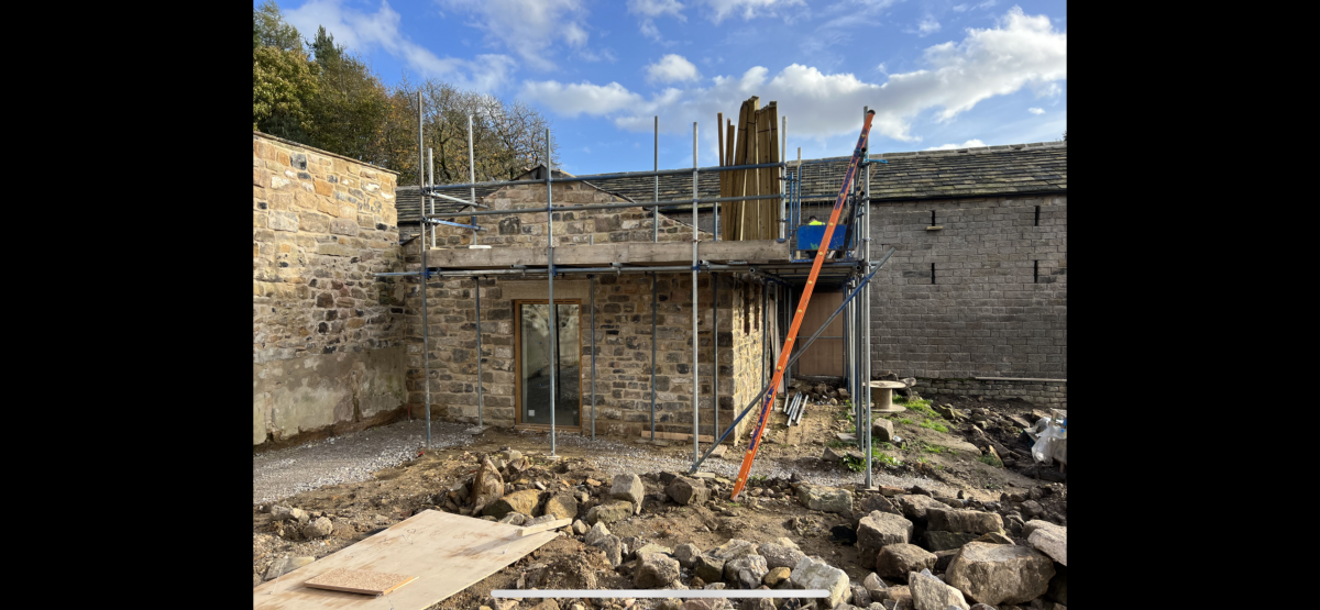

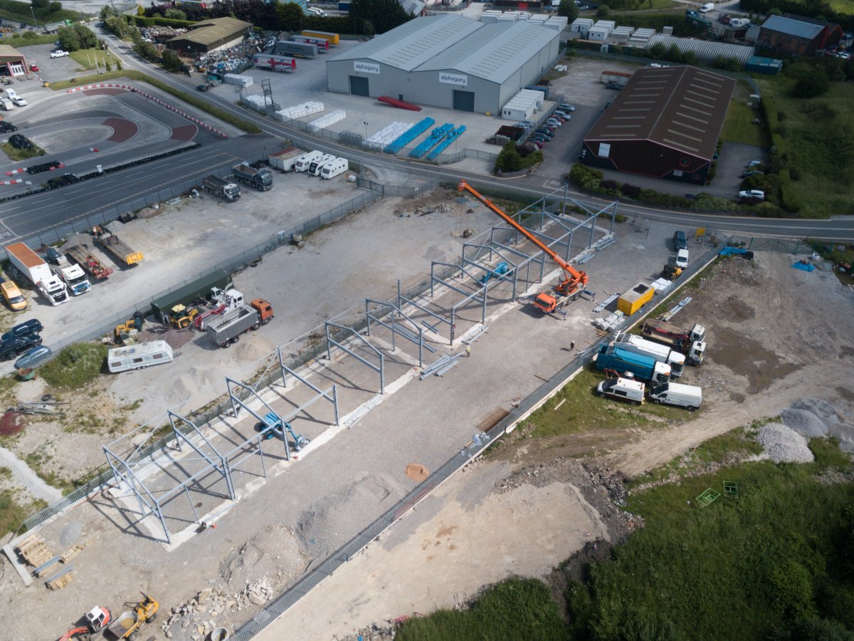

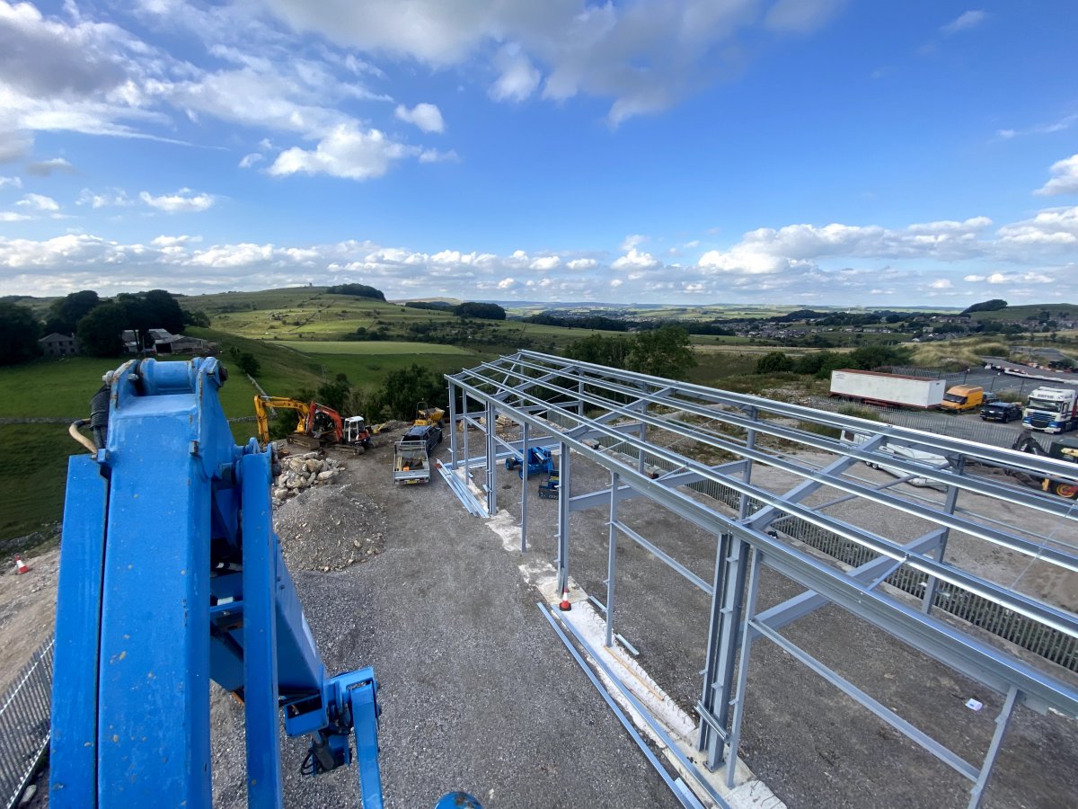

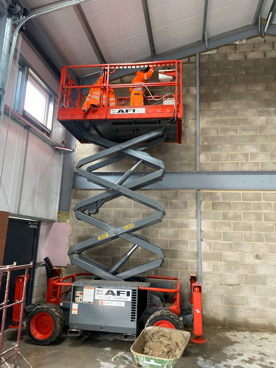

Been in plenty of booms owned a few tower ones and yeah they’re great for what they do but most the lift work we do is stone work. Plus we are a firm of big boys 100kg plus abd add in say stone lintel etc and booms just can’t cut it or are wobbly as feck.
The scissor lifts with legs offer best working platform for what we do to do it safely and securely. If I need a boom I’ll hire in a very big genie like we use for steel fitting.
Spent over £20k on scaffold this year alone reckon could have done a few Jobs with just scissor instead and not waited weeks for scaffolders to turn up.
Doing the metal sheds scissor is better with bigger work area and can lay blocks off them if you have to.
Working out a basket on slate roof isn’t easy either not designed to be lay down in them trying to replace a slate etc designed for waist level and above work
