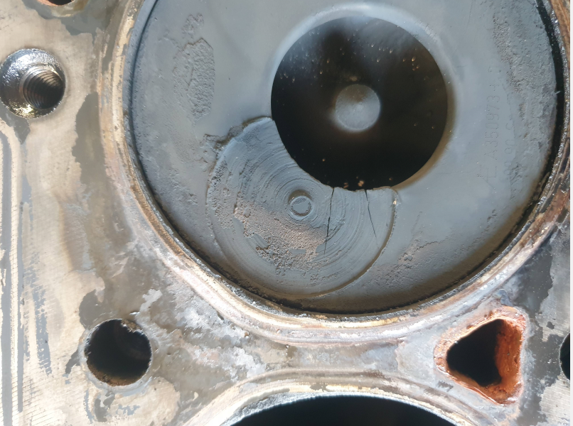

I think the deformation was brute force rather than heat. The engine was still running, but went from "normal" to "can't ignore" over 50km - on the freeway anfter a weekend away in the bush.

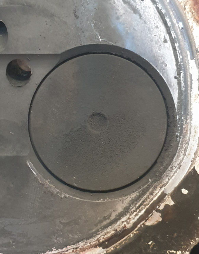

I've never been inside a 300tdi, but this valve looks ok to me. Confident it "wasn't there at the time"
