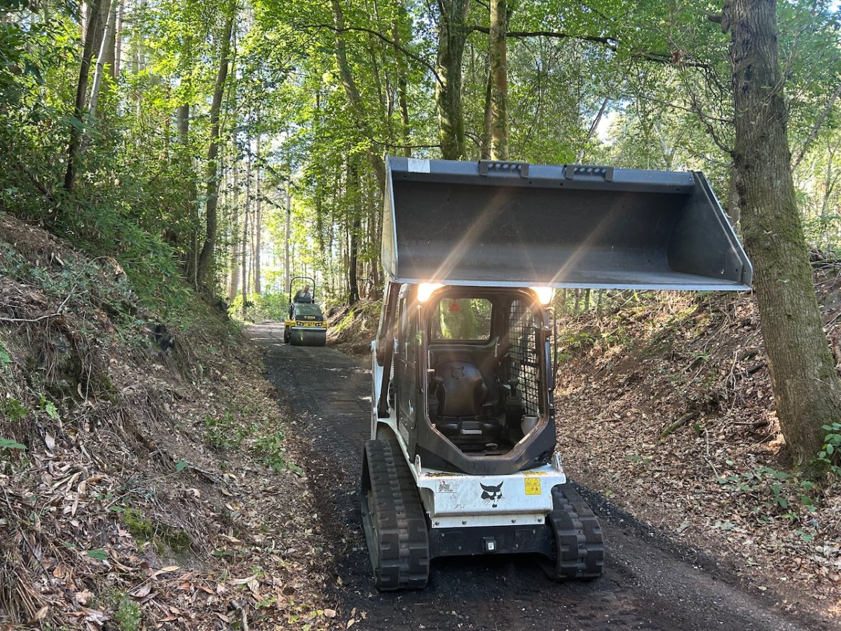

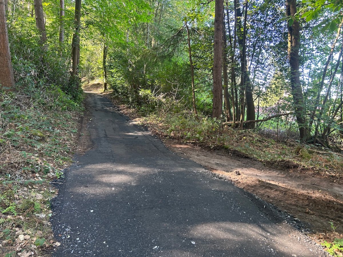

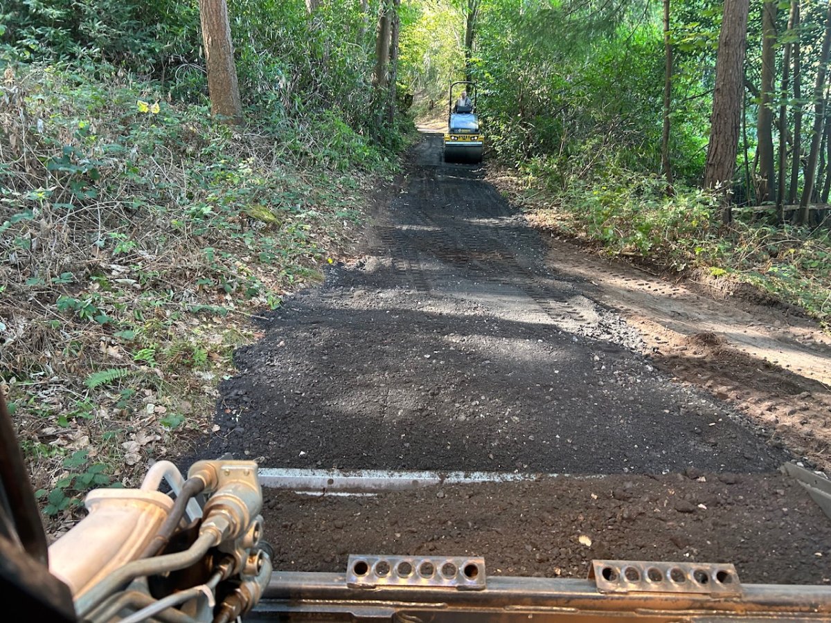

So quick. Embarrassingly easy to make humps for water runoff.

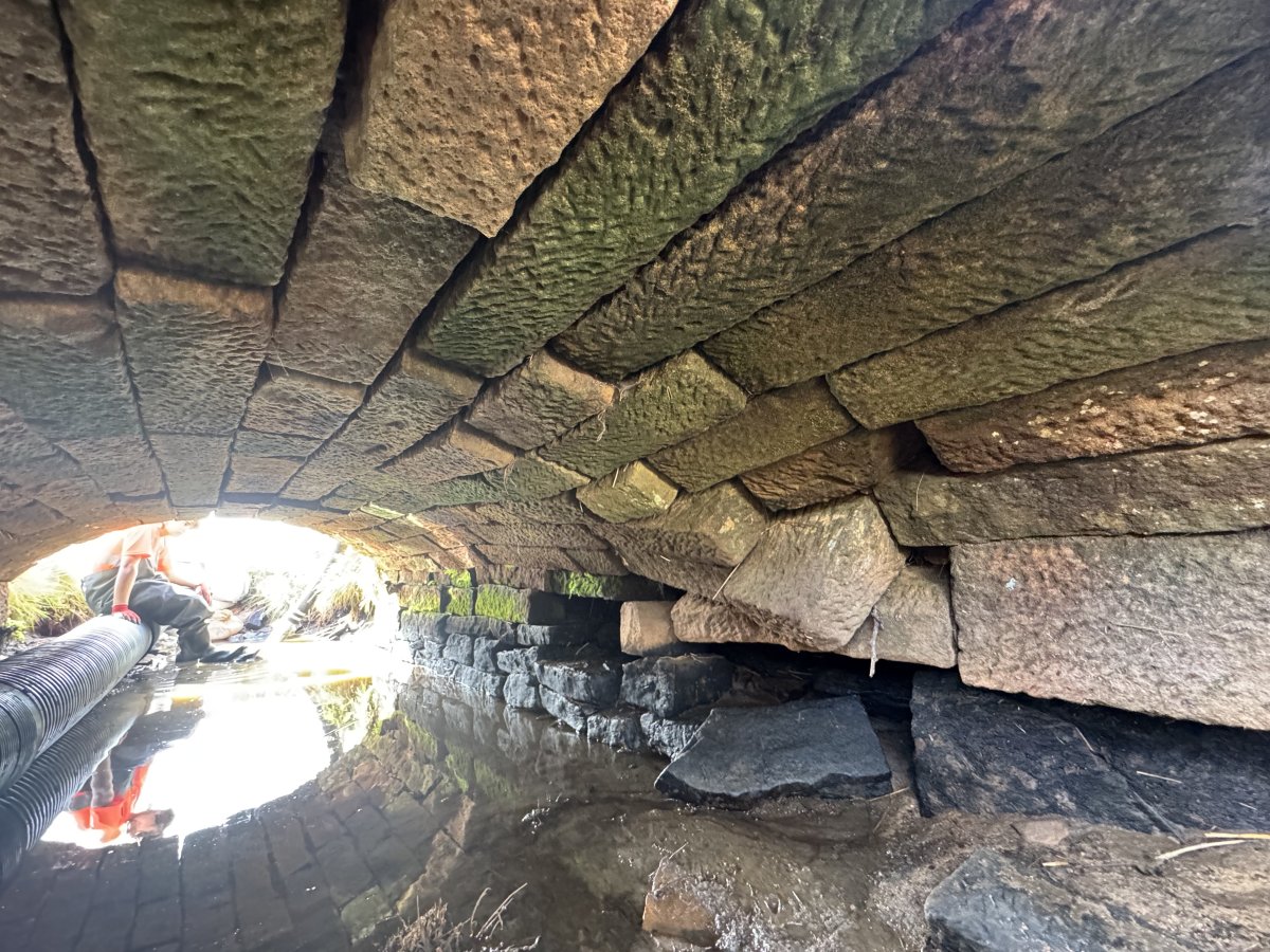

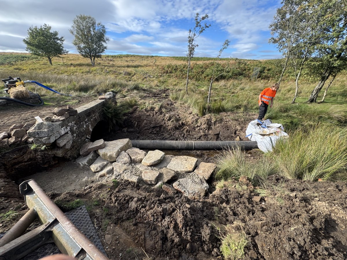

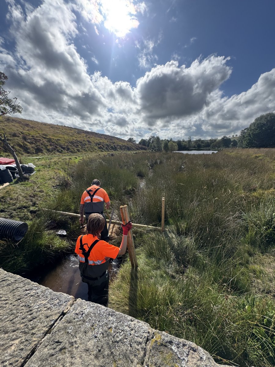

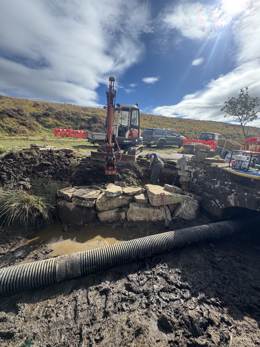

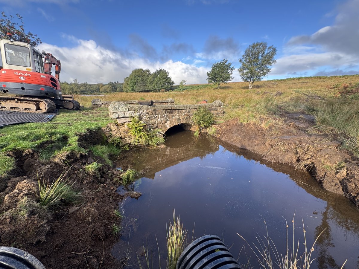

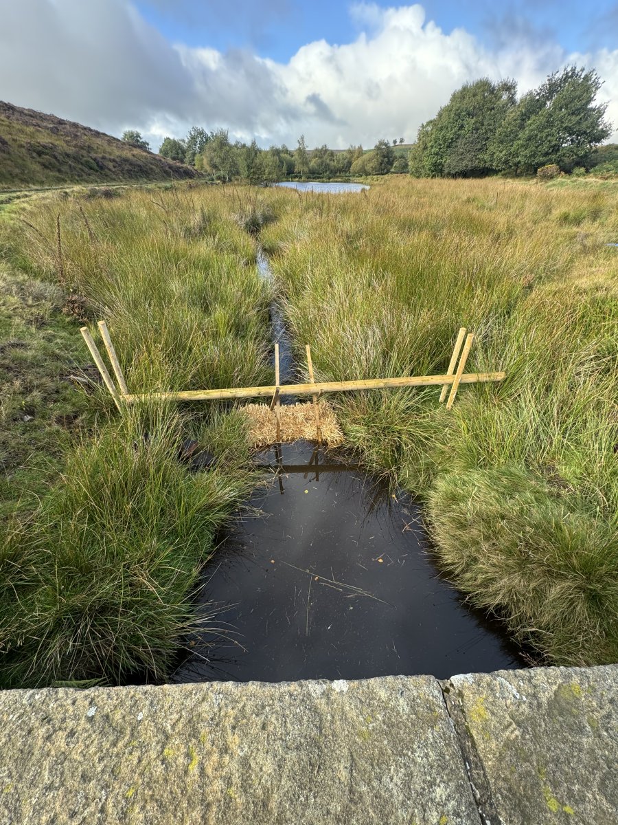

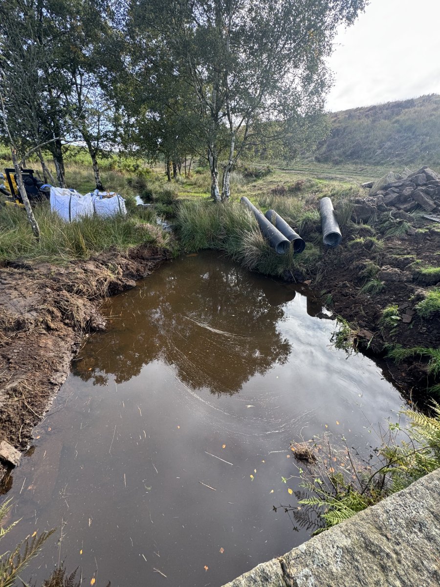

Up in the moors attempting to fix this bridge, getting access to it has been half the job, big 4” pump is awesome. Everything is fetch in on trailer as no access for anything big, few mile long track in from ranger base.
Bridge is on an old reservoir and the level is at reservoir level so had to dam it both sides culvert it with 300 twinwall and pump it to work under bridge. Then it’s waders and on knees as no room under there

How the feck do you price that?
Experience and
Hopefully correctly lol but has taken a few days longer to dam it than I thought but hopefully repair goes quicker
Helps having all the kit in house and a head for problem solving
Approx £18k for this bridge with £4k of that being temp dam and bypass but had all twin wall and new bulk bags in yard from other river projects

How will you repair that collapsed stonework? Looks a nightmare!
What has caused it to fail - massive flow, overloading, or a bit of both?

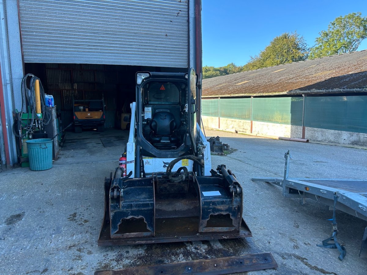

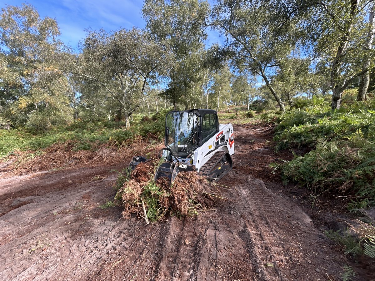

Got the grab onto the T450 and cut the blade bolts off- lets see how she does stripping bracken litter. In theory is the perfect thing.
Checked the oil levels and topped up the hydraulic. I'm always amazed at how tiny the tank is on this- I guess it's not like a digger where rams can be in all kinds of positions requiring a wide range of levels. And the cooling pack is chunky with a hydraulic fan. But still- only around ten litres plastic tank on a 65hp entirely hydraulic machine!
I'd guess looking at that the foundation stones have either sunk/undermined and as soon as that happend the locking effect of the keystone arrangement above failed. Not an easy repair for sure.

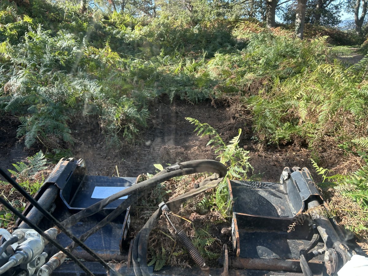

Checked the oil levels and topped up the hydraulic. I'm always amazed at how tiny the tank is on this- I guess it's not like a digger where rams can be in all kinds of positions requiring a wide range of levels. And the cooling pack is chunky with a hydraulic fan. But still- only around ten litres plastic tank on a 65hp entirely hydraulic machine!View attachment 85078
Seems like your getting plenty of use out of the T450👍

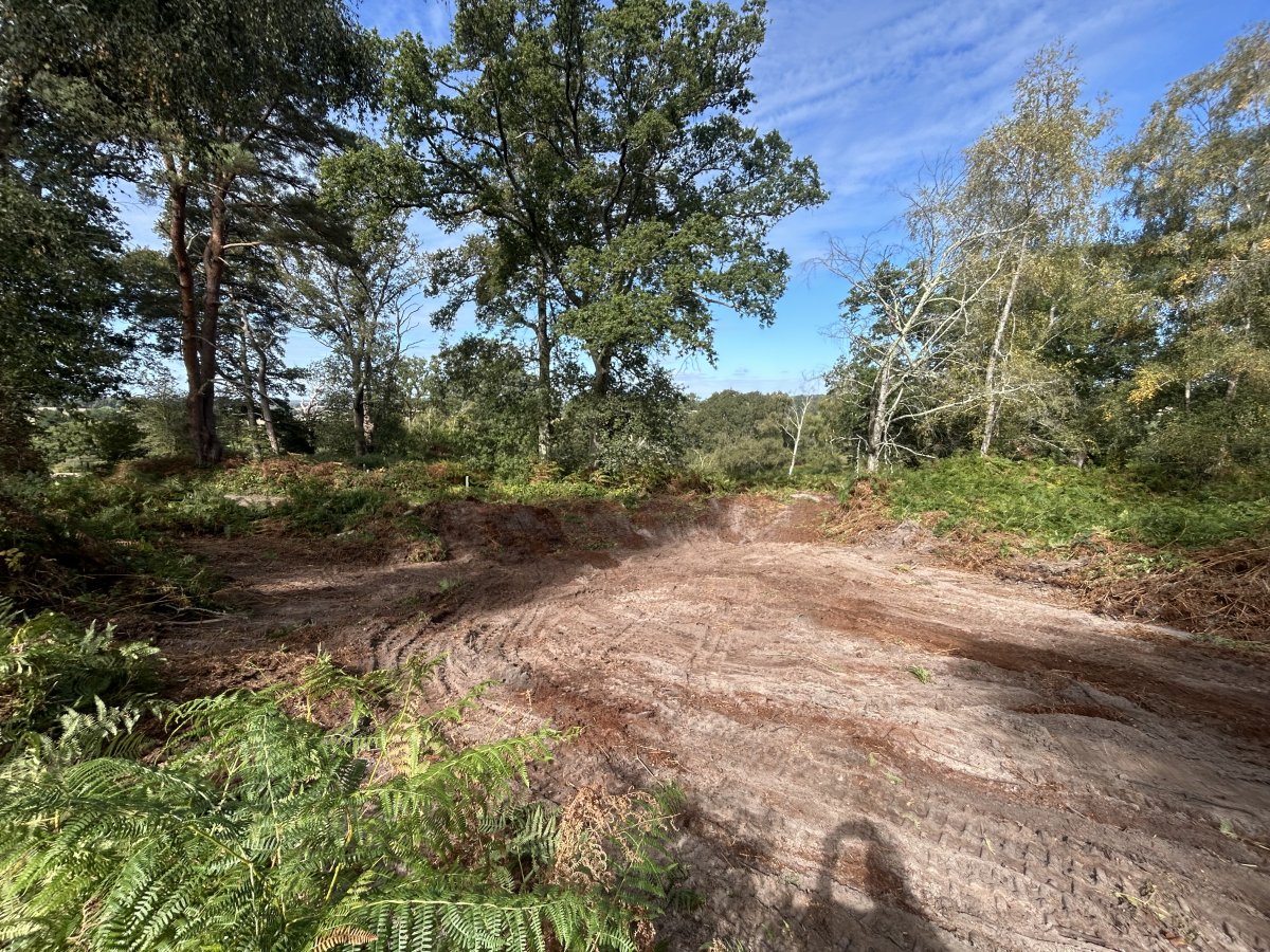

I’ve got around 120 hours under my belt now.
This grab is lovely. Makes this so easy. A touch ‘front heavy’ which could be rectified with rear counterweights- although I’ve shied away from them so far as it’s always felt too ‘rear heavy’. This extra front weight makes it easier to do things like climb the bund, and it’s doing an absoloutely lovely job of forming that at the same time.
However, I have forced myself to dial the revs back to 3/4 as ten litres an hour consumption was making me wince.
It’s a much better way of doing this than two blokes with a dumper and 8 tonner. Bund is formed at the same time and the area is left much more level than you can get it with a 360 too.
