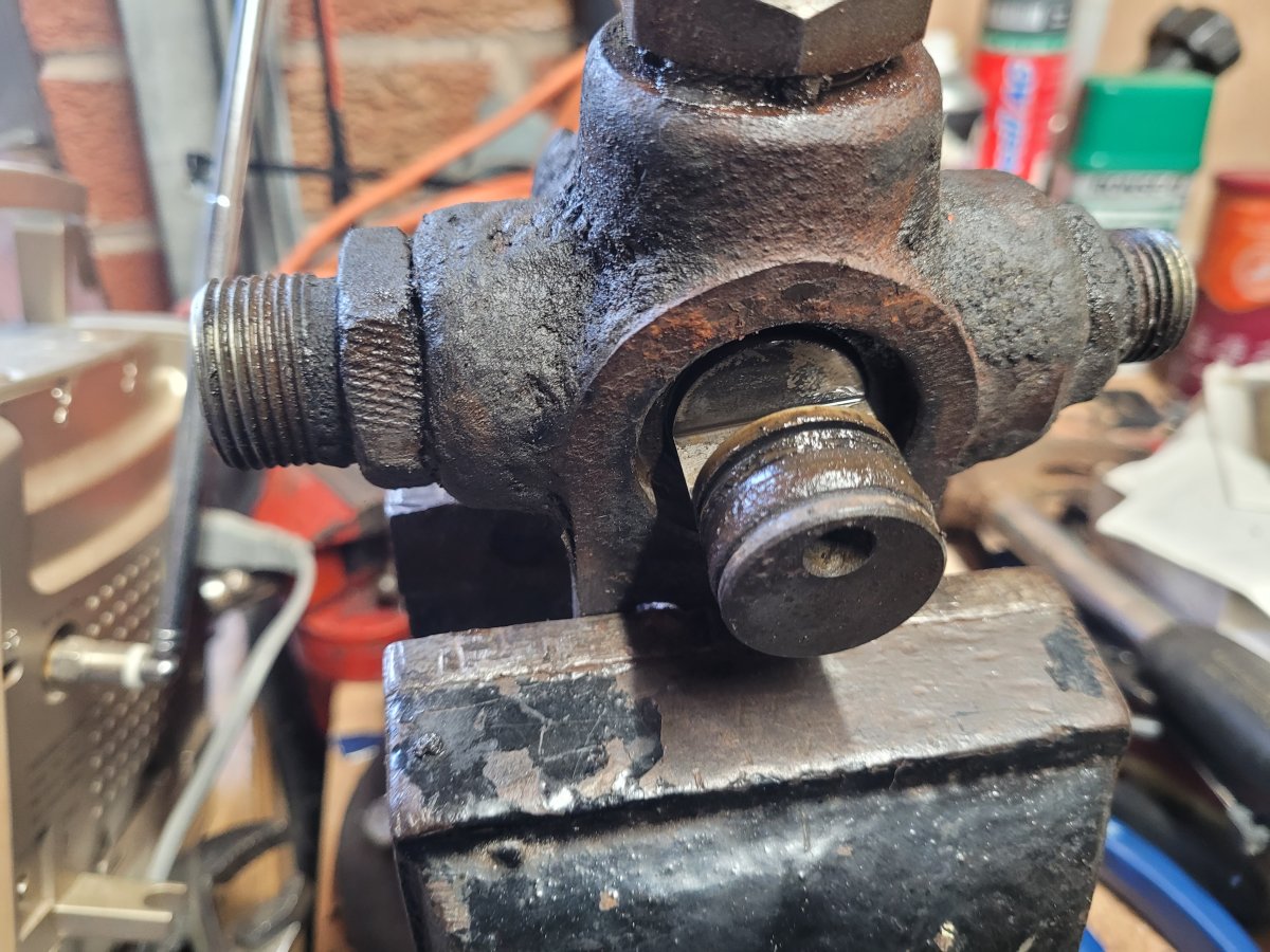

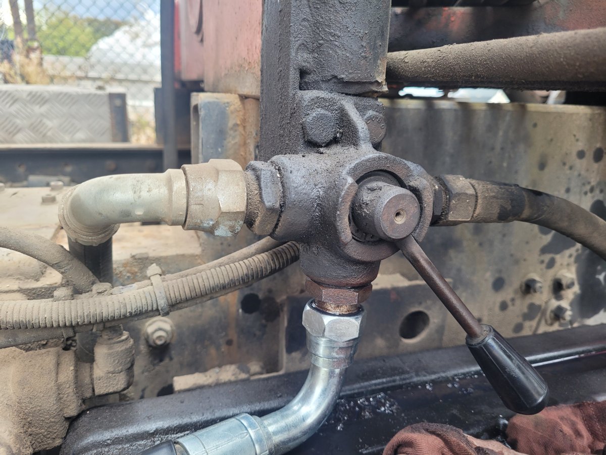

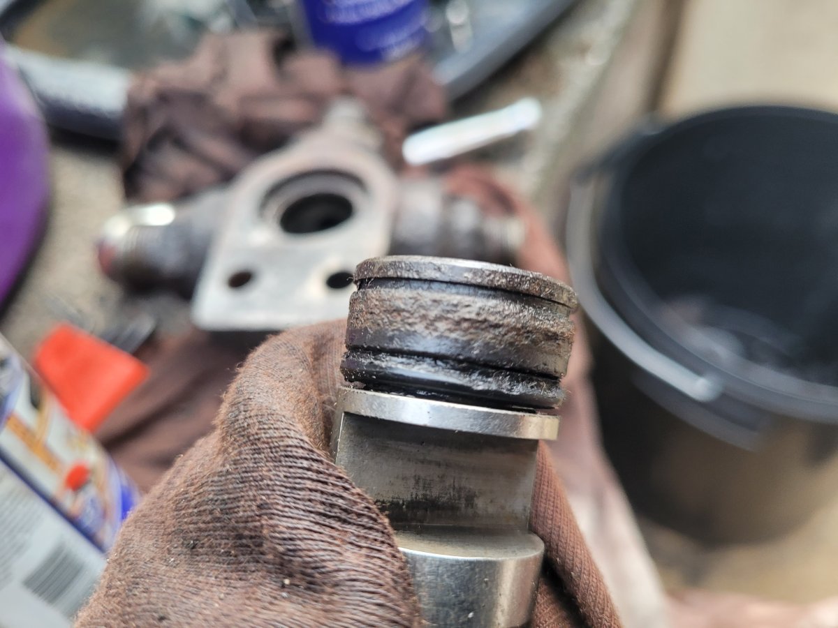

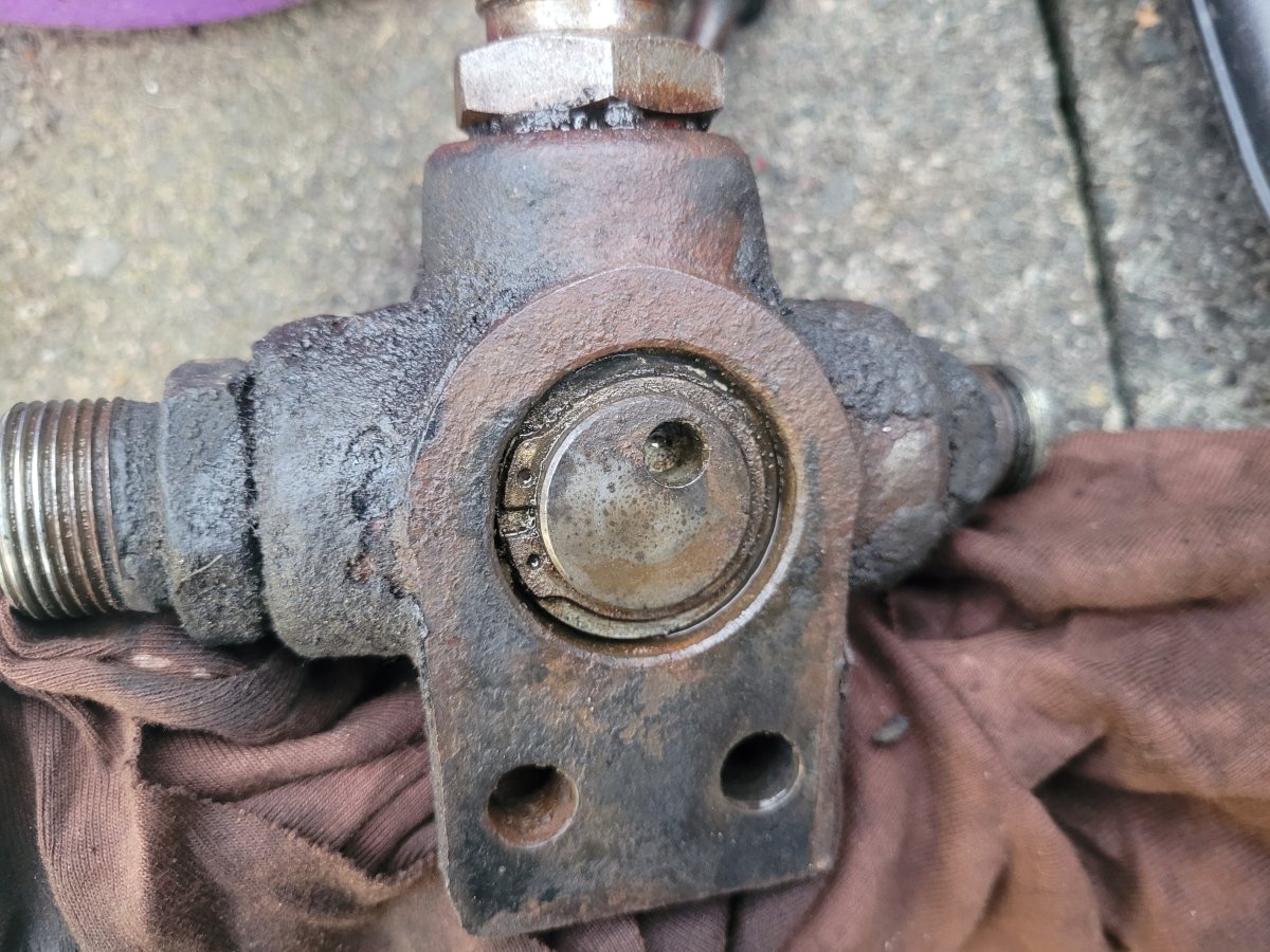

Yesterday evenings job was sorting the diverter vavle on the grab.
New ones are £200 so I thought sod that it can only be an o ring that's gone. Took it all to bits and yep the rear on had gone. Tidied up, cleaned up, new o rings and so far under test it's back to been oil tight.

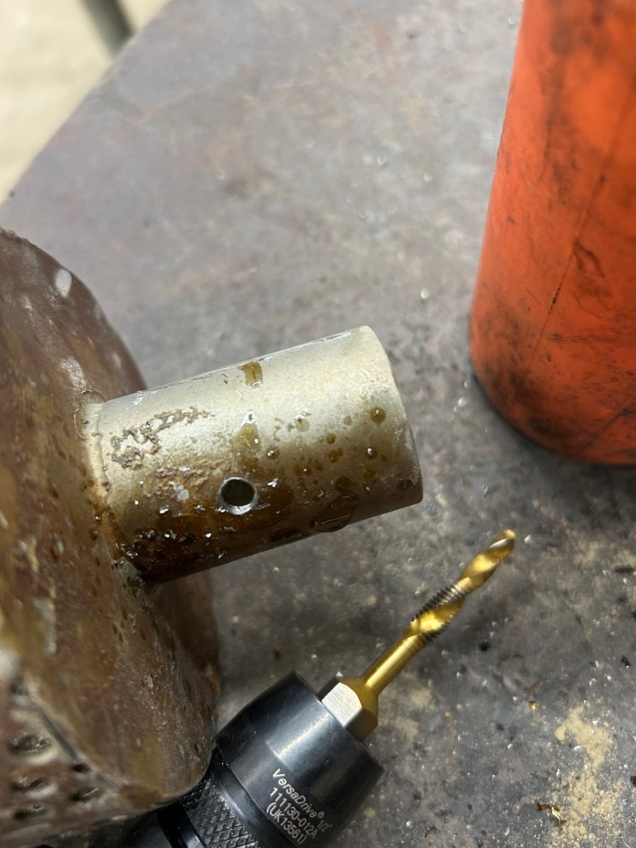

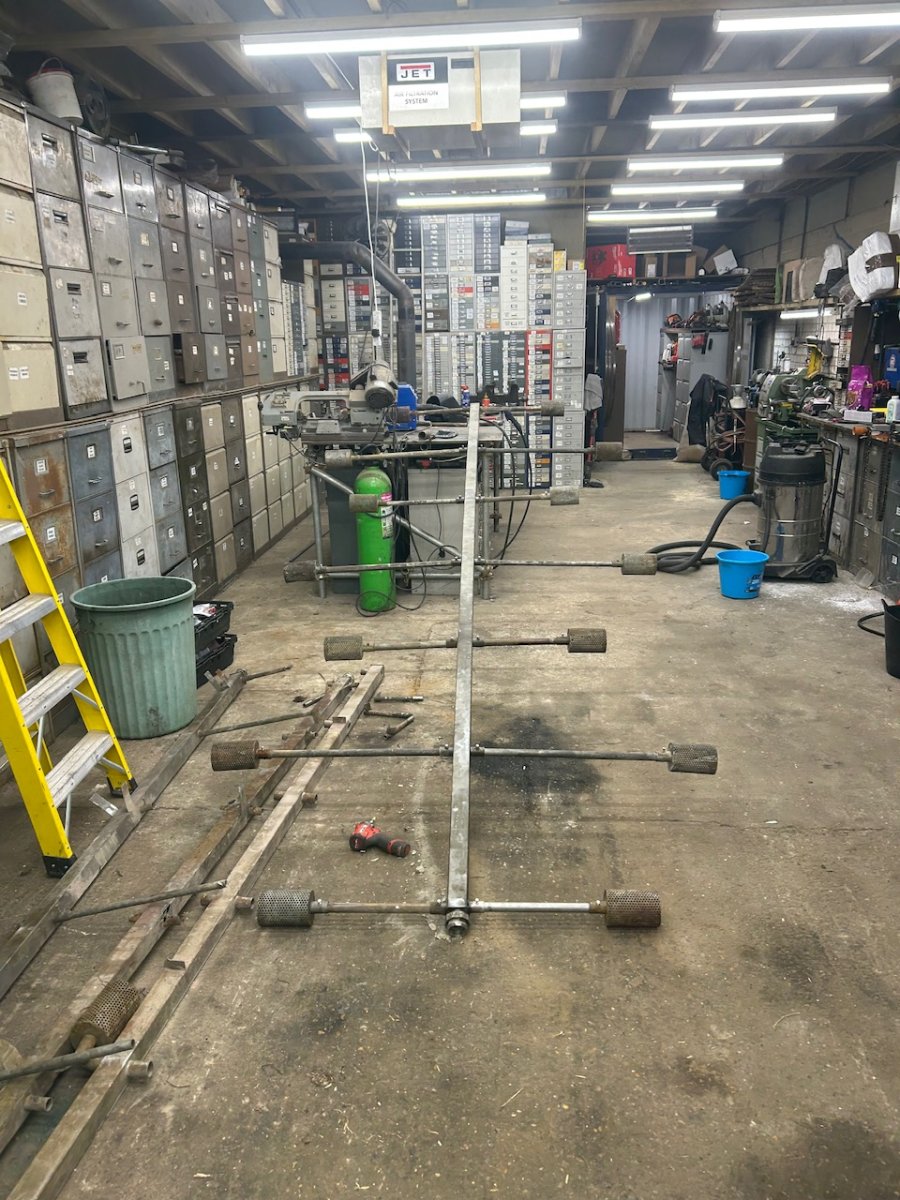

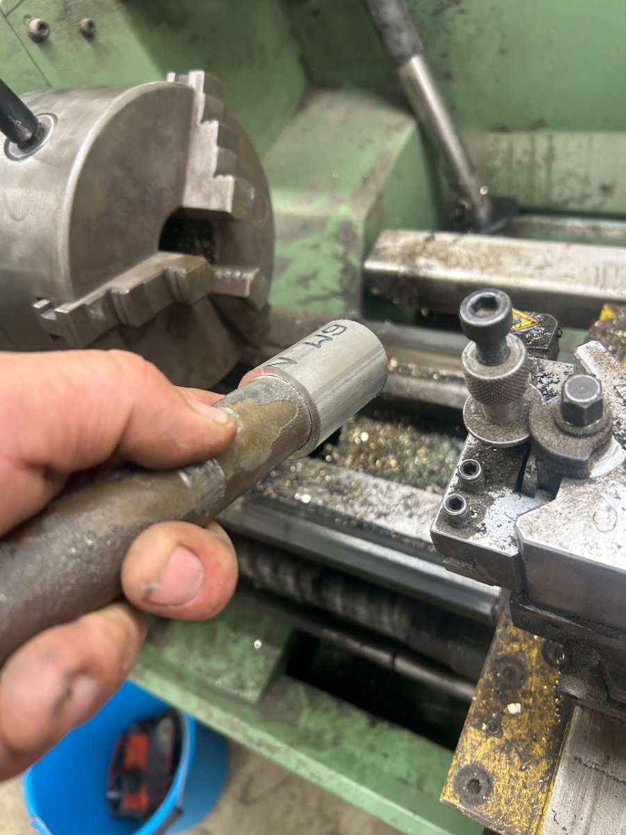

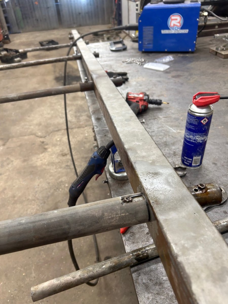

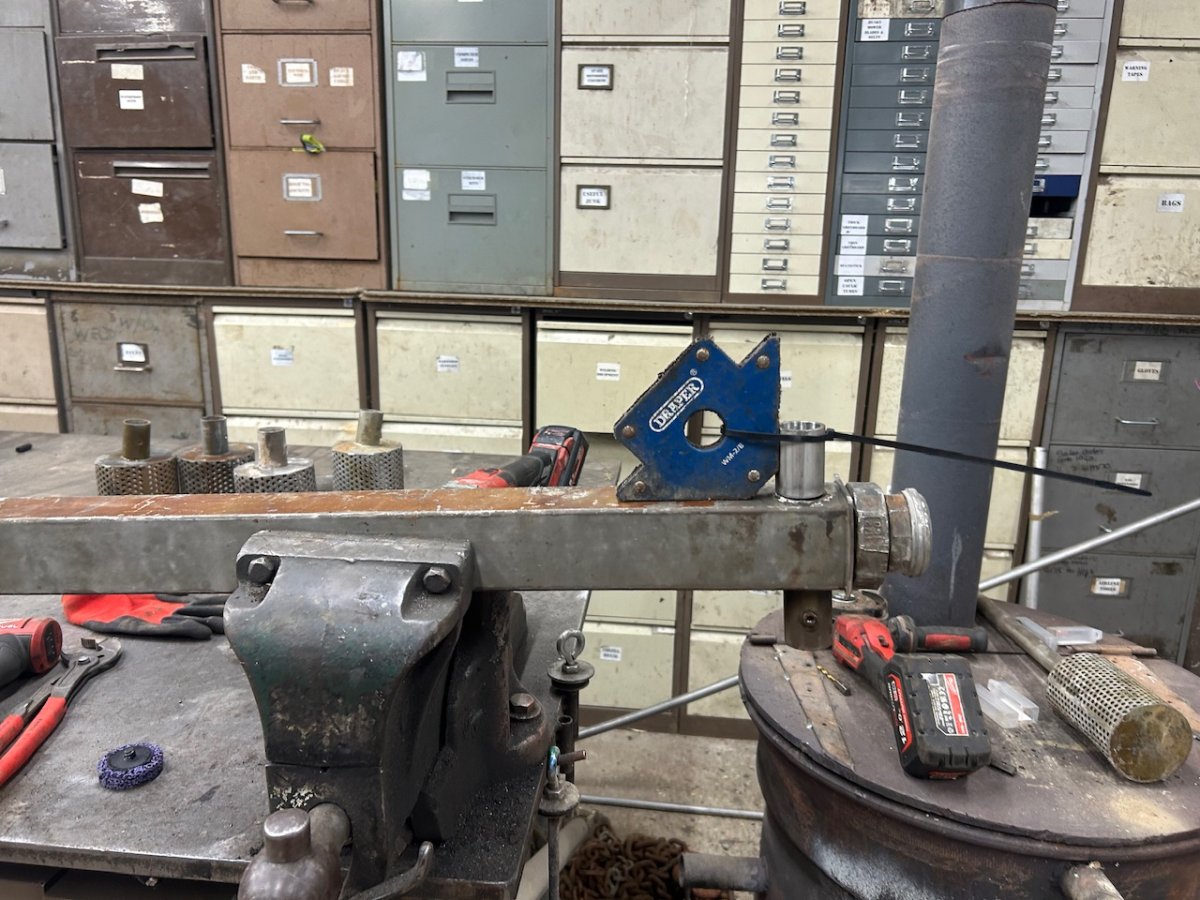

Busy today welding up the filter system for the waterjet. No idea what the stainless pipe was, couldn’t match it anywhere. Imperial pipe stock was close enough.
Tried out a new impact tap from HMS. Handy for repetitive work. Their drill bit was a disappointment though, lasted less in 316 than a decent cobalt bit
Tried out a new impact tap from HMS. Handy for repetitive work. Their drill bit was a disappointment though, lasted less in 316 than a decent cobalt bit View attachment 84384View attachment 84385View attachment 84386View attachment 84387View attachment 84388

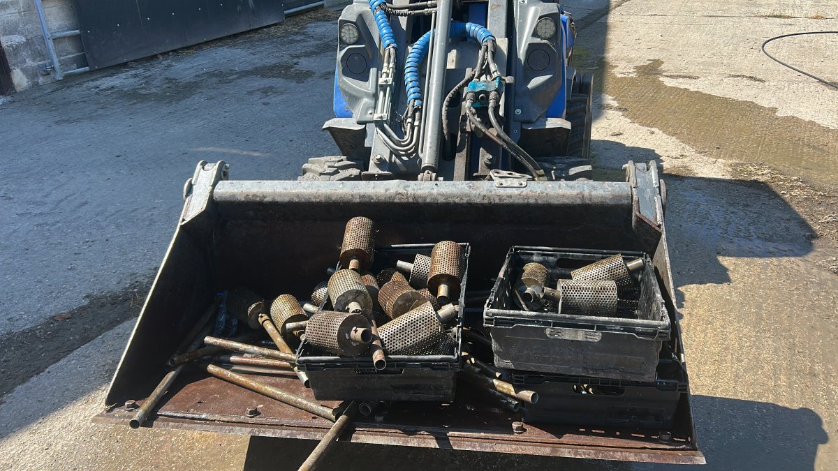

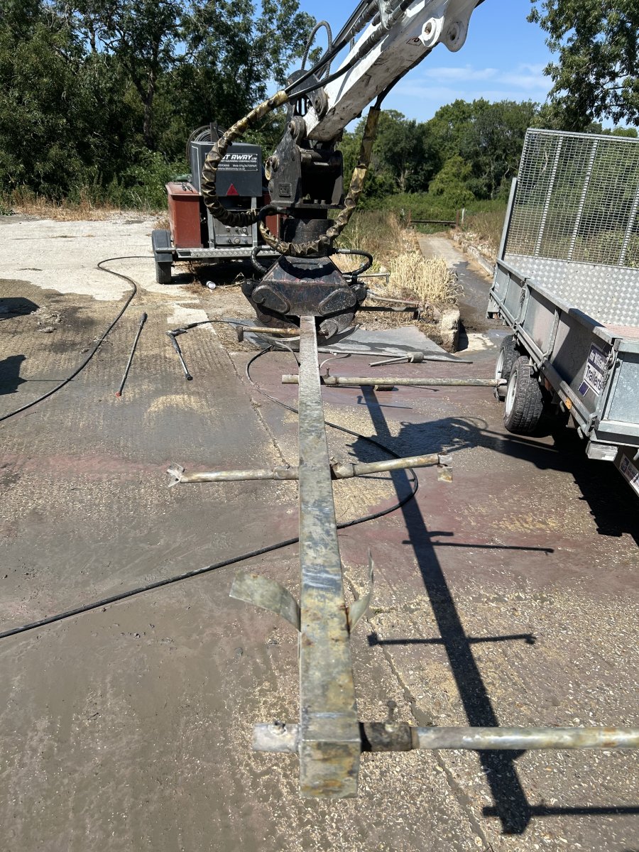

Yes it’s mental. They have a whole welding shop with two blokes full time, but they are too busy and the welding gear ‘ isn’t portable.’ I even had to take my welder over last year when they thought they had a leak on the smaller waterjet. Turned out the night shift had been cleaning and the water on the floor was residue from that 🤦‍♂️
I also have to pressure wash it through which is not a small job- needs a special long lance I made up. I think they just like a turnkey solution especially as the maintenance window is usually very tight. It’s a good yearly job, I quite like the technical stuff. They’d certainly not find another firm to offer the works like i do- they got very lucky to find me when they were ringing around for a ‘digger and driver’
I also have to pressure wash it through which is not a small job- needs a special long lance I made up. I think they just like a turnkey solution especially as the maintenance window is usually very tight. It’s a good yearly job, I quite like the technical stuff. They’d certainly not find another firm to offer the works like i do- they got very lucky to find me when they were ringing around for a ‘digger and driver’ View attachment 84389View attachment 84390
Can’t be that expensive to remake the filter system, so drain/dig-out/strip/reinstall the ‘new’ filter/refill/GO!
Rebuild the old system ready for next time at your leisure.
They just allow an extra day in shutdown time and money to clean and repair. The cleaning is the most important job, and they like that done off site.
They also allow two days for digging out, and with the tilty this time we were done in five hours. The bottleneck is their utterly useless forklift drivers.
