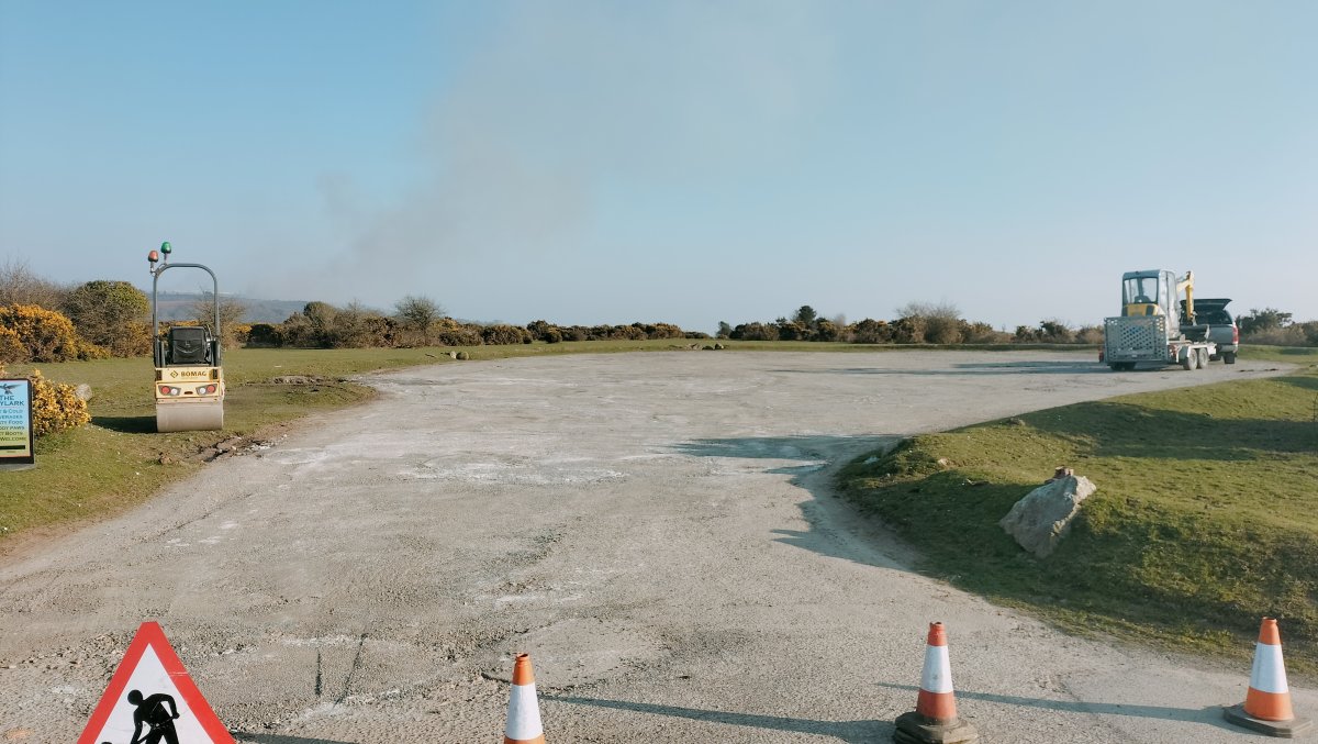

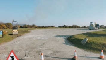

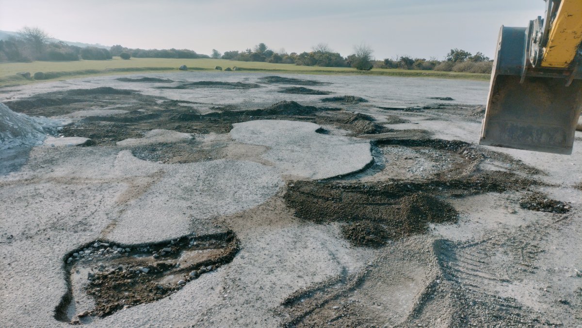

Had a bit of a view today
Been on car parks all week. The first photo is a train wreck of a car park! Sank up to the tops of your wellies in places- that took some stone to build up the levels again.
The second one was today's job- whole lot wants ripping up and starting again as it's a patch work of damaged tarmac and stone but budget is limited for now so just dug out the holes, put in some larger slate crusher and then blinded with the original 803/tarmac chippings.
