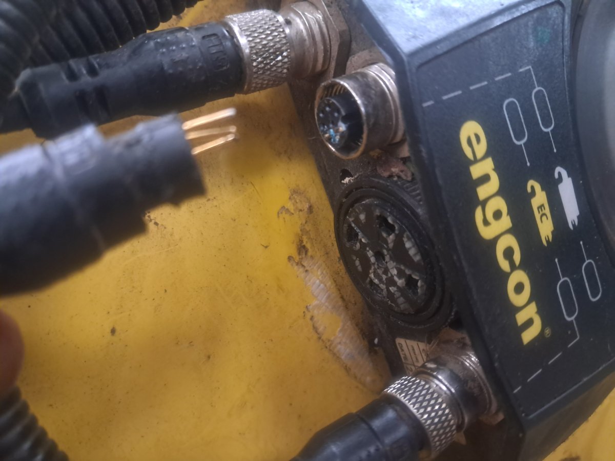

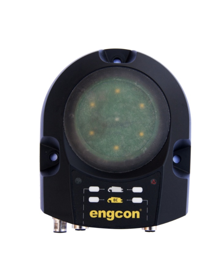

Is it the same type of plug on the other end?Managed to pull this wire of the engcon today.... branch got it.View attachment 79515
It must be top hitch as everything else still works and thats where it heads into, seems to be a pita to get into the top hitch ...wonder how big of a job it is soldering a new connector on here instead of replacing the lot(i can see what went where)
cant get to it .... by the looks of it I need to drop tilty offIs it the same type of plug on the other end?
Might not be that expensive
So my top hitch just uses the standard machine quickhitch pipes, is yours all controlled via the hammer lines?Managed to pull this wire of the engcon today.... branch got it.View attachment 79515
The biggest problem is Engcon has completely forgotten how to communicate, they stock nothing and seem incapable of getting even a simple price back, I never thought I’d see the day that you were quicker at dispatching an item and literally 3 months quicker with a price!!! Mind blown!!Is it the same type of plug on the other end?
No its controlled of the machines lines - It is part of this qsafe thingSo my top hitch just uses the standard machine quickhitch pipes, is yours all controlled via the hammer lines?
I don’t know, but I can tell you I have no such problems with a six pipe systemNo its controlled of the machines lines - It is part of this qsafe thing
still bleeps and flashes when the bottom hitch bucket isnt locked in, maybe it wont stop the top hitch working and its just a warning, havent tried it yet .....tbh I need to revisit the thing to see whats what, ive forgotten it all in the last few years![]()
Top hitch sensor same as bottom to tell when bucket secure etc, hitch will still workNo its controlled of the machines lines - It is part of this qsafe thing
mines 6p system - but it has this safety system that they have to have apparently.I don’t know, but I can tell you I have no such problems with a six pipe system![]()
ah ok - like i say i havent really stopped to investigate too much , just cable tied it out of the way, no rush thenTop hitch sensor same as bottom to tell when bucket secure etc, hitch will still work

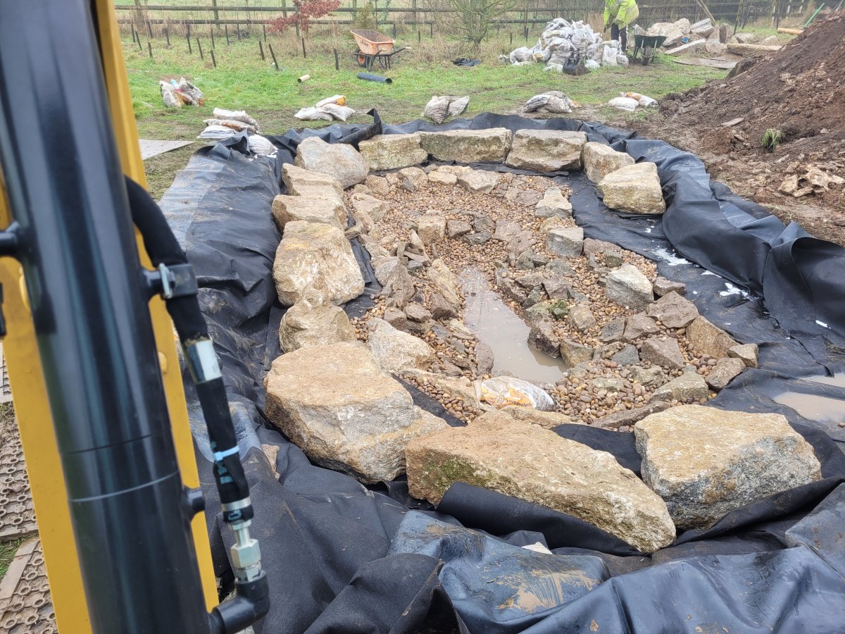

Grab looks good on there. What sort of money was that if you don’t mind me askingRocks, rocks and rocks.
Impressed with the little jb grab and suits the 301.8 perfectly.
View attachment 79512View attachment 79513View attachment 79514
It wasn't outlandish at all....around £1200. I also got solid sides that you can bolt on to make it into a muck/soil grab too.Grab looks good on there. What sort of money was that if you don’t mind me asking
That’s very reasonable. Was that delivered incorrectly vat? Can you recommend it?It wasn't outlandish at all....around £1200. I also got solid sides that you can bolt on to make it into a muck/soil grab too.
It was plus vat. Delivery again wasn't alot.That’s very reasonable. Was that delivered incorrectly vat? Can you recommend it?
