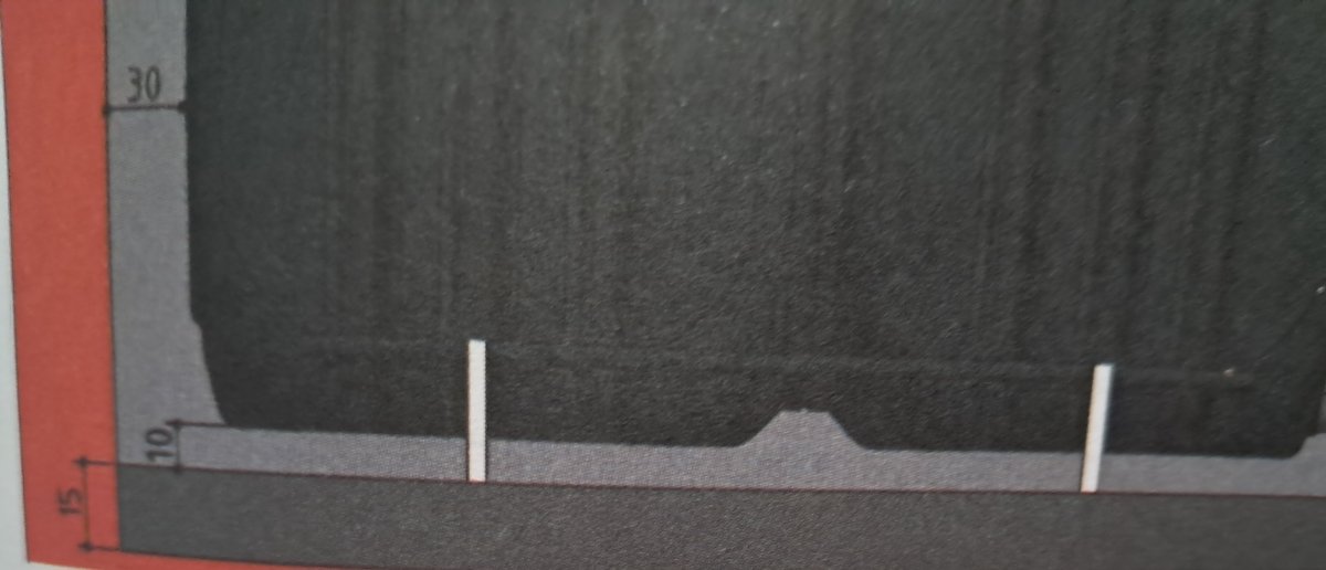

This treatment plant is to strap to a slab/steel conc on monday - its first of this type, high water table apparantly, installation guide says straps go round this pipe along bottom, not going to be masses of room down there and challenging to get tension on them..... any ideas 💡
Can you put the base in 1st with the cradles in the base?
Usually we put 15cm of conc with steel mesh in bottom with rebar running under mesh, with straps hooked onto bar through base, other systems have had anchor kit straps designed to go up over top so its drop tank in and strap over top.
This is supposed to strap as per diagram.....
Put the 15cm base in first. Place tank into hole and concrete around it. The pipe looks like it is bonded to the tank. Once surrounded in concrete it is not lifting. I guess you fill tank as you completley concrete it in!!!
Second compartment is a filter - so apart from a bit of gubbins its empty, thats why the guidelines are strapped to slab, like I say we've done lots but strap over top, the design of this system doesn't really favour straps over top and they expect strapped as per diagram, reality is it will be tough to tension, needs a pretty large overdig to get at them and them large amounts of backfill 🤷‍♂️
No doubt suss a way but wondered if I was missing something :)
It's not unusual for these filters to bob up if not properly installed, not happened to us as yet but got to be careful.
