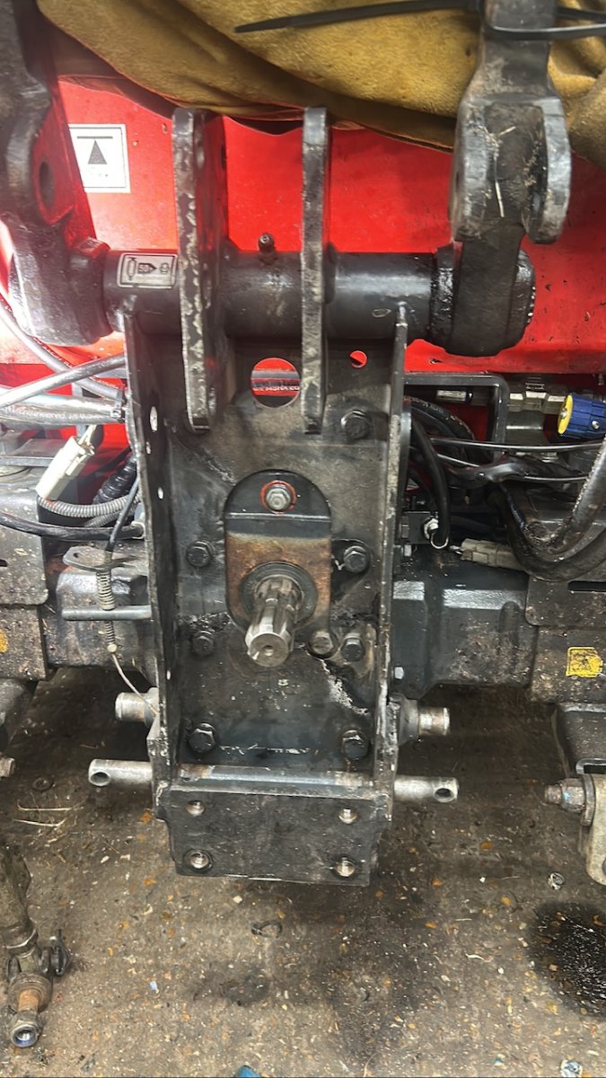

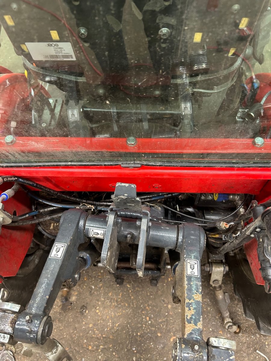

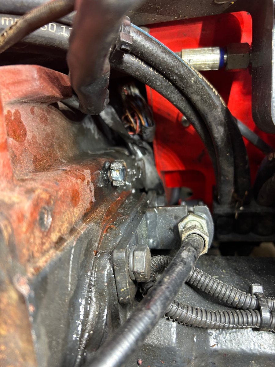

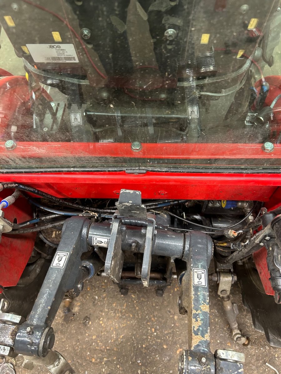

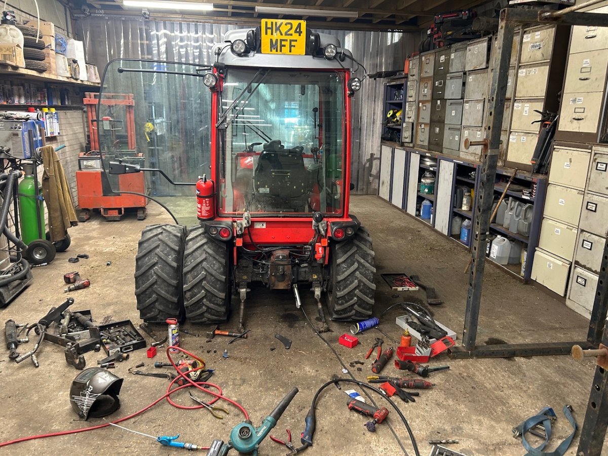

workshop SundayFor fucks sake. Went to fit the dual wheels for the tractor, got one side on, stood back and then thought ‘that linkage don’t look right!’
No idea how it happened, the driver must have smacked something sideways. Odd because it’s pulled sideways from the top link. Must have been when a link arm snapped the other day.
Took it off, managed to press it about enough that the bolts into the casting would pull it in perfect. Got it welded and will tidy it up and faff around re attaching it tomorrow.
The snapped studs were a bitch- couldn’t get the welder square on to the back one. Cut a nut open so I could see what I was doing and tenth time was the charm.
So much for going out earning money with it tomorrowreally needs some 10.9 bolts to replace the ones that snapped. View attachment 74732View attachment 74733View attachment 74734View attachment 74735View attachment 74736View attachment 74737
