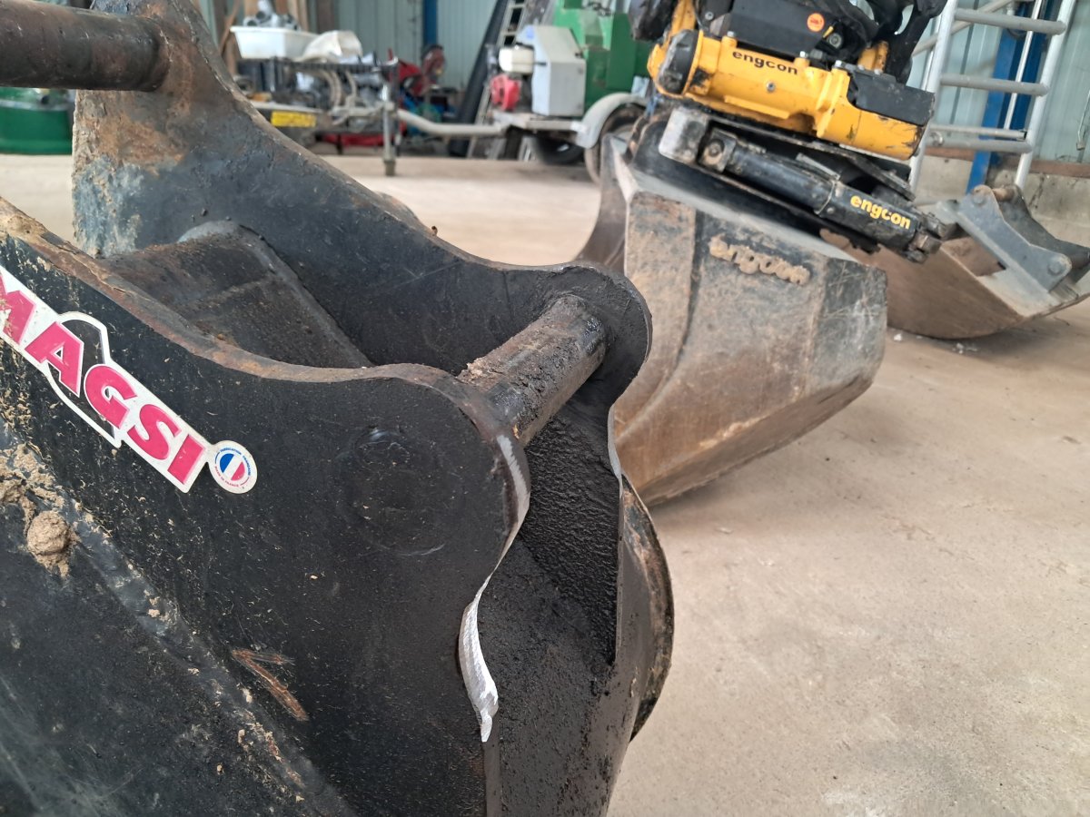

Had an intermittent leak from engcon gripper - seemed like no rhyme or reason to it, occasionally oil down back of buckets, changed little blue seals in detachable gripper face but didn't seem to help, took numpty here a long while to spot witness marks on back of a 600mm digging bucket, seems the ears foul the back of the gripper module and make it sit not quite so happily with its coupling when bucet drawn into hitch, so when using gripper with that particular bucket it weeps from coupling.
When I ordered the engon, they were hell bent on supplying me that these other buckets were just as good, thankfully I insisted on a original grader from engon, a few on here said I should insist on full set, anyhow I agree πŸ‘ πŸ’― - buckets need to be made by someone who knows.
Anyhow bit of grinding till no witness marks and hopefully be dry from now on 🀞

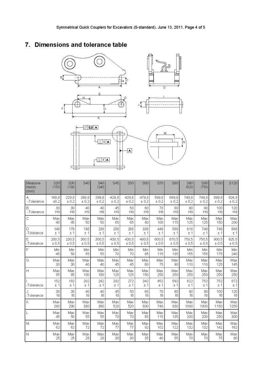

radius G is critical - as you now know
Hard to explain without photos ...the gripper needs extra space over hitch, obviously a detail that your av bucket company wouldn't have a clue about.
if the cheeks are made to that chart they will fit, with or without a gripper .. the ends of the cheeks must be vertical or undercut and be half the pin diameter or less
