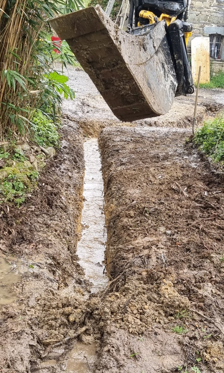

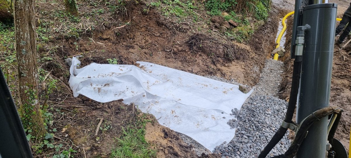

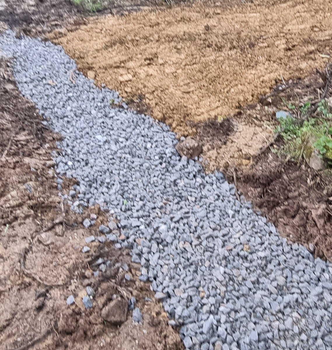

Can't help but think if the French are moaning it's wet then heaven help us!Tapping into a wet spot - big hole fill with rubble and a perfed pipe, nothing technical, more or less dry day and forecast shows dry for next week or 2 .....yipeeee

Oh Bretagne (brittany) in the nw is pretty much as wet as south of england, but the SE of france haven't had hardly any rain to speak of apparently....all a bit extreme.Can't help but think if the French are moaning it's wet then heaven help us!
