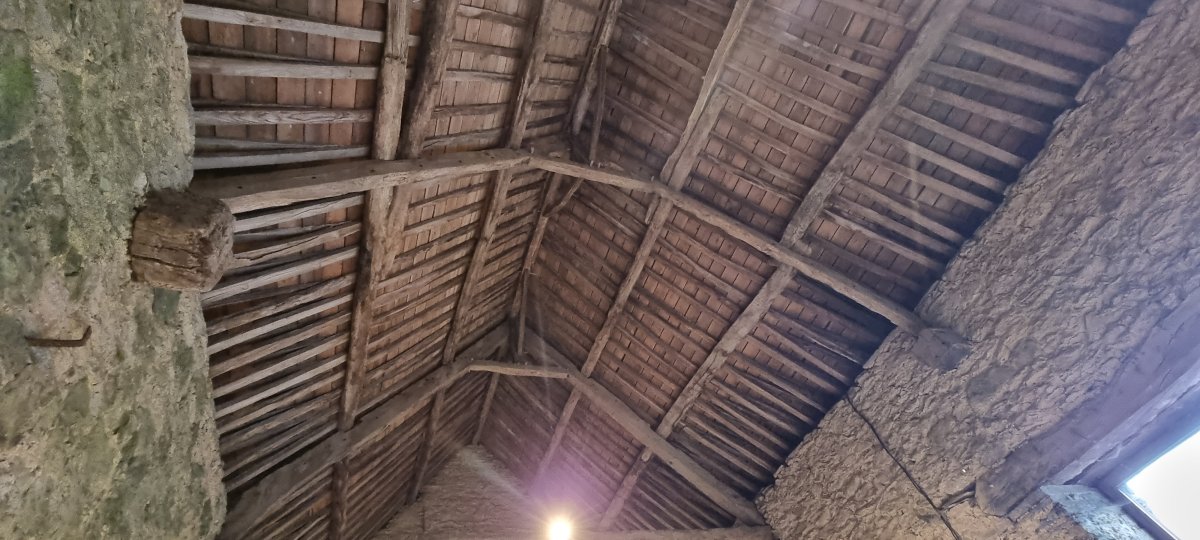

When we bought this place there was an old silo for grain - anyhow in their wisdom they cut the A frame to make room, been meaning to get it sorted, should I just brace it further up across frame or do something more elegant with some plates on whats left of the beam.
Whats peoples thoughts ?
Its about 5.7m span. Section must be 30cm.

Would think bracing at wall level would be ok could tie the cut pieces too it

replace and plate'd be my thoughts or cable it ....
or fit some shoes to what's left and weld a chord of some description between the shoes ... either a large-ish CHS, SHS - level or diamond orientation, or 3 or 4 lighter CHS and lattice it with some 10 or 12 mm round bar ... just need to stop the walls/truss foot from splaying out

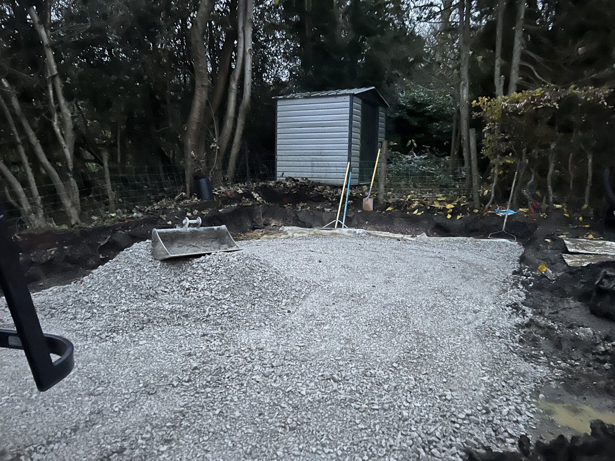

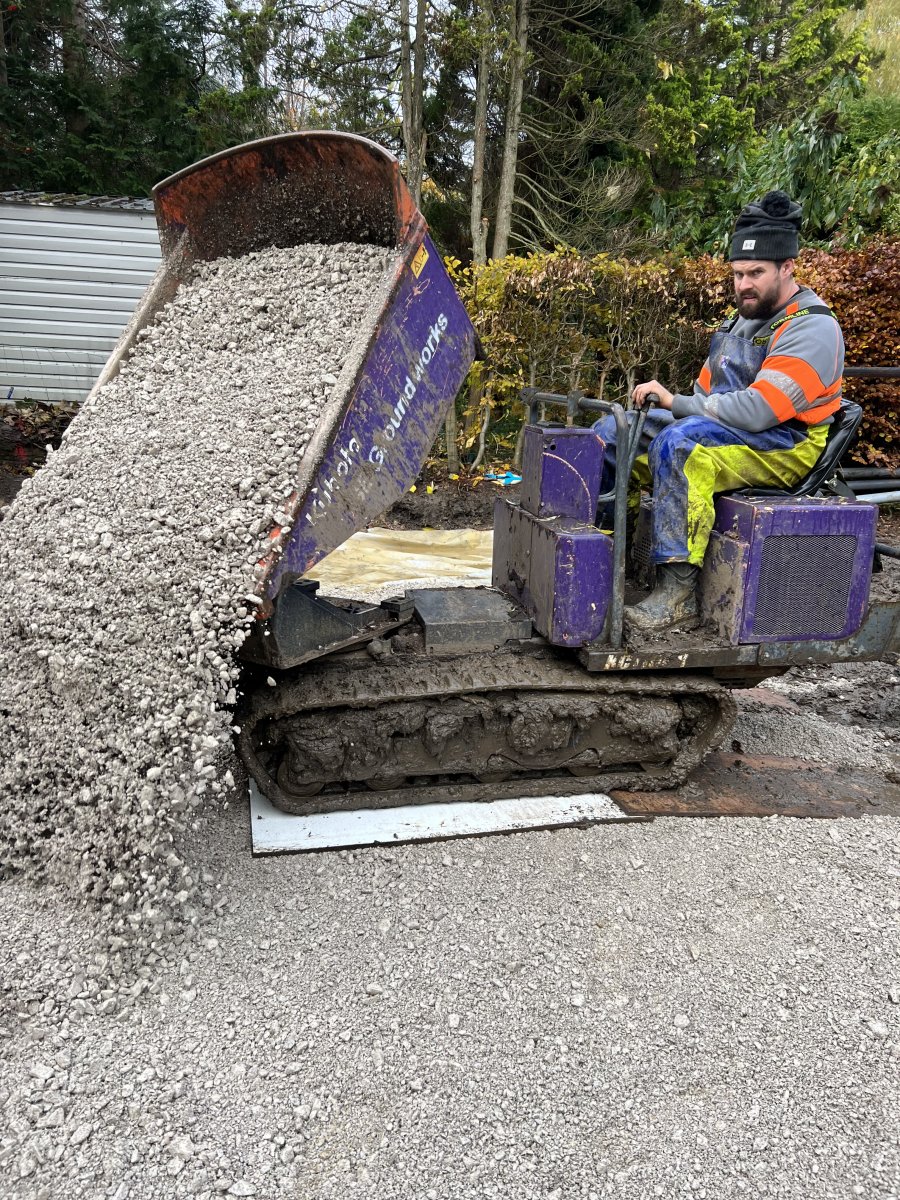

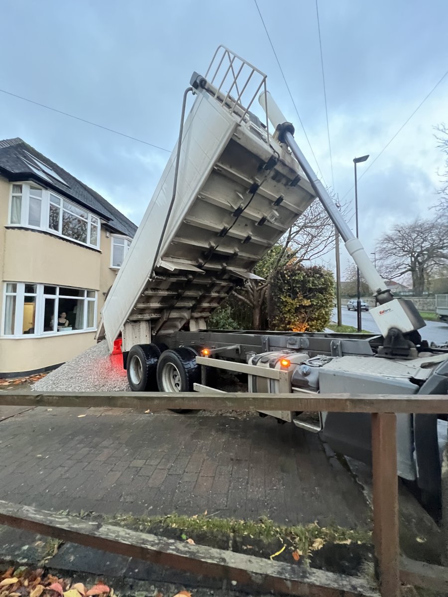

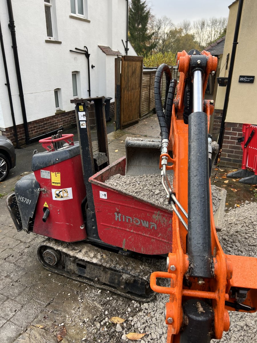

Getting head back round tight domestic jobs after few years with space on jobs
7am stone call to miss the traffic backing into tight drive threading tip through bt cables
Then moved 17 ton by lunch, 2 level hinowa’s fill 1 Kubota if anyone cares
