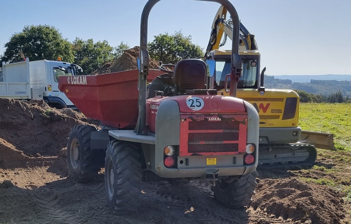

Disappointed with the 5t st dumper we hired to help get the topsoil run in, wanted a 6t st but they didnt have one .....anyhow this didnt hold enough on top of the 3t to warrant its xtra fuel.
But your comparing it to a TA3 aren't you? I've just bought one myself and seems the skip is quite a bit larger than normal 3 ton/thwaites. Going to make it very easy for me to overload it😆

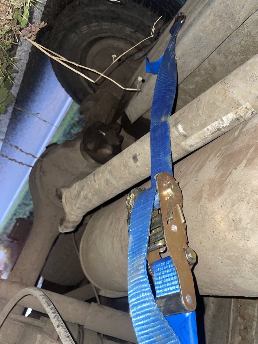

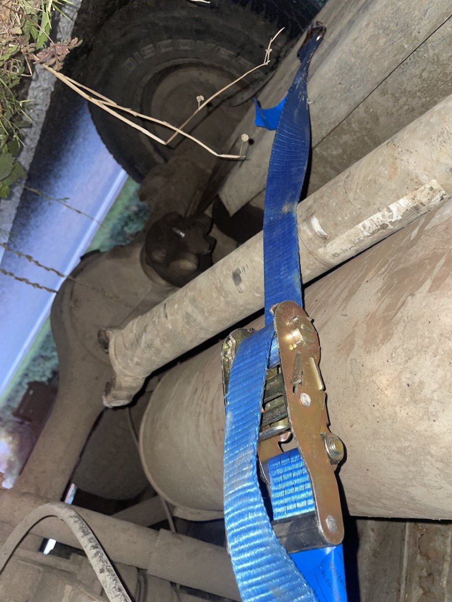

This afternoons job is the fix the truck prop after killing it towing a sweeper back. Luckily it didn’t let go until coming in to work today 🤣
Got this all up together. New carb and she’s running great. All greased, bits adjusted and various rubber mountings replaced. Now she’s ready to earn just as soon as I get the loler cert emailed over.
This afternoons job is the fix the truck prop after killing it towing a sweeper back. Luckily it didn’t let go until coming in to work today 🤣View attachment 52113View attachment 52114

assume you towed that in neutral, from where ever it let go? ... good job it was the back end that did and not the front -- could've been very exciting otherwise :oops::oops::rolleyes:
Nah, just ratchet strap holding the prop as you see and engage 4wd.

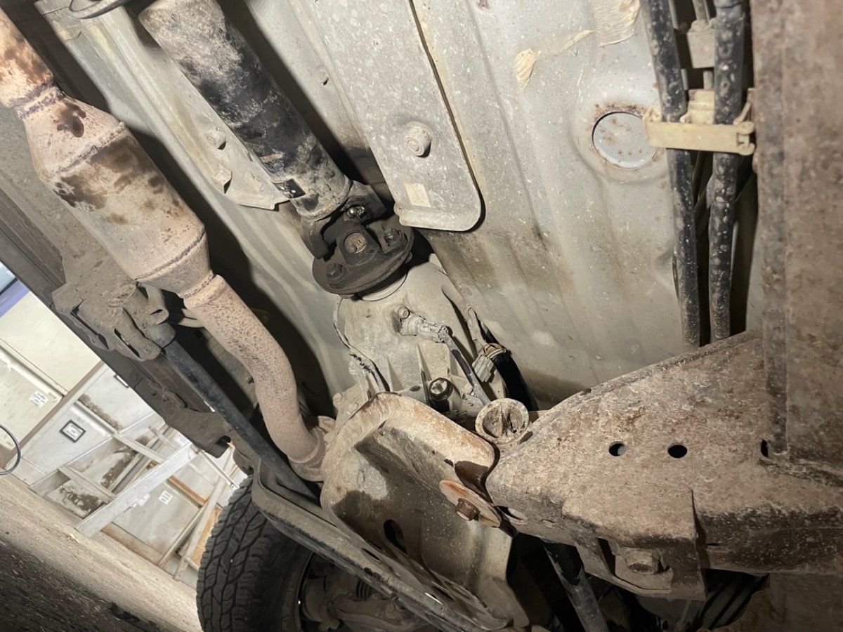

I've just been underneath and marvelled at how clean it all is. The only rot is under the tub liner at the front of the tub,

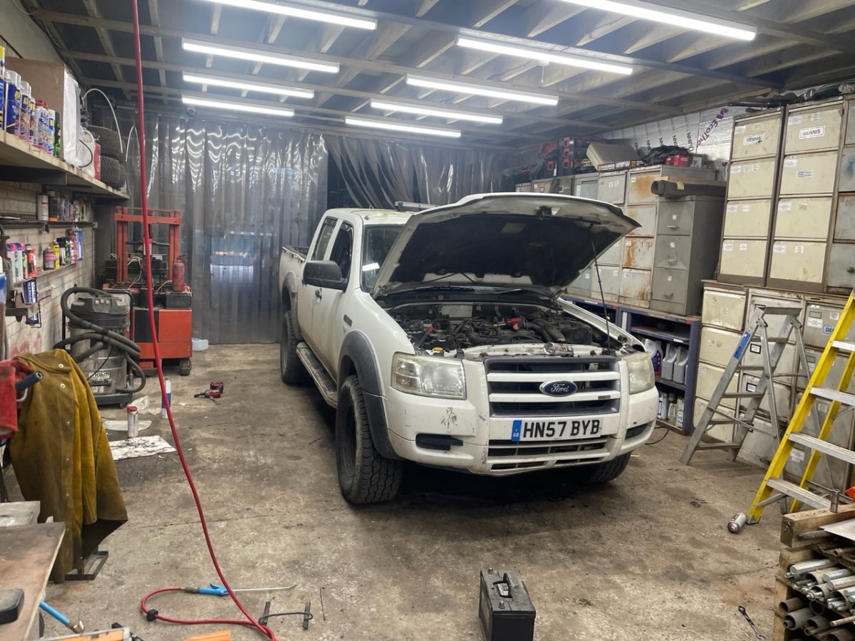

The truck isn't the issue- the lack of maintenance has been. I've let myself down here. As you might tell from the pics of all the machines I service on the nail- my standards have slipped for my main vehicle. Almost done. New prop UJ, oil and filter change, other UJ's greased :)rolleyes:), making up some Delrin spacers to stop the leaf spring rattle when the air bags are right up. Just a headlight bulb to go. Cambelt kit on order- it's been 40k since the last one (how the miles fly!)
I guarantee you I'd have more s**t with a new truck with DPF and Adblue and Lord knows what electric gubbins. Most importantly, if I bought a new truck, I couldn't afford things that actually do the work and bring in the money.

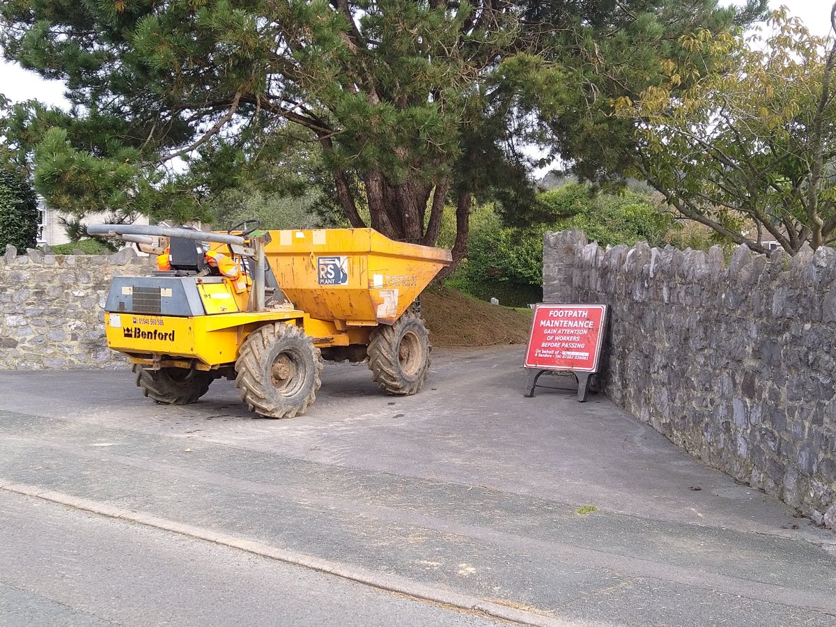

The Mecalac is of the good old Benford 3000 design. They are old school 3 tonners that will actually carry 3t.
Fyi they also did a 4t, which was basically a 3 tonner with bigger wheels and a 6" wider skip.....
Modern thwaites dumpers and JCB hold literally piss all because the sacrifice capacity for trailerablity...... That said a TA3 will fit on a 12' X 6' I for

Nice to see the dumper getting put to some work 👍

No, it’s the double cab. Just added some wind deflectors to hopefully quiet down the noise with the windows open. Poverty spec, no air con. It is clean underneath tho.
I like the ranger tipper for tipping off-road or taking a load of implements and a machine off-road but not really anything else. So cumbersome with the wide body, lack of visibility and it’s on mud tyres. It was £10k with 50k on the clock and very clean, it’s a truck for the next ten years minimum. There was a nice blue 2008 ranger tipper up for sale (£3500) with 76k on the clock recently, but apparently the sills needed welding so the rest might not have been far behind.

No undersealing?
T
topkit
If its clean on the underside give it a good pressure clean wire brush the surface rust and the get some Dinitrol ML and spray it everywhere the let it dry off a bit and then spray the chassis and floors with Dinitrol 4941, It really keeps everything in good order. I do all of my classics and I did my old P38 Range Rover it kept it like new wish I had not sold it now!
