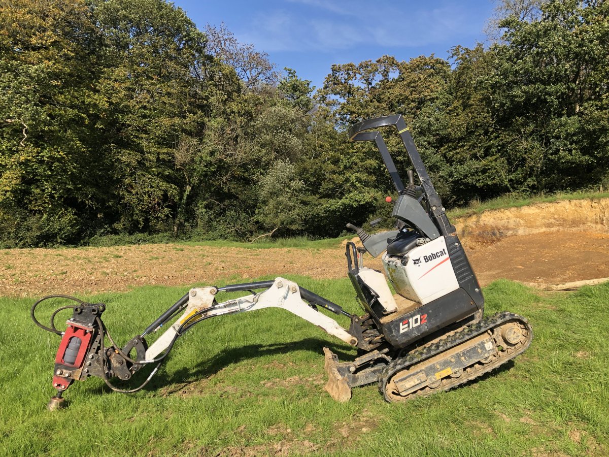

The fabricated post knocker adaptor on the Rammer 111 seems to work okay on 4” posts in moats spots. Still need a bigger digger though. Premium bonds didn’t come up last week so I’m going to have to struggle on. Might explore the options of a home made counterweight ..

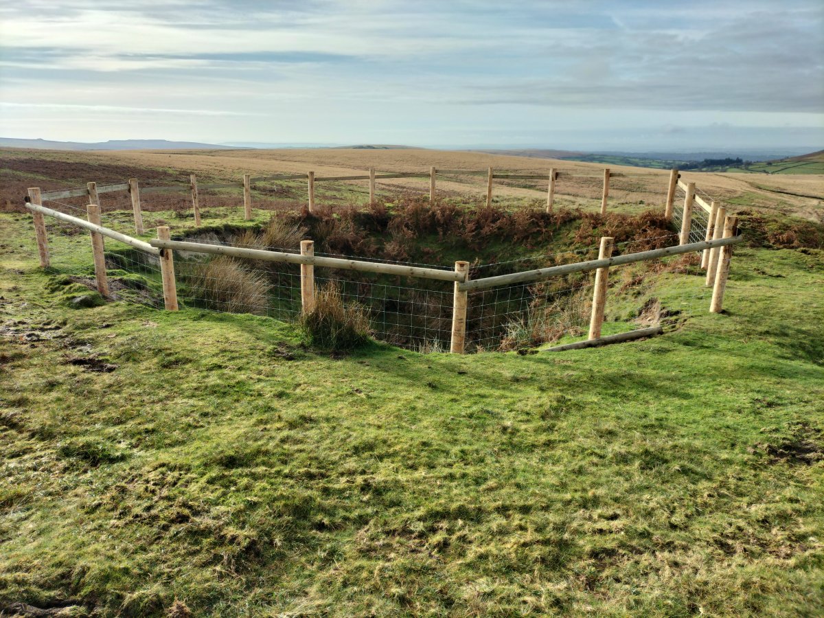

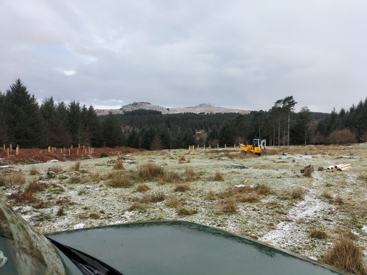

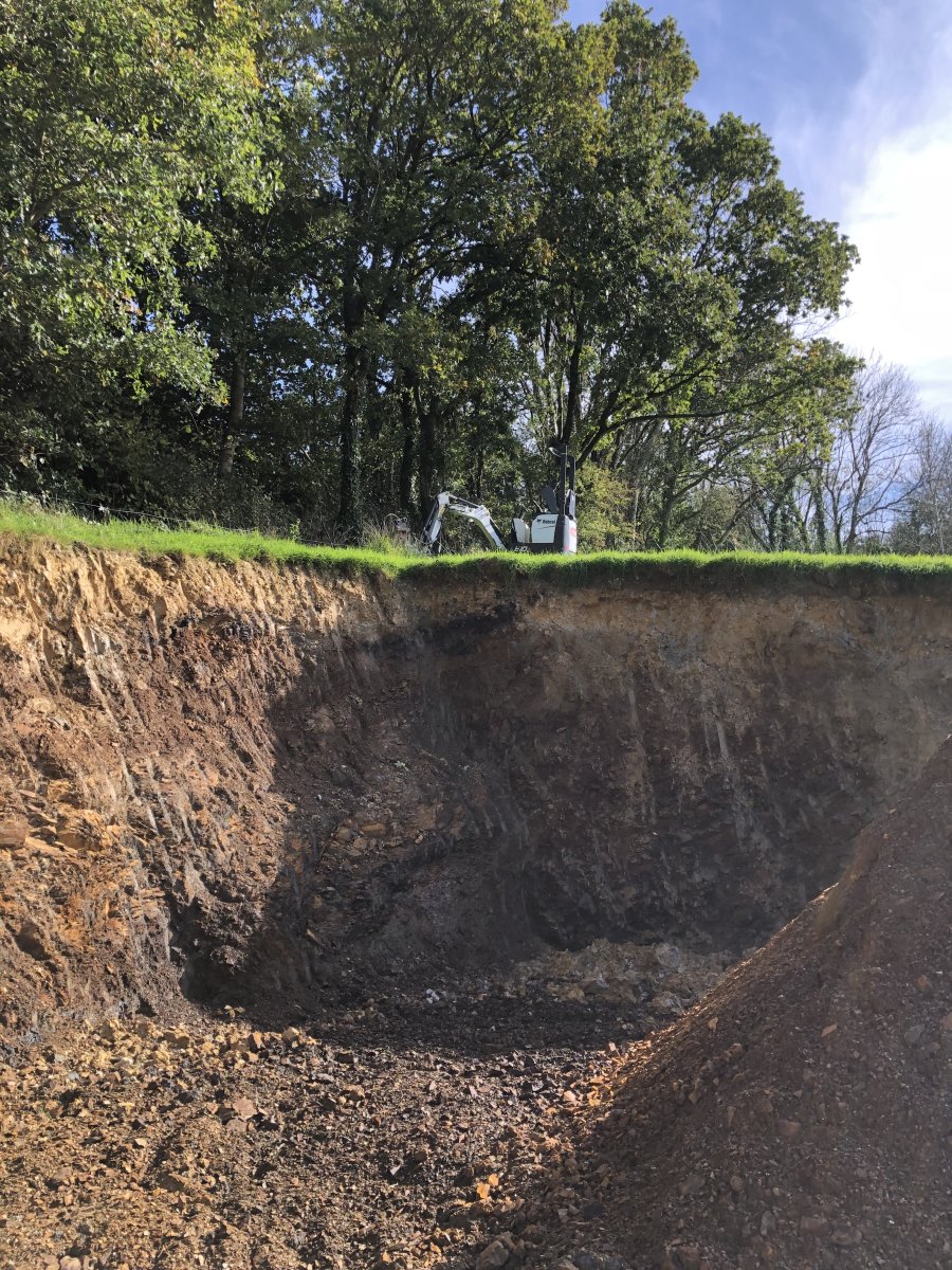

Can't wrap my head around you hang the plumb bob off the post that you're knocking in. Need a picture!
The only pic I can find and it's not a great one as have to zoom into to see the plumb on the post. It's also a bit short- the line should be another foot longer really, but basically choke it off on the post so that the weight and string hangs down the center of the post. Side to side is very easy as you can see against the string line if it's not straight but all easy in the other plane of direction the weight wants to be just hanging so that it's barely hanging away from the post- it's really easy and you can make small adjustments whilst your knocking it in as can keep an eye on the plumb line the whole time- it's a bit of a knack to work with the swing of the line as you knock, but you can get it so the weight is just touching the post as it goes in and actually very little movement. I can get them bang on in both directions this way regardless of whether the knocker itself is necessarily that straight due to awkward ground etc, this is some mineshafts I was fencing around last year. Some of them were pretty bloody awkward to get a machine too but think most of the posts are pretty straight considering

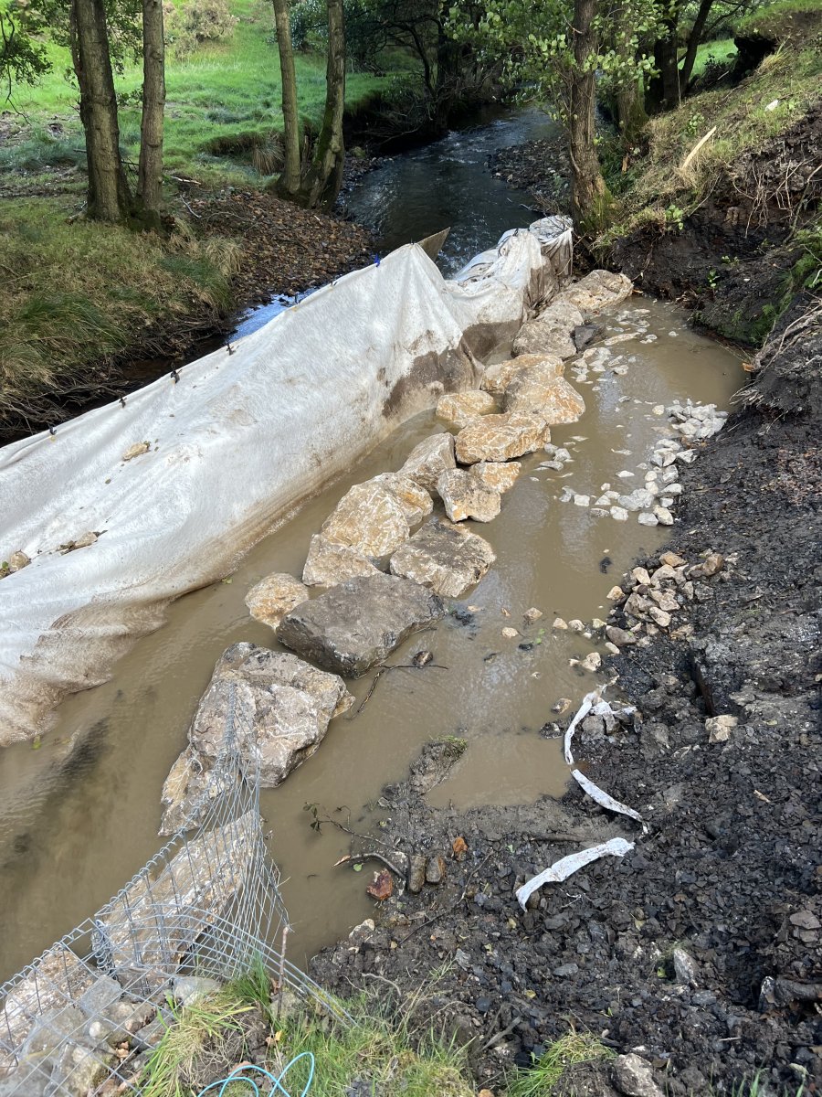

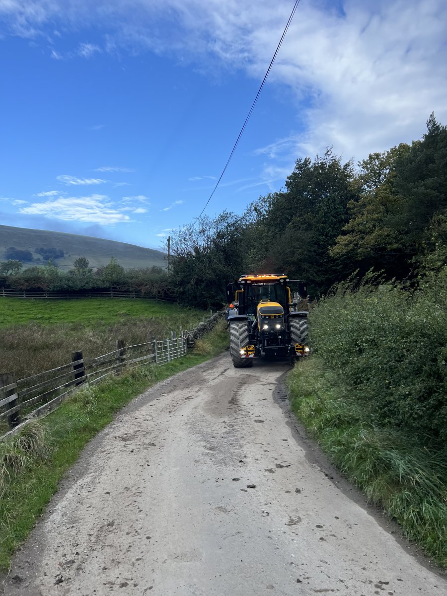

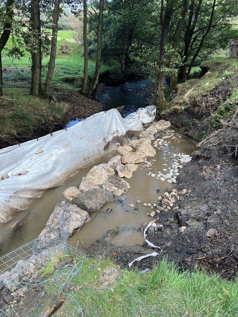

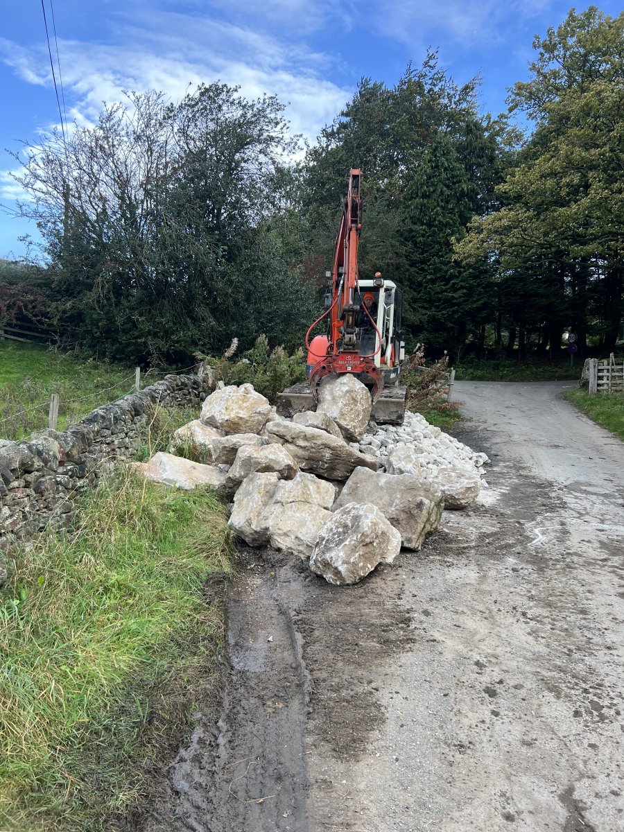

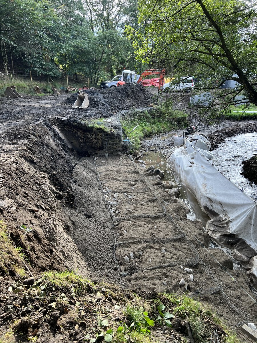

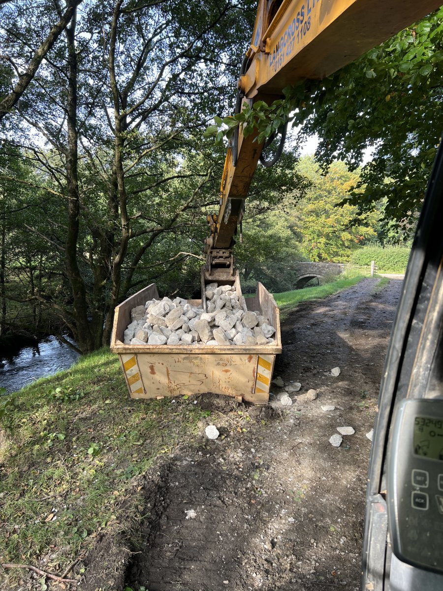

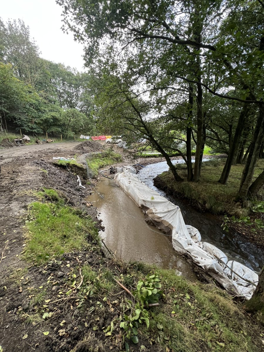

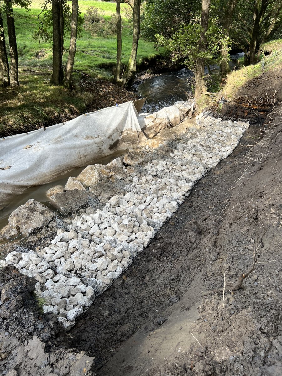

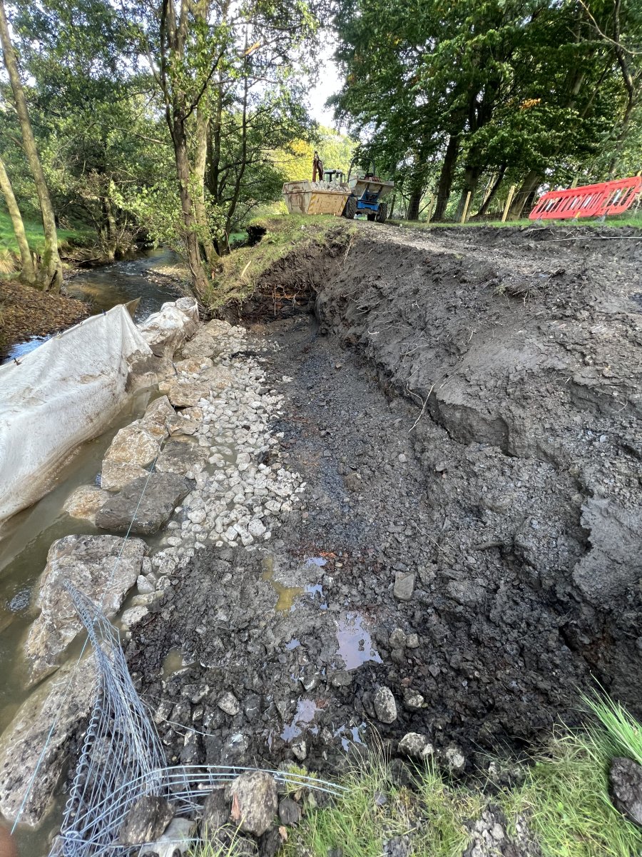

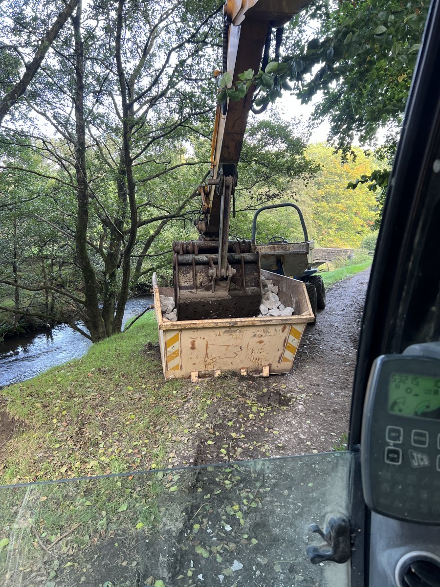

Now we’ve the nod came on more today than last week combined, big uns in, filled with stone then mattress then 8m3 of c30 semi dry
mix to bind it all together.
Hopefully flies in now we are out the water
At least you didn’t have to worry about tidying up / disposing of rubbish on that job!
