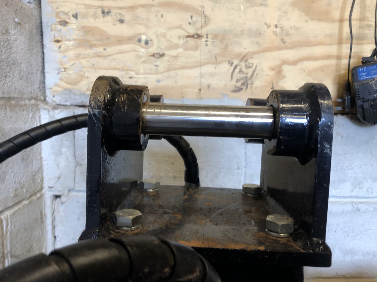

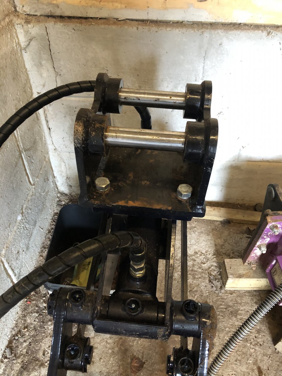

To be fair I find it takes a frustrating ten minutes normally minus some skin . There’s no way to get a socket or a spanner on so it’s a 1/4 of a turn at a time job.it’s also quite large on build height so becomes cumbersome. I think I’ve got the short dipper as we looked at tilties one day

Very poor design. Making the plate 10mm wider wouldn’t have hurt.
if that build height is cumbersome then forget a rotator as well!!

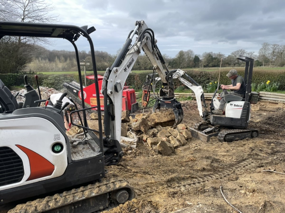

Not the best photo but this is what a grab headstock should look like. So you can grab things out the front! Nobody ever wishes they could grab their own boom (but you still can with this design)
Sane grab as you- great on a 1.9t

Maybe if you changed the bolts for allen bolts it would give a little more room, and get a bit on a ratchet in?
It came with Allen bolts 🤦🏼‍♂️ Bloody nuisance as its a nice bit of kit

To be fair I did message bmc this week but it can’t be done my hitch will open up to 160mm but unfortunately it’s a no go

drill a 17mm hole dead centre, and put a bolt with a nyloc on it barely nipped, swap the hex bolts for SHCS and it'd make life a lot easier with a ratchet and 14mm hex ... bolts out, spin, bolts back in ;)

what's the width?
110mm but could be wider it wouldn’t hurt
can you can that again in English, it doesn’t matter what bolts you put in you can get a socket on it due to the pins , there’s not enough room there . If the pins were removable it’d be easy enough. Trouble is you can barely get a spanner on it I’ve had to adapt one 🤣
