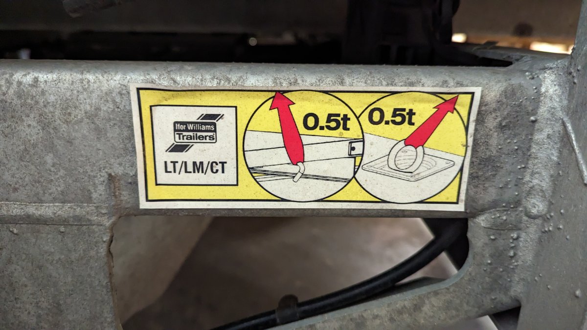

Yup mines got them, thinking500kg?
I bought a couple of the triangle ring ended straps for that purpose but they were absolutely shite ratchets so hardly use em.
so useless for a rat sh1t
