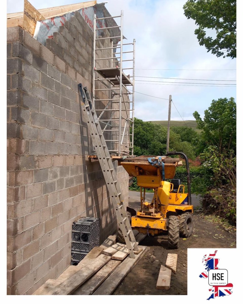

Whilst they haven't literally banned the use of man baskets. The guidance pretty much does the same thing. If anything happens and you haven't worked to there published guidance as a bare minimum then you aren't wriggling out of it.

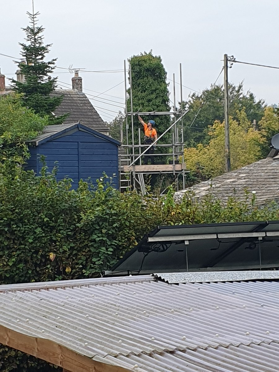

Telegraph pole being cleared of ivy.
7.5 tonne scaffolders truck with two men. Hilux based mewp towing a chipper with two arbs plus a supervisor. No way of getting near enough with a mewp, would need to shut an A road totally to use a bigger mewp, pole hasn't been structurally checked for 15 years. All in all practical and practicable 🙂

So I get it folk are insane! But why didn’t they drive the dumper into the building forwards and set the scaffold up ontop that way around, rather than some canterlever ratchet strap extra effort jobbo!
Or swivel the skip?
Guess some levelling was being done
