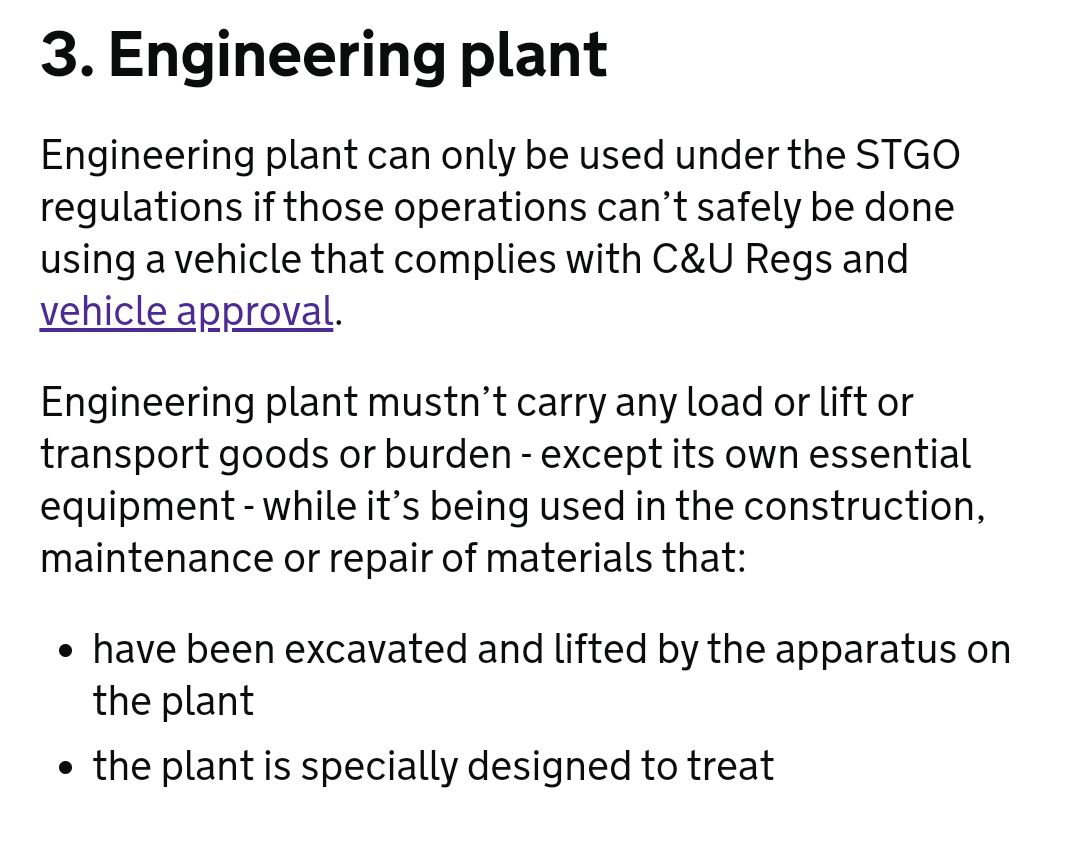

All this falls under STGO believe it or not.... Anything sat in the "Specialist Vehicle" Digging machine Or Works Trucks class that moves slowly sits in STGO

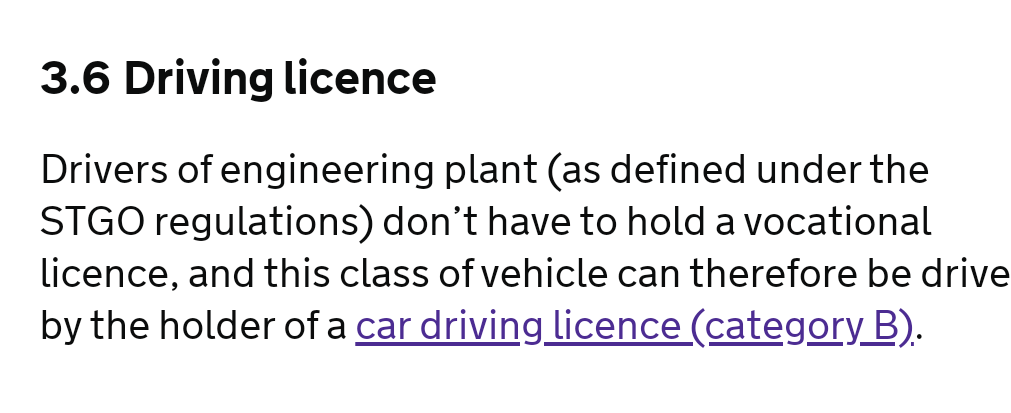

3.6 Driving licence​
Drivers of engineering plant (as defined under the STGO regulations) don’t have to hold a vocational licence, and this class of vehicle can therefore be driven by the holder of a car driving licence (category B).

Good bit of information there but I'm still confused. The first paragraph above says you can only use STGO if can't safely be done using a vehicle that complies.
So I reckon a telehandler doesn't comply with C&U regs but the operation of moving it to site could possibly be done safely on the back of a low loader. What are they saying there?
Don't think too hard..... STGO covers a lot of gear, you will find that paragraph is more to boot the likes of the volumetric hero's into touch.
Bottom line is it's down to interpretation as with any regulation.
