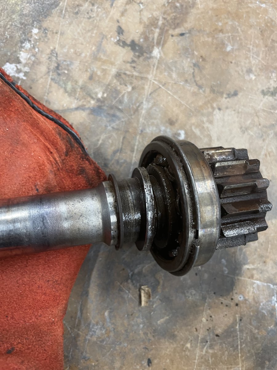

@Mick-the-fitter do you think my input shaft teeth are too worn?
Could this cause the problem of loud 2nd, 3rd and reverse?
They are pointed with no flat part like a new one.
Im not sure what an unusable gear looks like really.

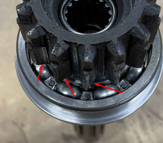

Is that bearing new? That gear does look badly worn!
Bearing is not new in pic before but it was changed after pic.
That was the best pic of the pointed teeth.
Have you ever put a gearbox together with teeth as worn on input shaft?

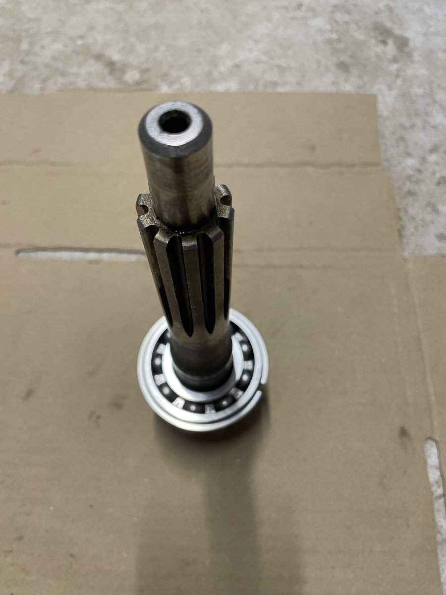

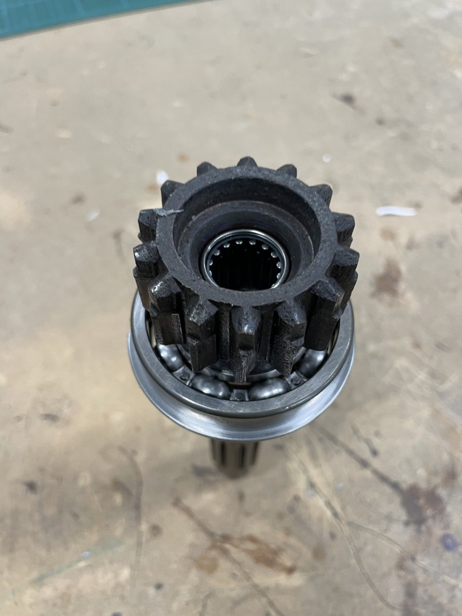

Bearing (53) and Bearing (2) need checking, for this type of damage! But the input shaft should be replaced.

The input shaft (pic5) shows it lived a long and honorable life (and has been abused ever since).
