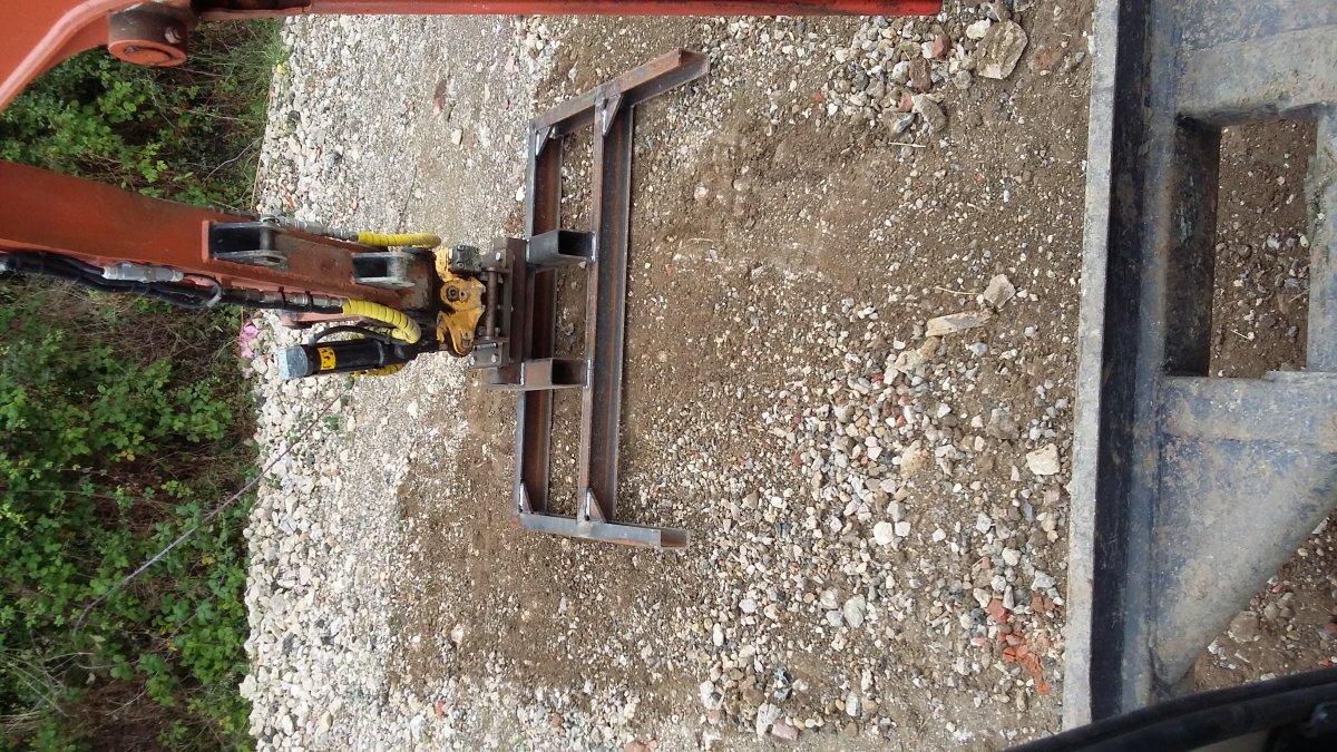

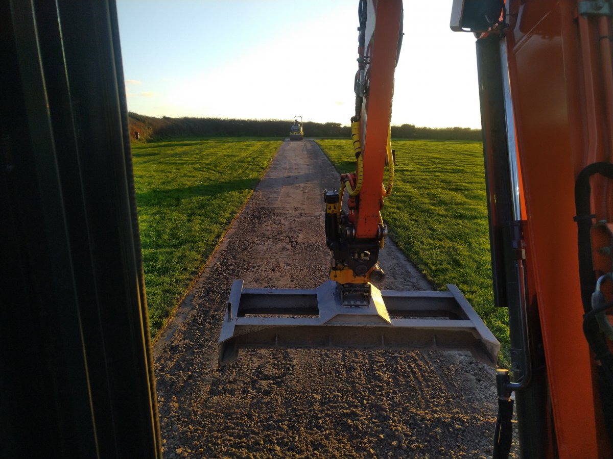

A little video of me trimming with the grading beam it works really well with the offset boom for running along kerbs
Love the video :love:
Now you have gone and reminded me that I now want to add a grading beam to my long list :LOL:
I'll probably end up having a go a fabricating one from the RSJ off-cuts laying around my yard :p

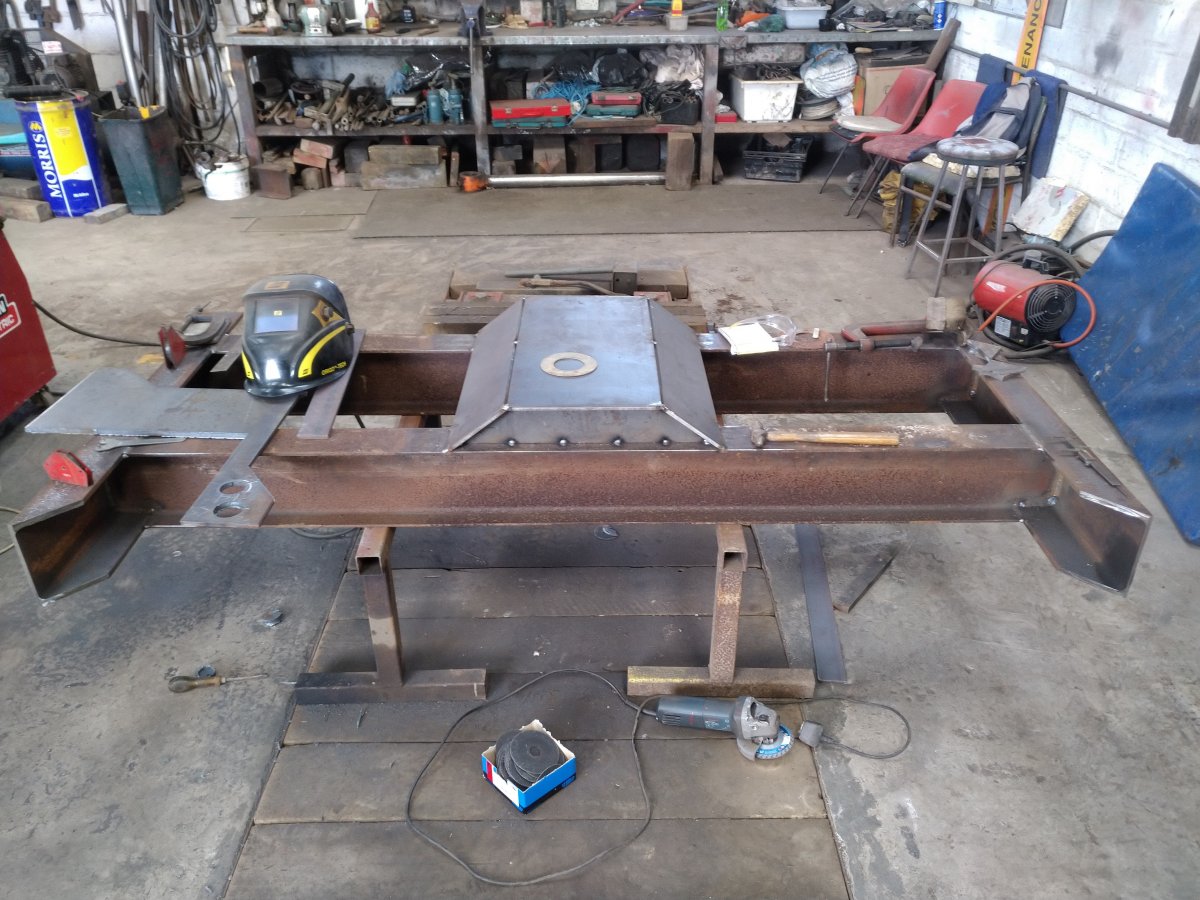

That's all I did with mine 2 pieces of RSJ and a couple of pieces of angle for the wings all I bought is the pins and the piece of plate for the back
That's great Tom - I've just flicked back to yer photo when you welded it up and printed it.
Hope here's no copyright on it :ROFLMAO:
Now if you (or anyone else) has tips or info' when knocking one up from RSJ then it could be useful.

I don't think they are for every job, but in the right place and the right material they are great, and speed things up no end. I did a large are with type1 granite, got it near enough bob on with a bucket, rolled it once without vibe and then trimmed the last 15-25mm with the beam, dud a tidy and quick job, and certainly changed the mind of one particularly sceptical person, who thought I’d bought a useless pile of iron 😂🤦‍♂️
Its also important to be able to carry a bit of material on the blade though, especially if you are levelling heaps with it.

Thankyou yes its not for every situation it's good for leveling large areas to no particular level or trimming when there's about the right amount in already and tidying up site at the end of the week.
I don't know what to do about laser recovers I might add a staff holder next time it's in the yard
Guess what we will be doing when it goes quiet 😇
Yes the only thing I'd change is I'd make the lip bigger on the back to carry more material I've made it 9"

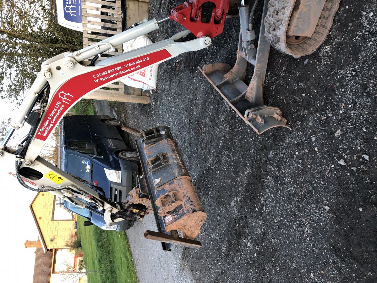

Just flick back through the photos of the beams after using mine this week and I’m not sure it helps much on a mini digger due to reach mind you mine could do with a re-design
I’ll add is was literally made by anything we had
