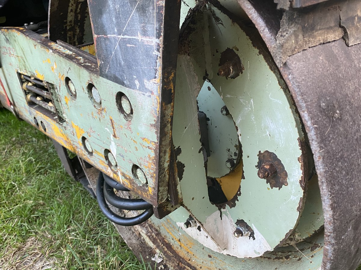

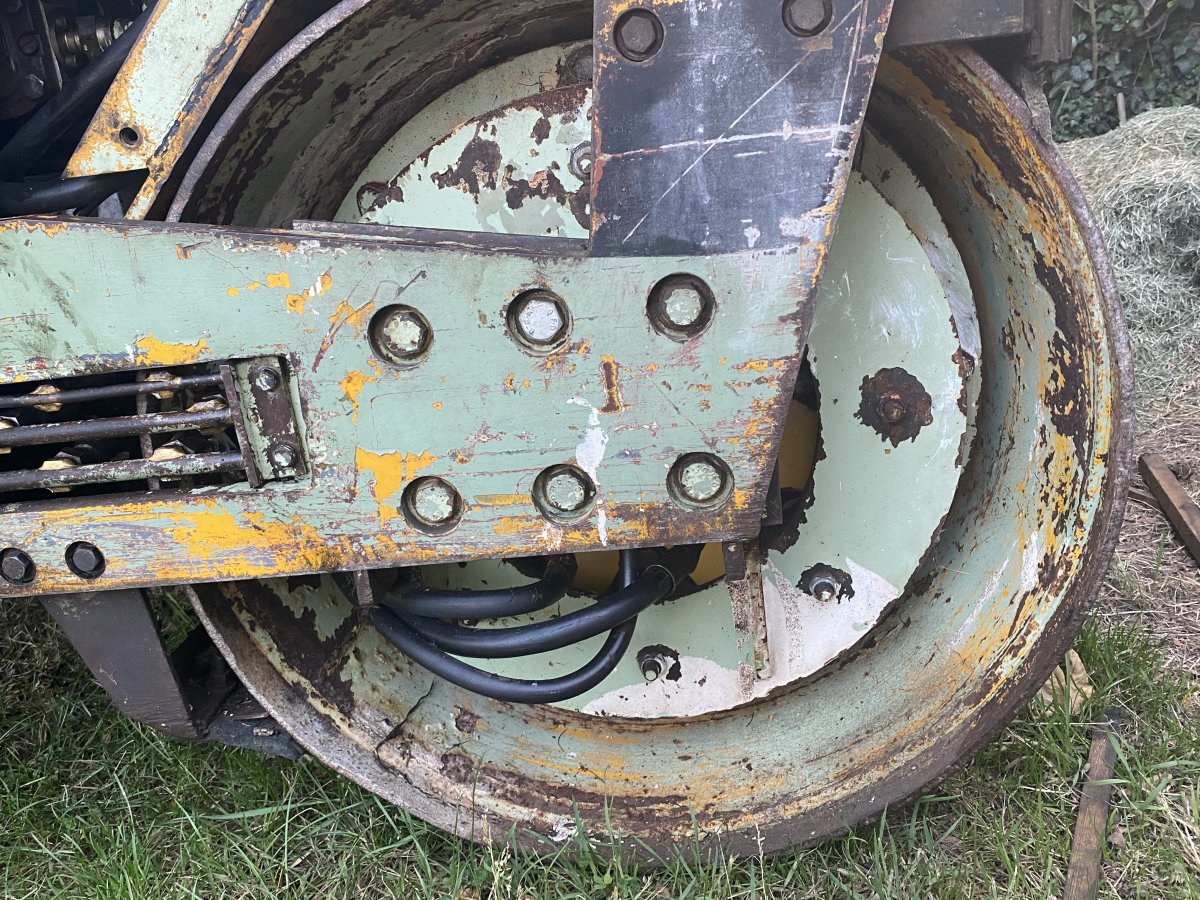

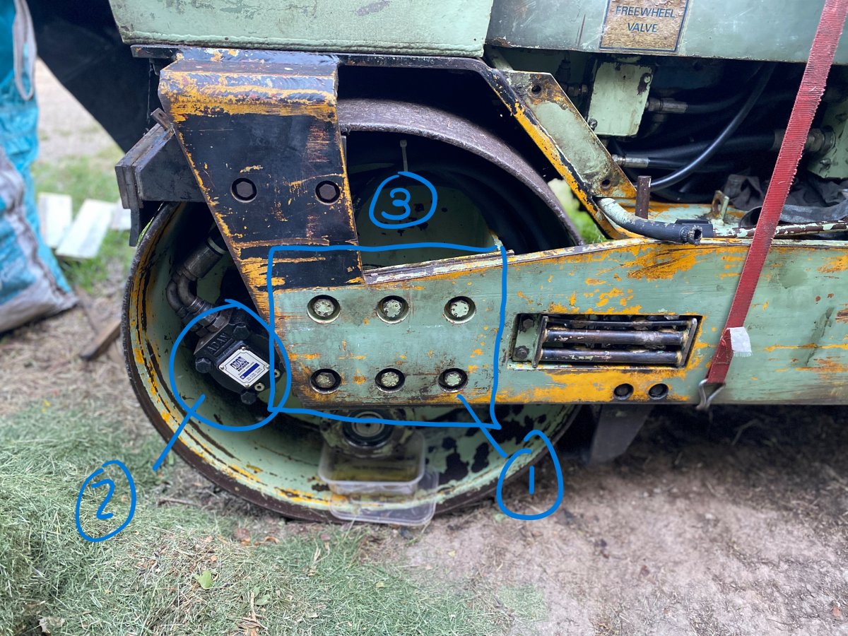

Afraid it’s looking like a drum out first job, jack the roller frame just behind the drum, undo hoses both sides, and all the 24 mm bolts, you may have to lift thee roller frame some more once the drum is loose, then roll it out.
Right then….drum out. Not too bad a job, probably easier if I’d had a second pair of hands.

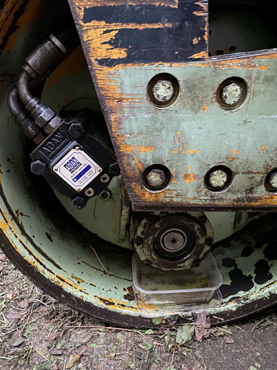

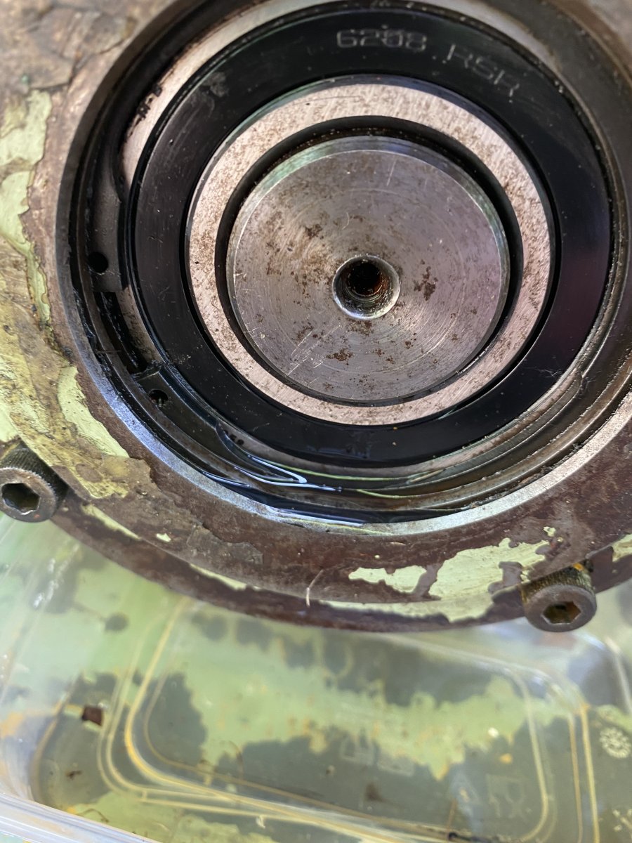

So I’ve got the break off the drum. Removed the snap rings. Before I go cranking on it with a puller, any idea which bits should separate. It looks like the square plate should pull off the shaft.

looks like the square plate is shouldered against the circular housing with the bearing in it :unsure: .... looking at your earlier pix I'd guess it dismantles from t'other end

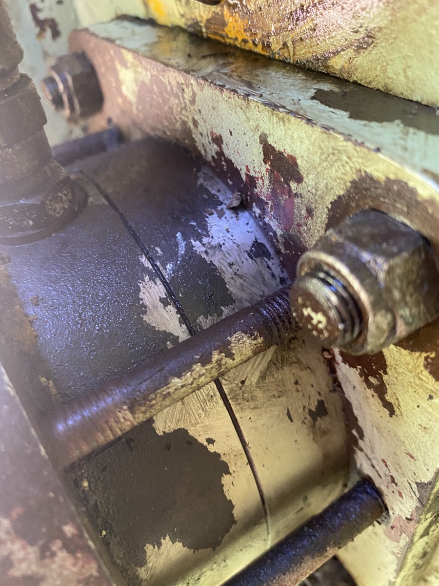

Put the whole thing in a press or big vice, holding the square plate across top and bottom and on the outside hold from top to bottom between the 6 bolts, find yourself some threaded rod I think M8 and some nuts, remove two cap head bolts and replace with two 150 mm threaded rods, run the nuts down to hold in place whilst undoing the other bolts, fit two more threaded rods 150 mm Wind each nut off a little at a time, you only need to create a gap big enough to remove the sealing o ring, and fit a new one, make sure it’s stuck in with some grease before bolting back together, if you join the two drive hoses together and put the pipe back on the brak you can test it before it all goes back together!
how do you get the new o-ring in behind the threaded rods Mick ?
looking at the pix above Dixie already has all the cap heads out?

If he winds the nuts to the end of the threaded rod, the brake pack will be unloaded and able to pull apart, if it’s in a vice or press leave the nuts at the ends, for safety, and let go of the press or vice, inspect the brake pack parts, replace the o rings, rebuild.👍
understand what you're saying but looks like he has already removed the cap heads and it hasn't sprung apart :unsure::unsure:

The outer bolts are removed first, take all parts out, the rear half has its own bolts internally.
yes its not sprung apart as the shaft goes through the middle with bearing pressed each end?

Chaps, for now I've deleted the brake assembly as this can be refitted without removing the drum. One for later.
