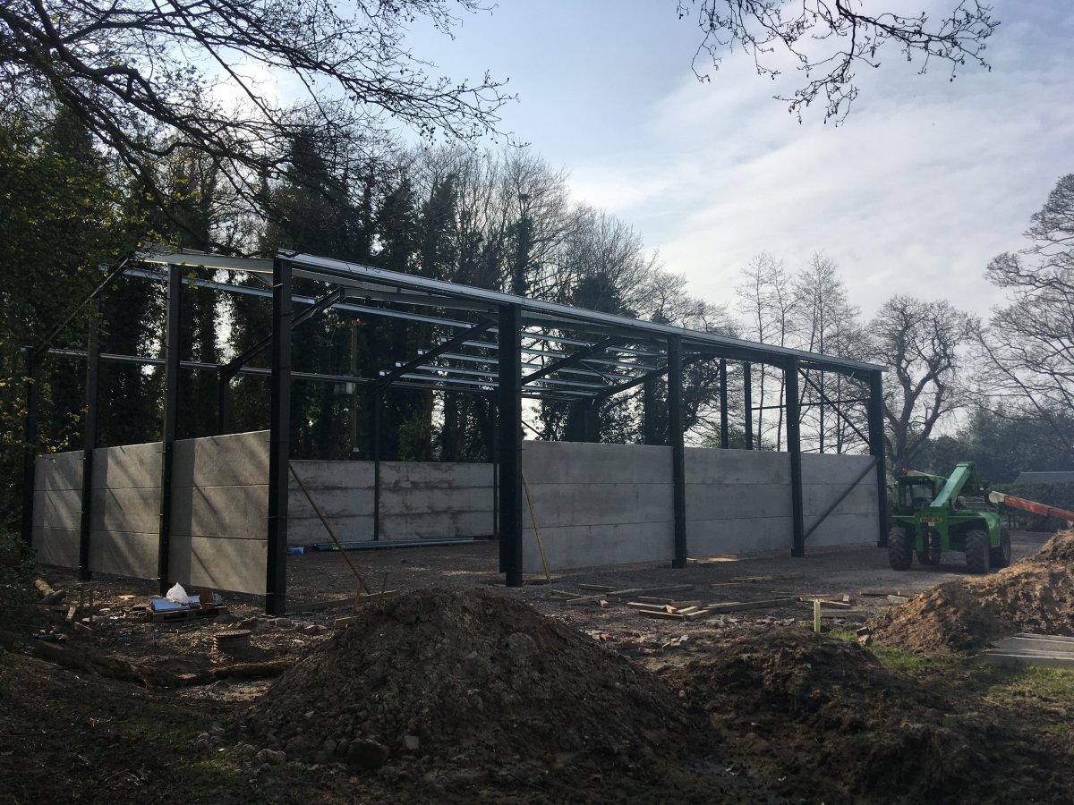

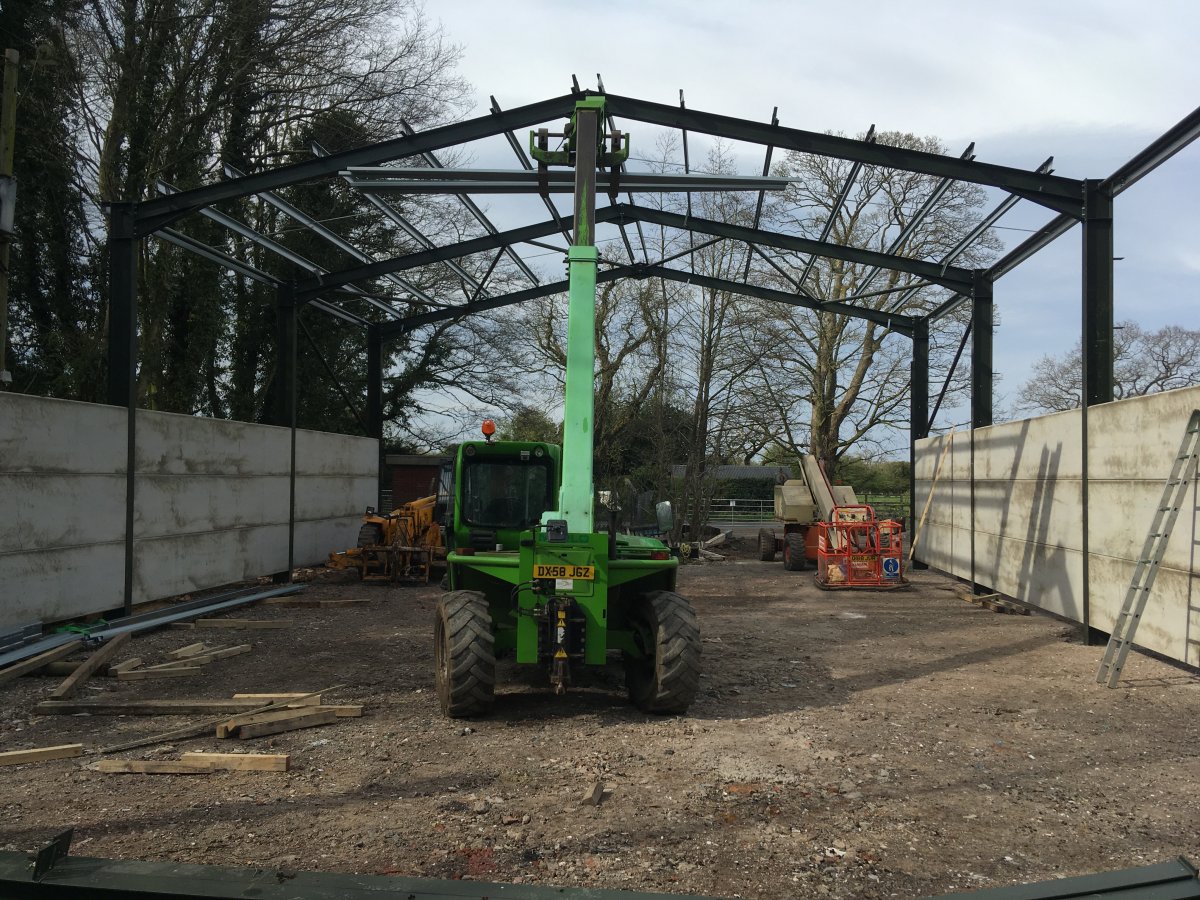

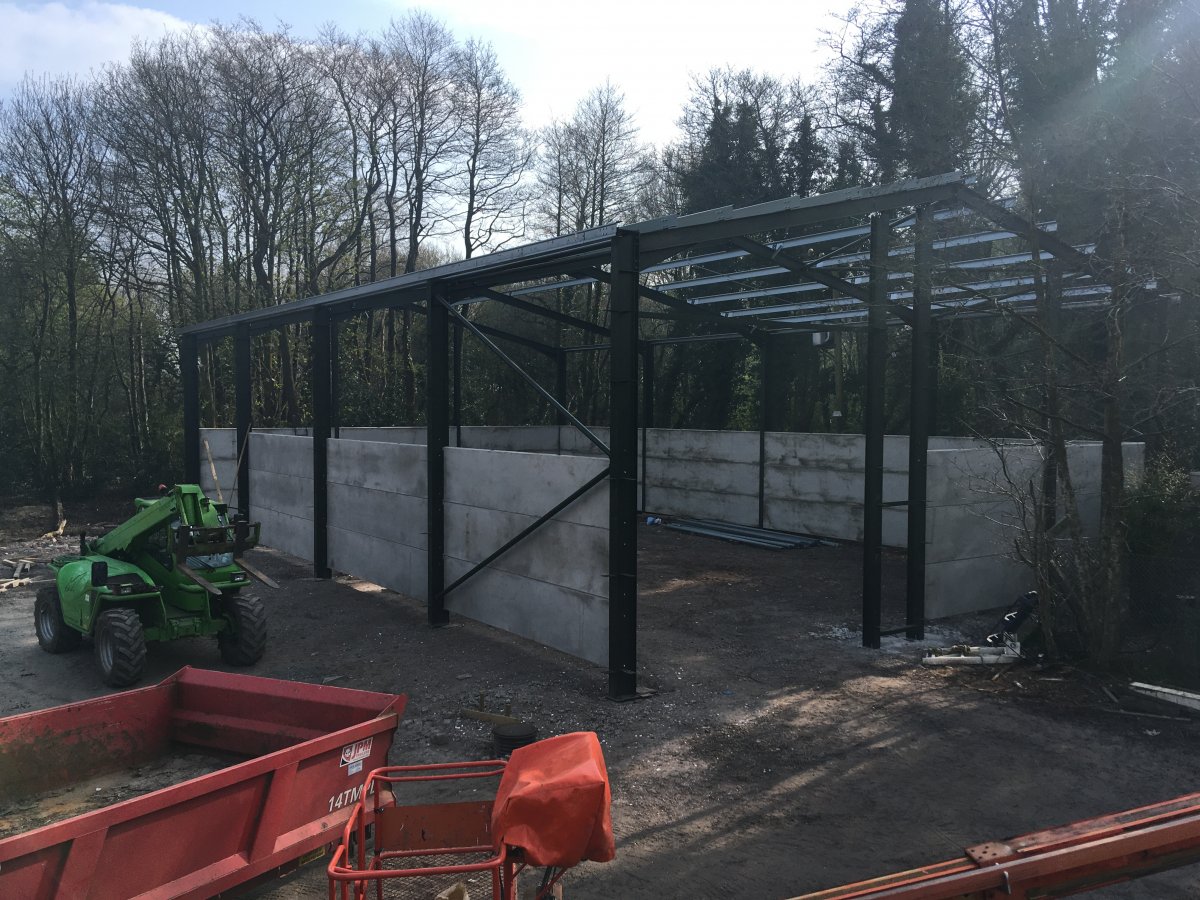

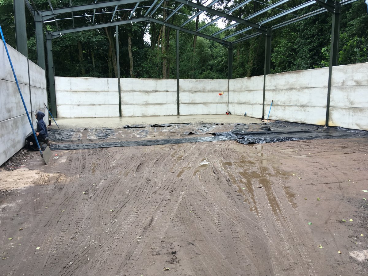

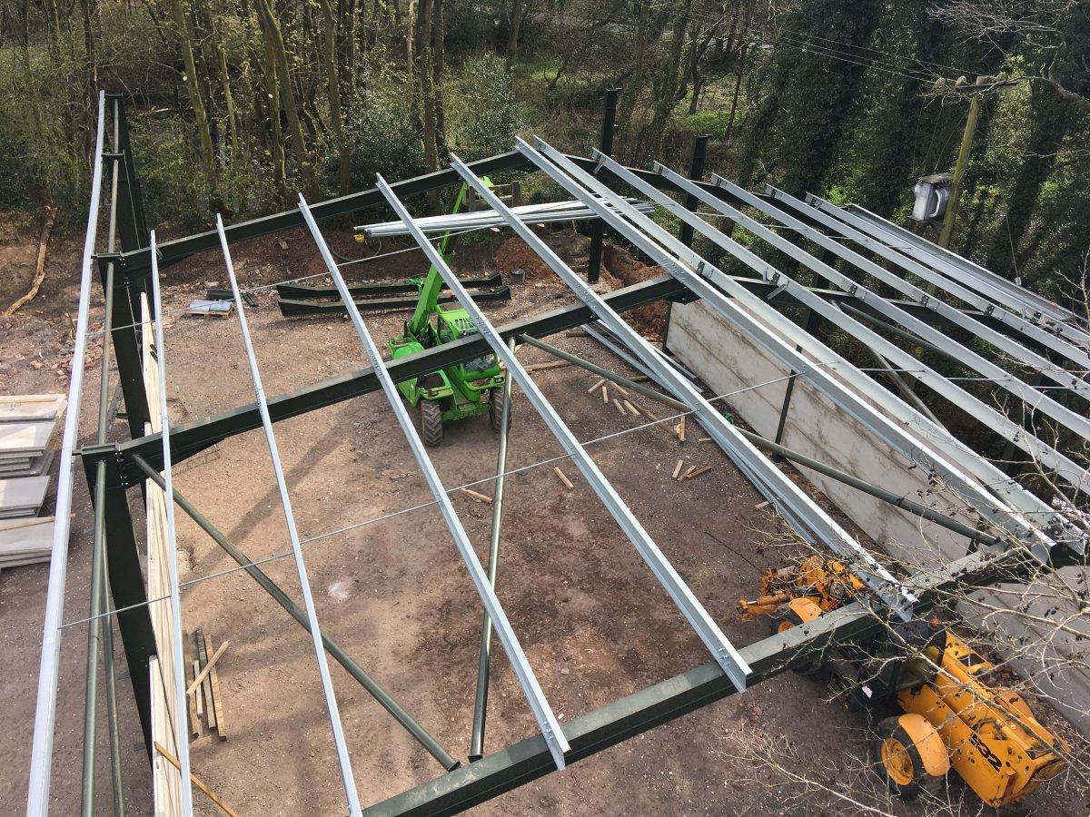

Just to update this thread - I ended up buying the steel frame from Brad Rushton Buildings - I’m really glad I didn’t do it myself as there is a massive amount more to it than I gave consideration to!... I would have been miles out with my estimation of pricing (for one thing there are 5 portals in a 4 bay building, not 4 - what a numpty!!!).

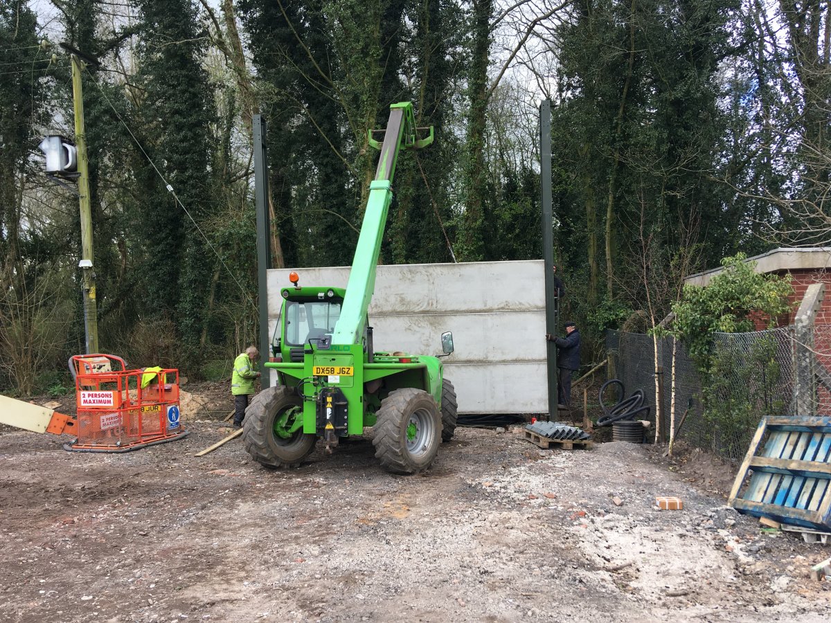

The kit came with every last nut, bolt and washer and went together perfectly - several people (who know a lot more than me about the subject) have commented on how good a frame it is so maybe it’s worth bearing in mind if anyone else is looking to purchase? As a company they were great to deal with, loads of communication and all done as agreed. I’m more than happy to recommend them.
The concrete panels came from Jones Brothers Concrete in North Wales - superb quality and really easy to install. The panels are incredible value for money when you think what a wall would cost!

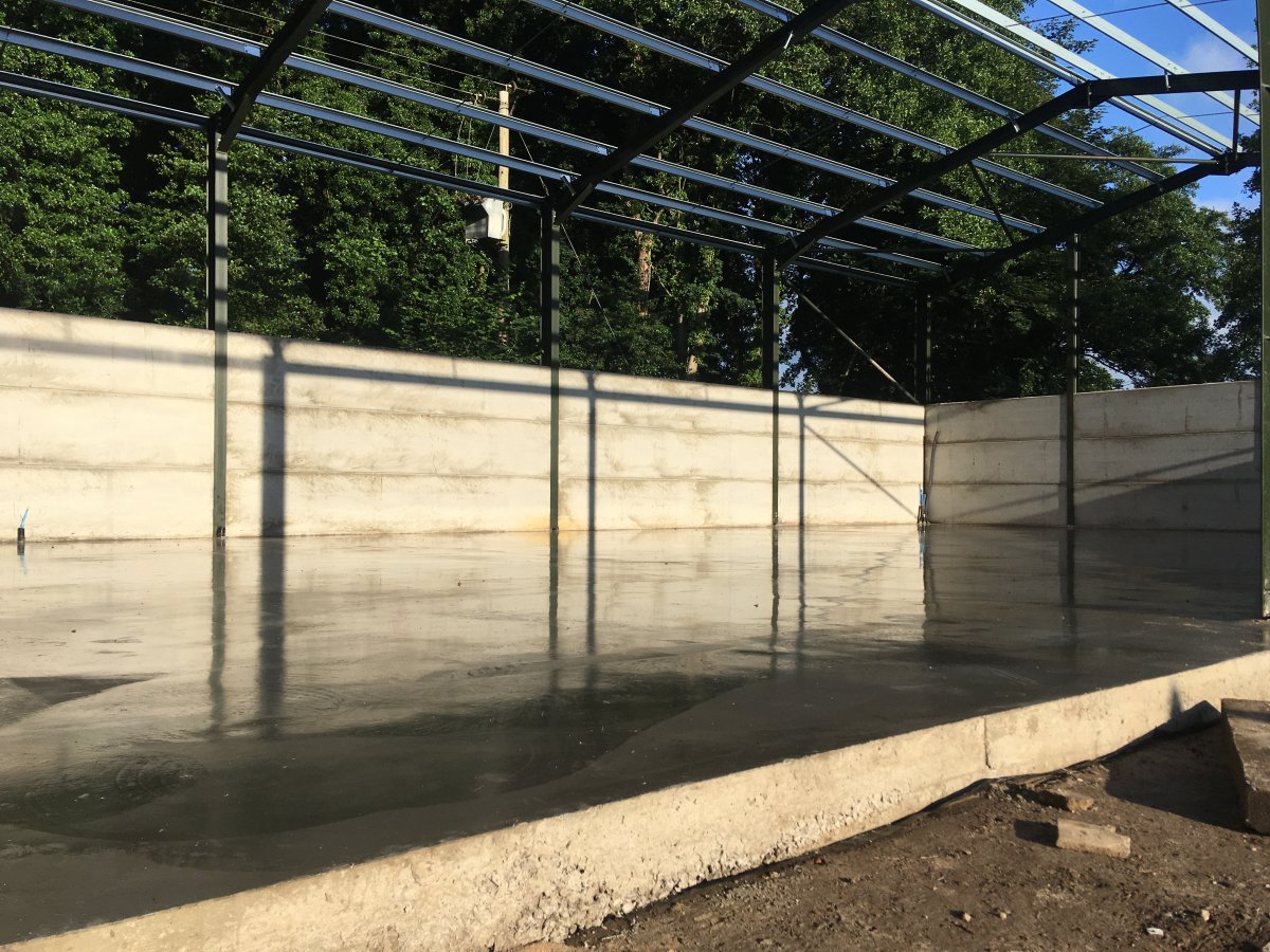

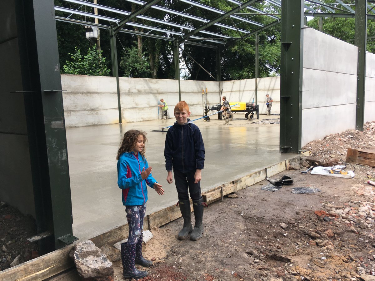

On Friday, Ceres Construction from Chester poured me a concrete floor. I rang them for a quote at the start of lockdown as I knew of a couple of their previous jobs (which were great) but didn’t know them, and I didn’t want to mess anybody I knew around quoting as I wasn’t sure if I could really afford a concrete floor at the moment.
Ceres quoted less than I’d budgeted (to the point where it was actually affordable!) - I bounced their price/spec off other friends who do this for a living and they all said it was a great price. On that basis I gave them the go-ahead, and I have to say that I’m delighted with what they delivered!
