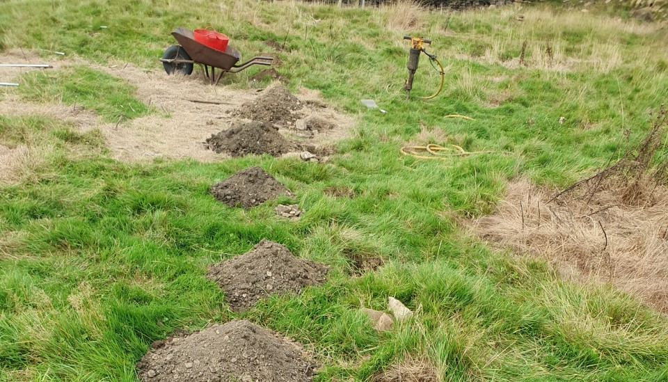

I have to say they were very good to deal with. They have a great post anchoring system whereby you screw the bases into the ground like a corkscrew.
It wasn't going to work here, it's more stone than soil. How many people dig the garden with a road drill powered by an old Magirus, not many yet there I was.
Disiski mixes up the compo:

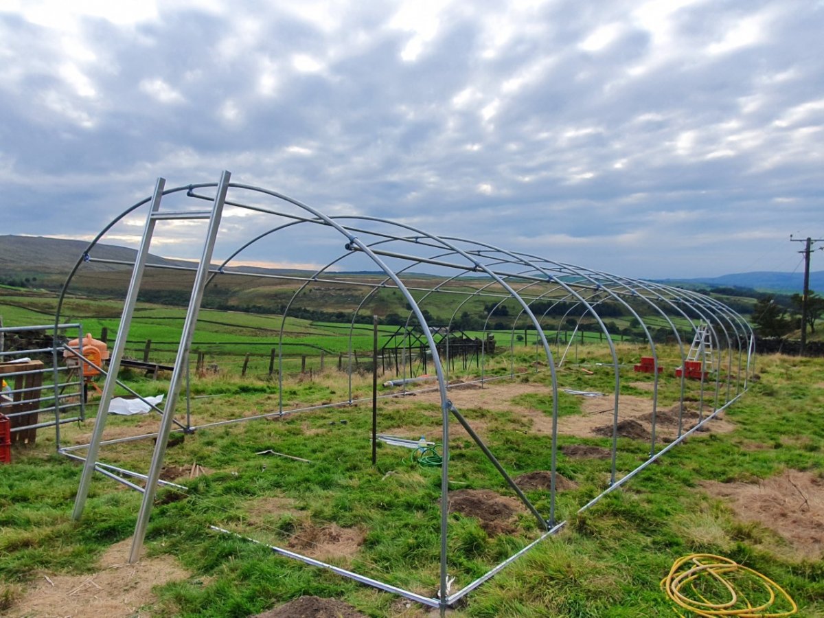

Basic framework going up:

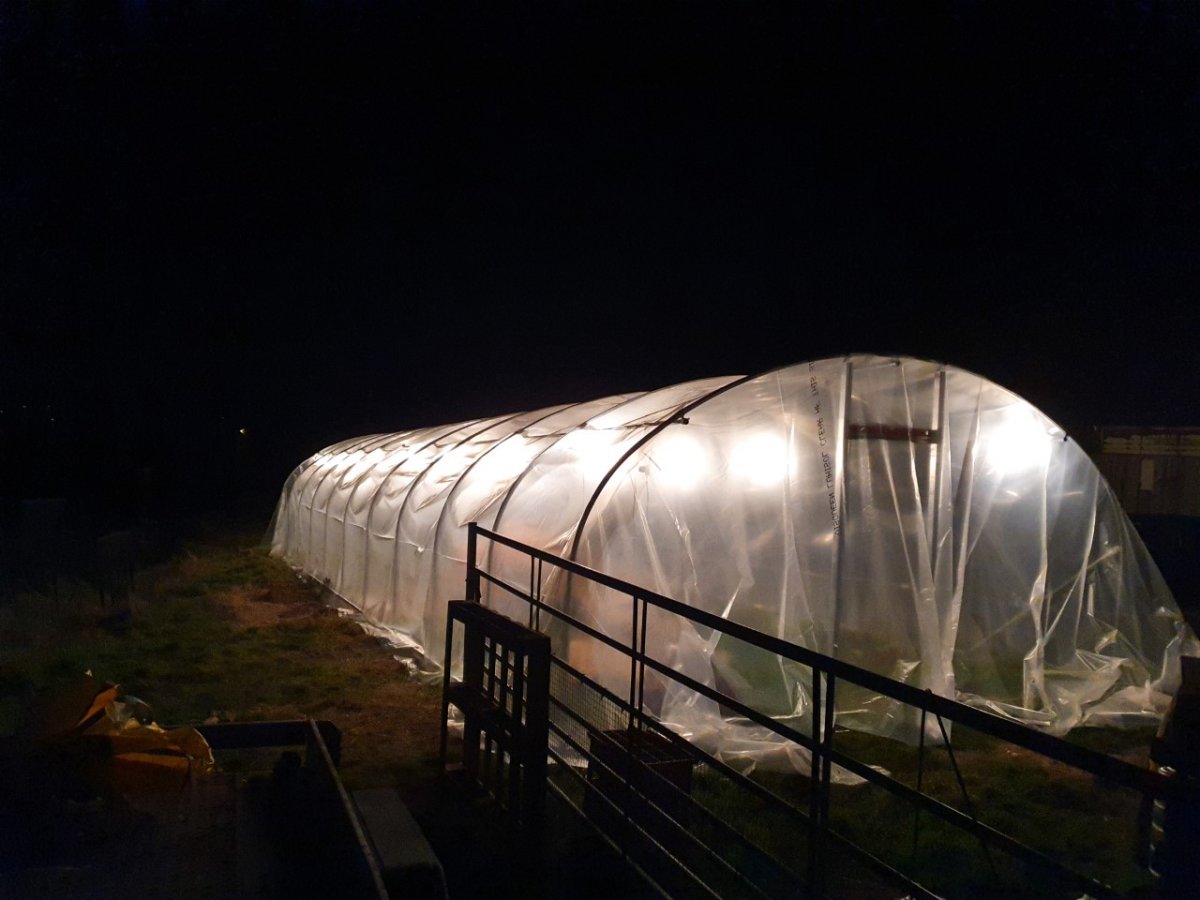

I knew i'd hung onto those Festoon site lights for a good reason. Just didn't know what that reason was until now:
All metalwork completed, polythene tensioned up and locked in place:
what size is your PT in these pix please ... looks very tidy ... daren't show this to Pam

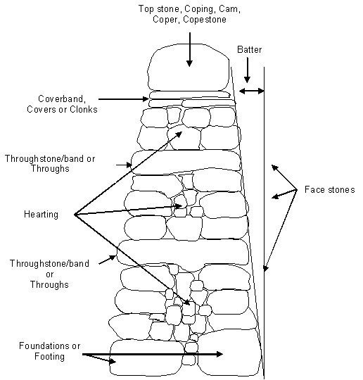

We have quite a lot of dry stone walls around here, most of them falling down due to various reasons. My birthday present was a 2 day dry stone walling course for two :rolleyes:
Here is the basic design and principles of a DSW:
Maybe like me you'll be surprised to see the 'batter'. Not fish or fanny batter, but the way they taper inwards towards to top.

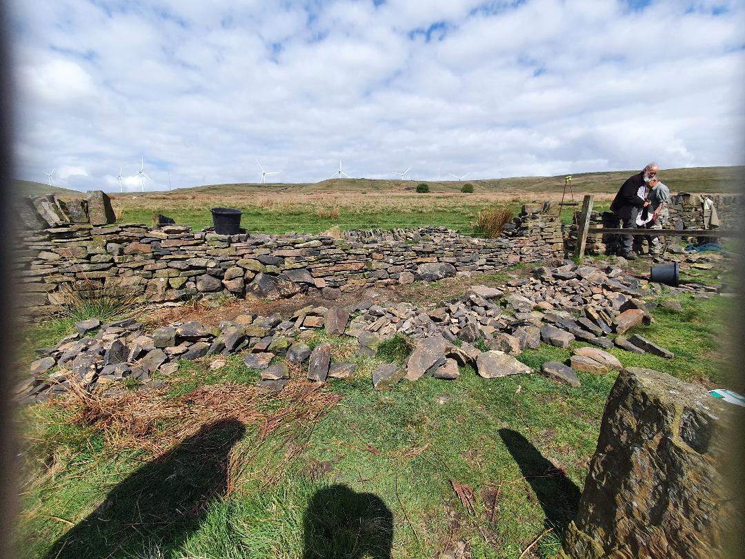

So there we were in the middle of nowhere knocking down and building up a DSW. You take all the components and lay them out on the ground in groups so you can see what you got, then start to build it up again. Halfway here:
Then the next day all finished:
All perpendicular joints are crossed like any other wall, none in a line.
A normal modern brick cavity wall has the bricks laid in length (stretcher bond), but in a DS wall they go the other way so the length of the stone points inwards for strength.
The top course of copes is also very tightly packed. If you shove the wall sideways and it moves it's no good, if it's solid then it's a good job well done. Every piece of stone on the floor will have a place in a wall somewhere (eventually if you carry on long enough!), it doesn't matter what size or shape it is.
I think it's like a lot of things, you can learn to do it, but you'll never be as quick as someone who does it for a job.
It's physical back breaking work, but ultimately very rewarding too. Done properly it should stand for 100 - 150 years.

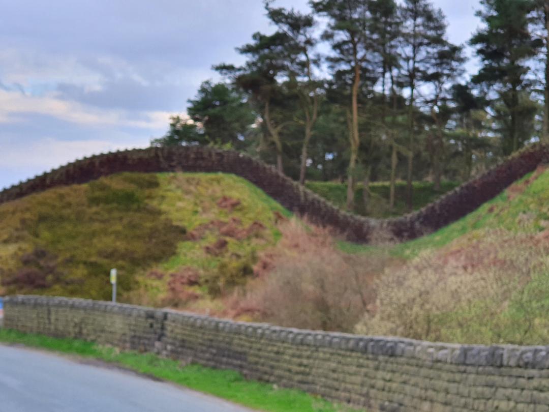

This is a beauty I found not a million miles away from here, it's of coursed stone, not random:
That's a wall to be proud of.

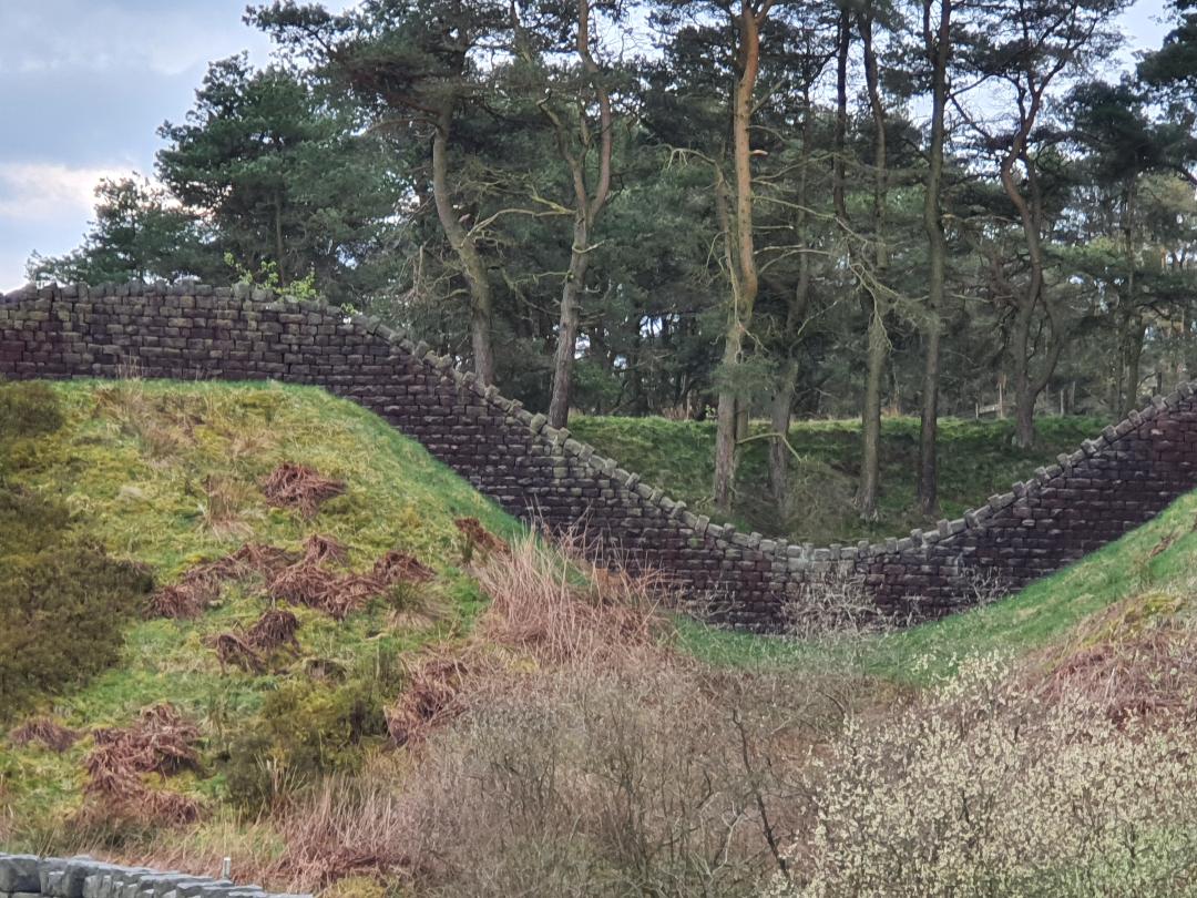

😎 I'd say it's one of the first thing visitors up here comment or take pictures of if they've never been before. You get used to them but when you stop and take in just how much work went in to some of the hill farm walls on the tops it's staggering.
That wall in the dip is beautiful

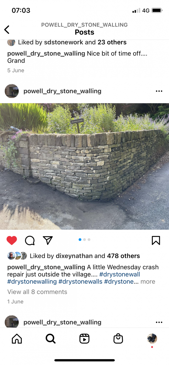

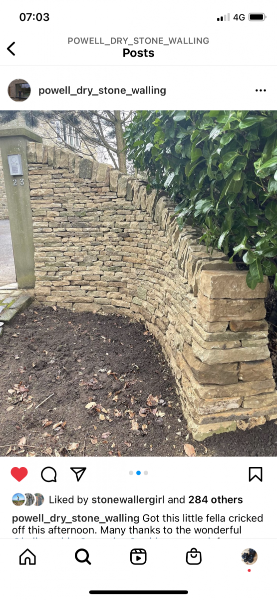

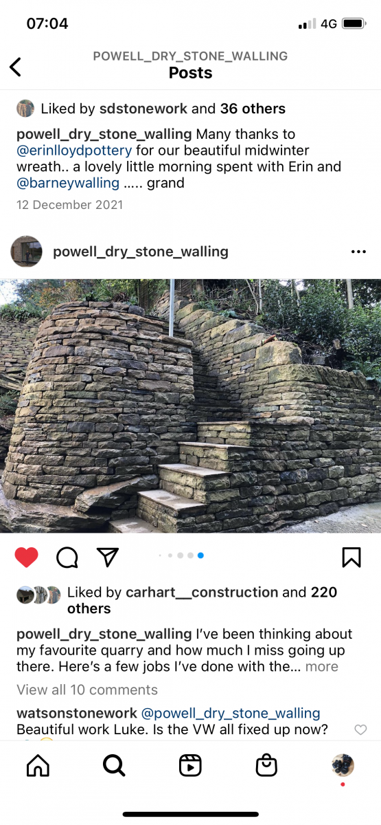

I gave some farmers who throw it up so fast you wouldn’t believe there like machines, then at other end
My mrs cousin is master craftsmen drystone Waller in Huddersfield way he’s mint at it, love a good dry stone wall. He’s even been out to Japan to do stone work for like zen gardens and such for big pharmaceutical company.
Also worked with these lads who do great walls they did the house on grand designs said they filmed hours of them working interviews etc none made it into show haha stonework’s best bit about the house.
Brilliant skill to have, I’ve tried a bit but never have the time to give it full attention

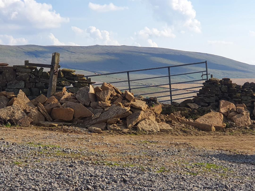

Part of my Professional digger training included knocking a wall down whilst digging out a huge stone from the yard.
If you've never done this then you're not a proper digger operator. 👌

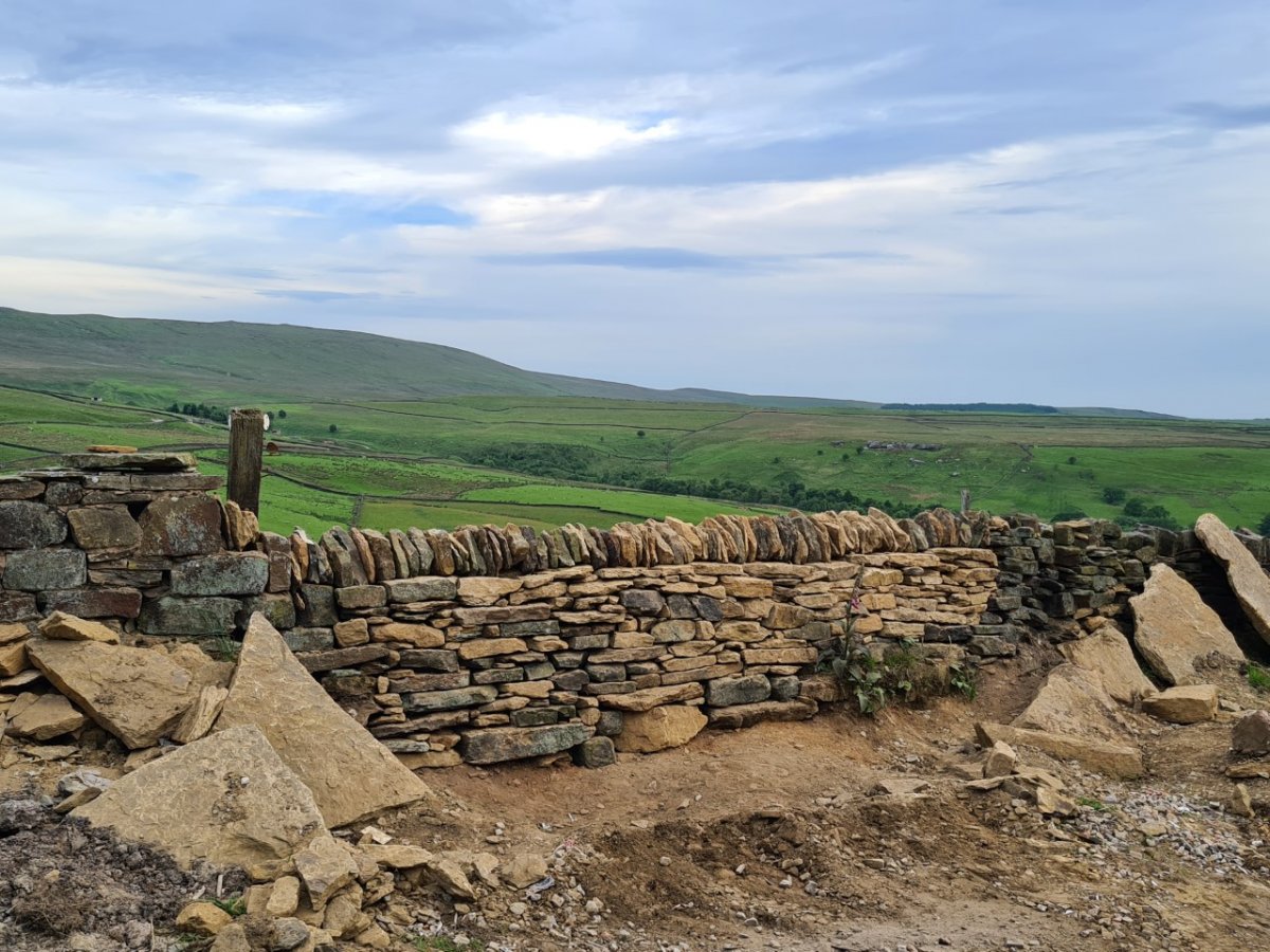

To be fair it wasn't a great piece of work to begin with, you could see straight through it in many areas.
It wasn't the easiest of walls to tackle for the first job on our own, to the left used to be a gateway, but had been filled in 'bricklayer style' using mortar and had gone a bit too high, beyond that was a piece of decent wall. The wall to the right resembled a pile of stone just dumped off the back of a truck and it was all perched on an elevated bank of soil and crumbling rock, both pointing in different directions and different widths too. So basically we were joining shite to crap, the other thing is we're thinking of taking the whole lot down eventually as the house is behind me and it'll create a better view. I'm not sure it's sheltering the yard and house from much (apart from sheep at the moment).
I decided to make it level, sorry I never took any 'during' pics, but finally (after 3 days) it looked like this:
Maybe needs a bit more work to step it up at the left to join the other wall, but it'll do for now.
Tired and aching we sat in the evening sun and enjoyed some home made cider admiring our work. After a pint or two of that at 9% it looked even better 😄
