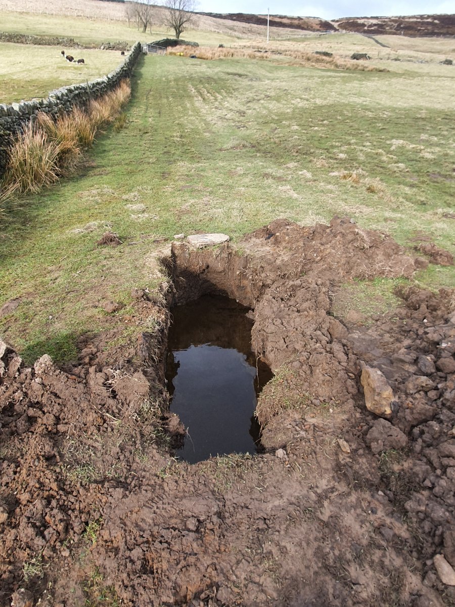

Here i've dug down to expose the capping stone and am levering it off to find something which is circa 150yrs old, but still running fine:
Looking through it:
They are known as 'Soughs' and are placed in strategic places under the fields all over the place. I've had to learn how to read a field to find them, but even then many are still undiscovered.

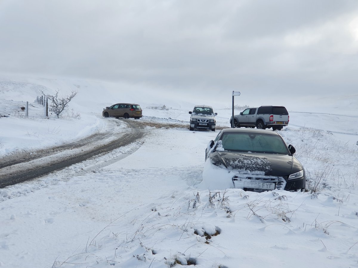

Terry isn't happy and neither am I. Two weeks previous we were scampering through that just fine, but after a struggle that day he was up to his axles in it.
Terry's mate came to pull him out as he had a lift kit, winch and better tyres. Rock hard:
Terry's mate also got stuck, I didn't have the JCB back then.
These are some of the tools we used to drag them both out:
Some of you will recognise a ground anchor (which I made), but it wasn't 100% effective. The ground was so soft it pulled it through and out when we coupled the winch up to it. In the end we had more success hammering the steel pole in and winching off that.
We started at lunchtime thinking in a few hrs we'd be done, we finally got free at 10pm on one cold, wet Winters night. Both covered head to toe in wet mud.
I'd previously warned him he could well end up staying the night here!
That's probably why he never gave up. I helped out and tethered Terry to the back of his as we dragged everything slowly back up the hills to the old farmhouse.

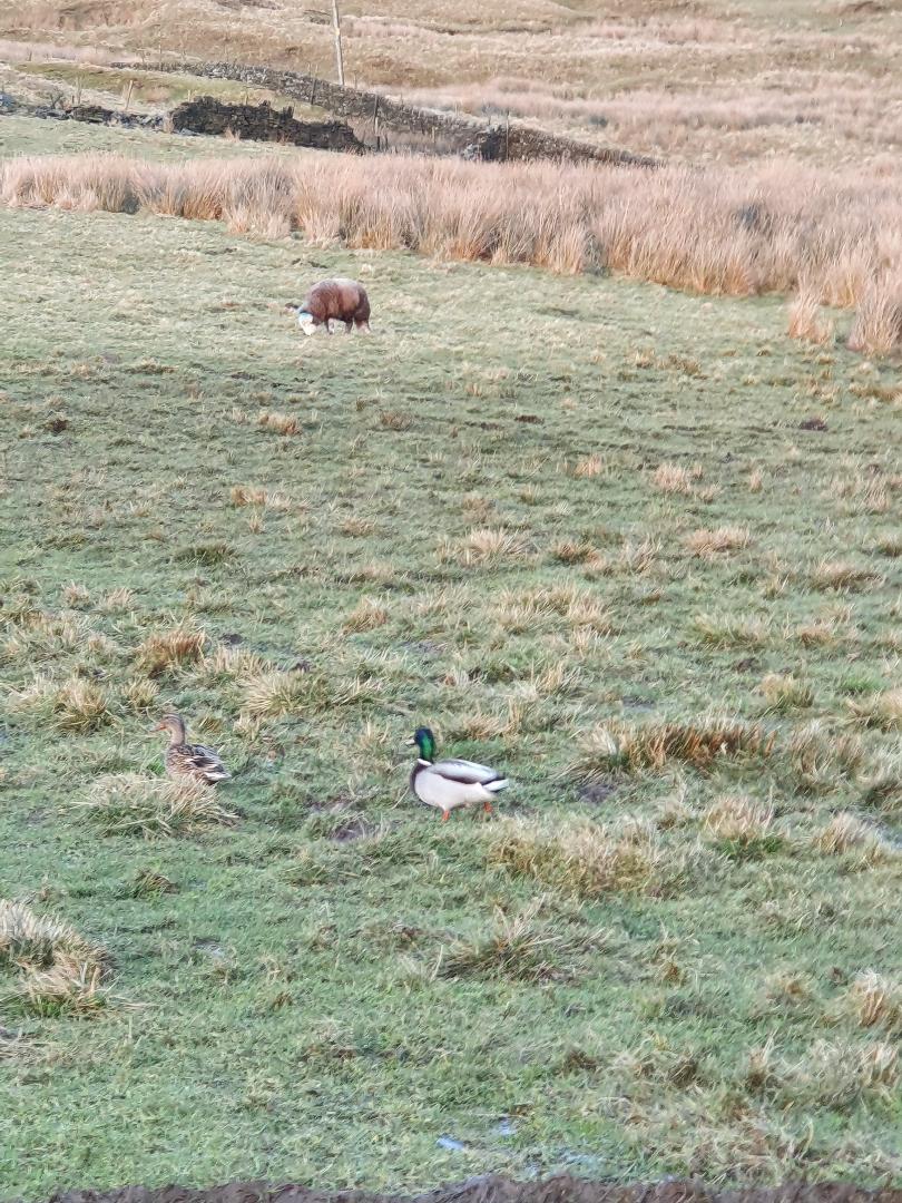

When these start living on your fields you know you've got drainage problems 😅
As said earlier you learn how to read the fields (see the dry line there below the sheep) and the M1 Sough wends it's way down underneath turf meadow (all old fields have names and Tithe numbers). You look for low points, divots and dry parts, where you've got those it's likely a sough is running underneath. I've learned to follow the M1 up the field with a machine as it's the driest way home and you don't get stuck.

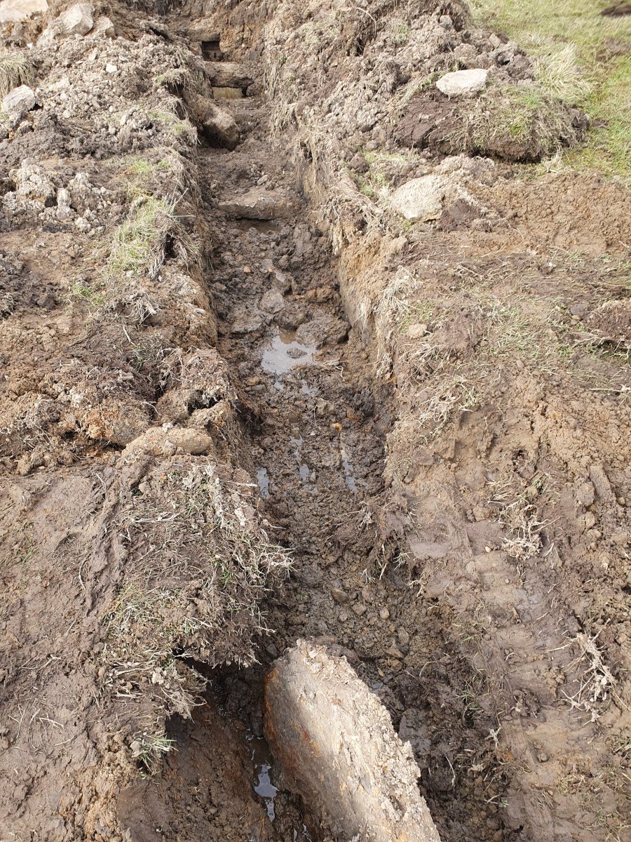

As you can see it's blocked as it's been badly installed (with no gravel), I cleared it out, but still the M1 overflows.
Time to get a digger down there and see what a mess we could make:
Dug a bit out where it was boiling up, went away and came back when it had cleared. I've actually gone down the outside of the sough there and it's to the right of my trench. If you look up the field there in that pic you'll see dry ground heading up and then to the right. When it gets level with the gate it switches back to the left by the yellow pipe and picks up a stream which comes from the left.
More and more came out, it's bit like Timeteam 😄

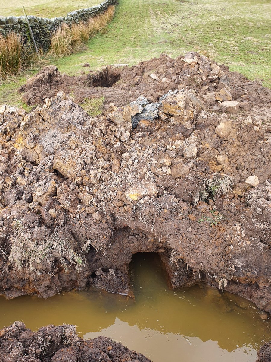

There is more in this pic than you realise too. Right there in the middle is something called bluey grey 'Gley'. If you dig for a living maybe you've come across it before, but it's rife all the way up the Pennine ridge and in Scotland. It doesn't want to leave the bucket I know that for sure.
The bright orange stuff up there ^ near my bag is Iron Ochre. It's basically iron ore, water and bacteria working together to make a horrible orange jelly which blocks up drainage.
Due to the blockages it's not had water running through for decades to flush it out. The reverse has been happening. The water runs in carrying silt and gravel, slows down, stops and dumps it there so it backs up and fills up even worse.
If you go in by hand with a shovel it's hard work as it's solid and got many bigger stones in there, you're also digging very low down below your feet so it soon cause severe back ache.

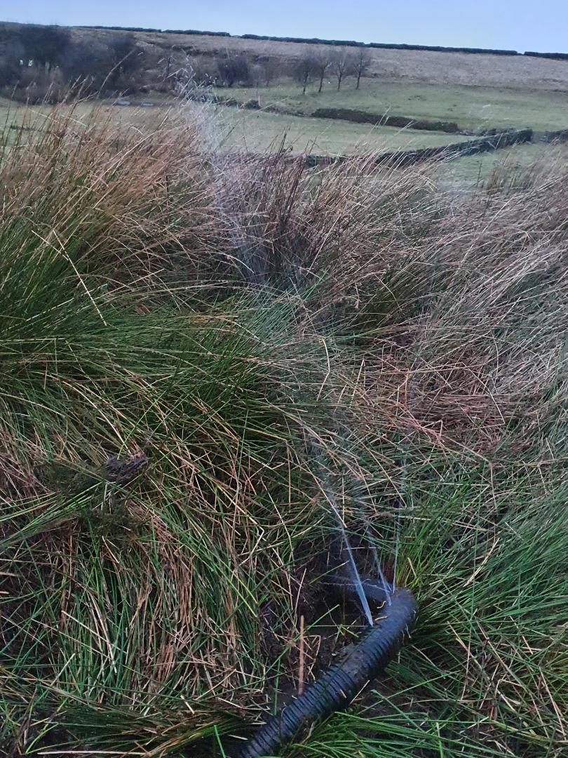

Like I said it's all about observing, waiting and learning. What do you think to this:
If you can't see it this will help:
It's a band of wet ground, see how the wheels or tracks have sunk in. The red line is a sough drain which is where the wet patch stops as it percolates down, in and runs away. The blue line marks the top of it.
I think this is the edge of a water table. If it is then possibly the only way I could tackle it is to put multiple land drains across it which would be quite expensive.
