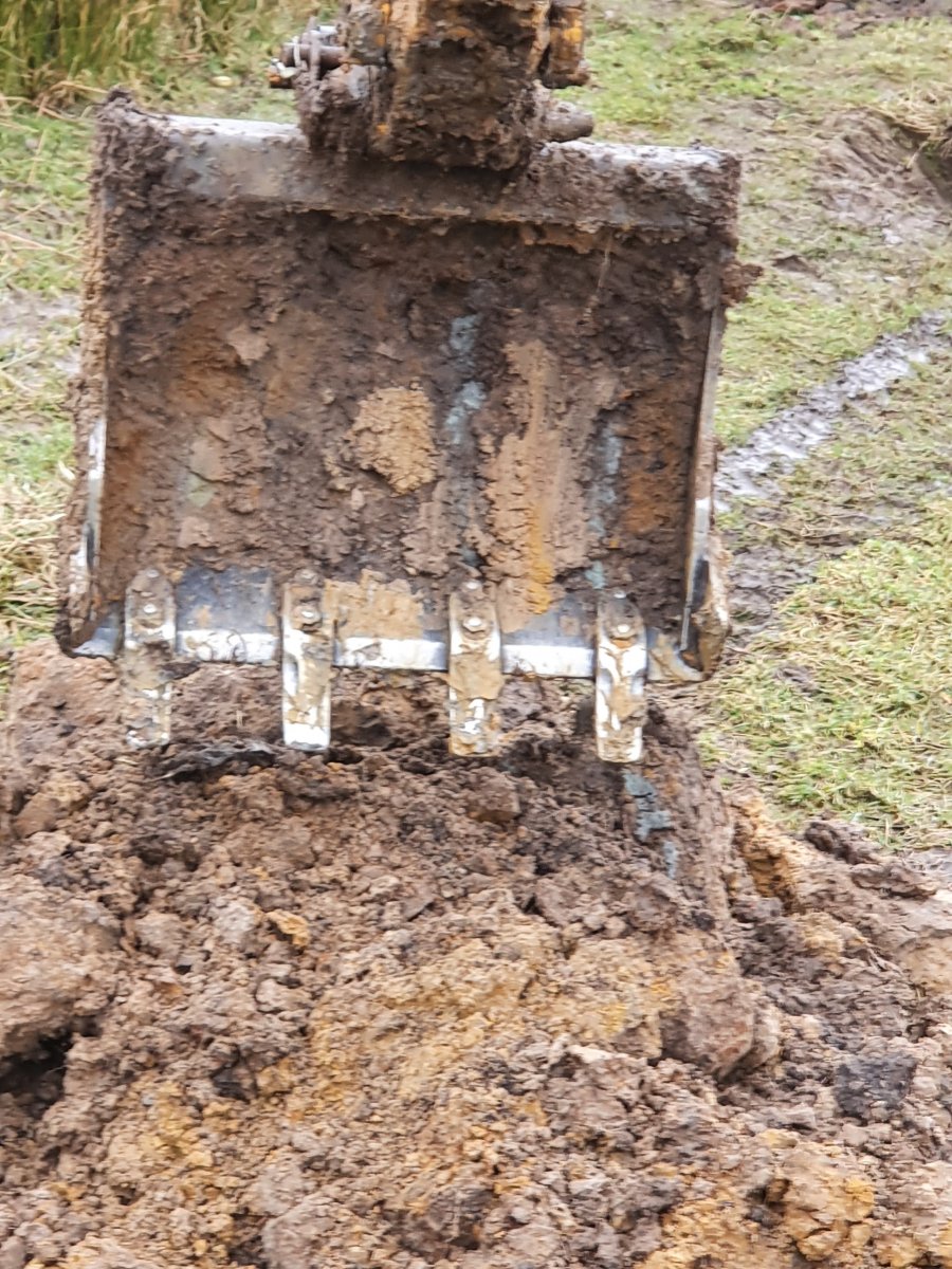

Bloody clay!
You pro operators must curse when you come across this?
I've found the clay bucket thread so will eventually put some chains or cargo straps in there.

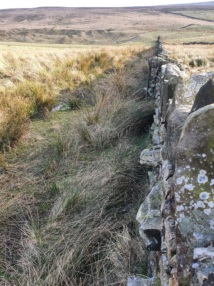

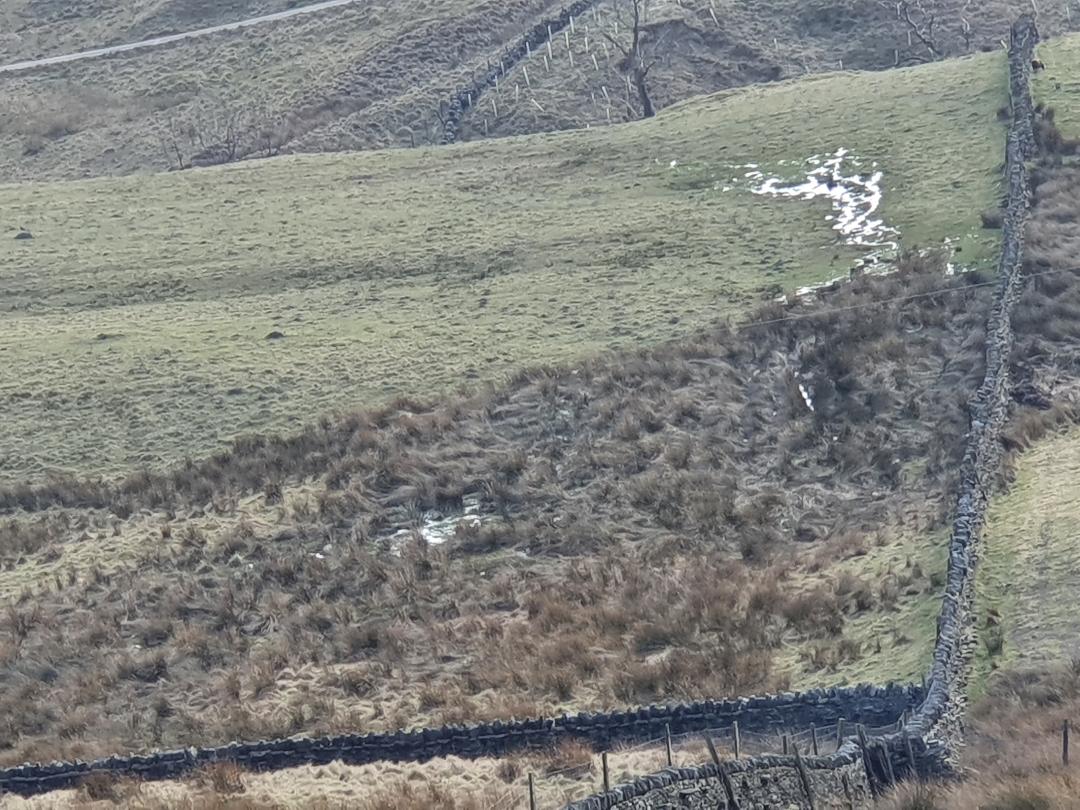

All around the drystone walls are falling down in certain areas. The cause is faulty drainage. The water goes overland, spreads and goes through the walls, washing away the bases and causing the ground to go soft. It's been happening for years and is still happening now which is why i'm using my evenings and weekends to sort it out. Big problem is it's often other peoples fields which are causing the issues and getting them to act is sometimes difficult, my closest A.hole of a neighbour refuses to pay for some £50 bits of pipe even when I said i'd do the work in laying them - on his land! Some people are just rotten to the core and proud of it.
This is another neighbour however, this is a field he rents to the left of our wall:
When you rent you also have to look after it, but he hasn't. The water is supposed to go underground diagonally left to right, under a bridging stone on the dividing wall and run through my land (currently) in a ditch. As you can see it's an almighty mess with water escaping overland over his field when it shouldn't be.
Here you can just about see standing water and the wall is leaning dangerously over to the left in one place:

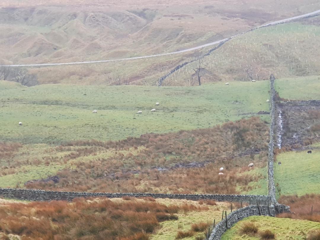

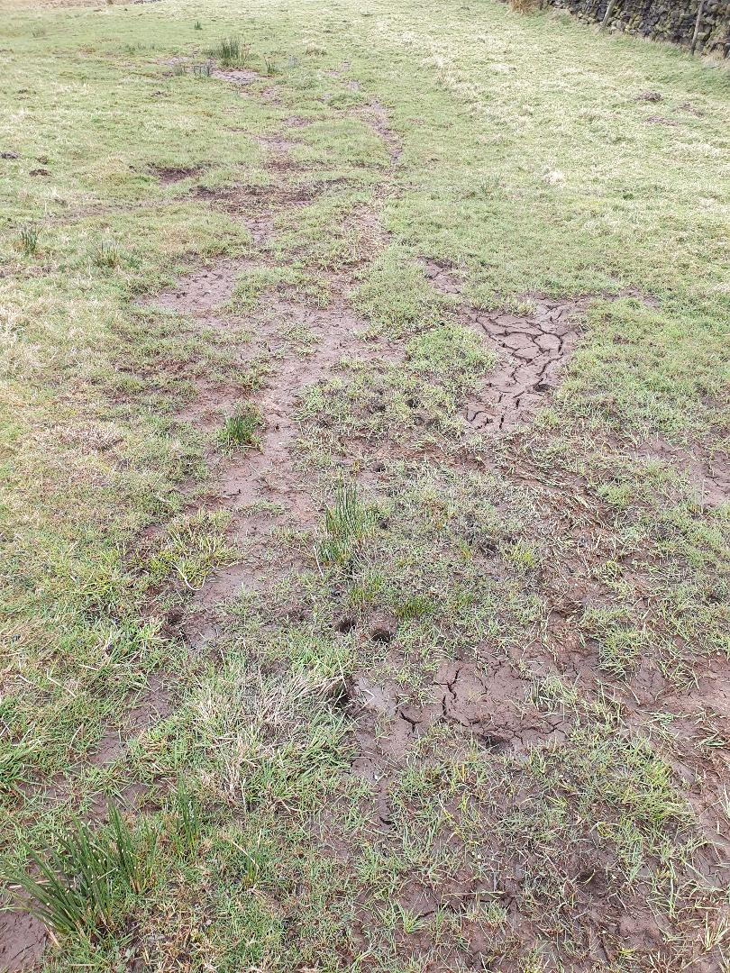

We had words and an on-site meeting, he said he would see what he could do. To his credit a few weeks later he borrowed an excavator and followed my example by unblocking his collapsed soughs. This below is that long streak of overland water a day or two after he'd done the work:

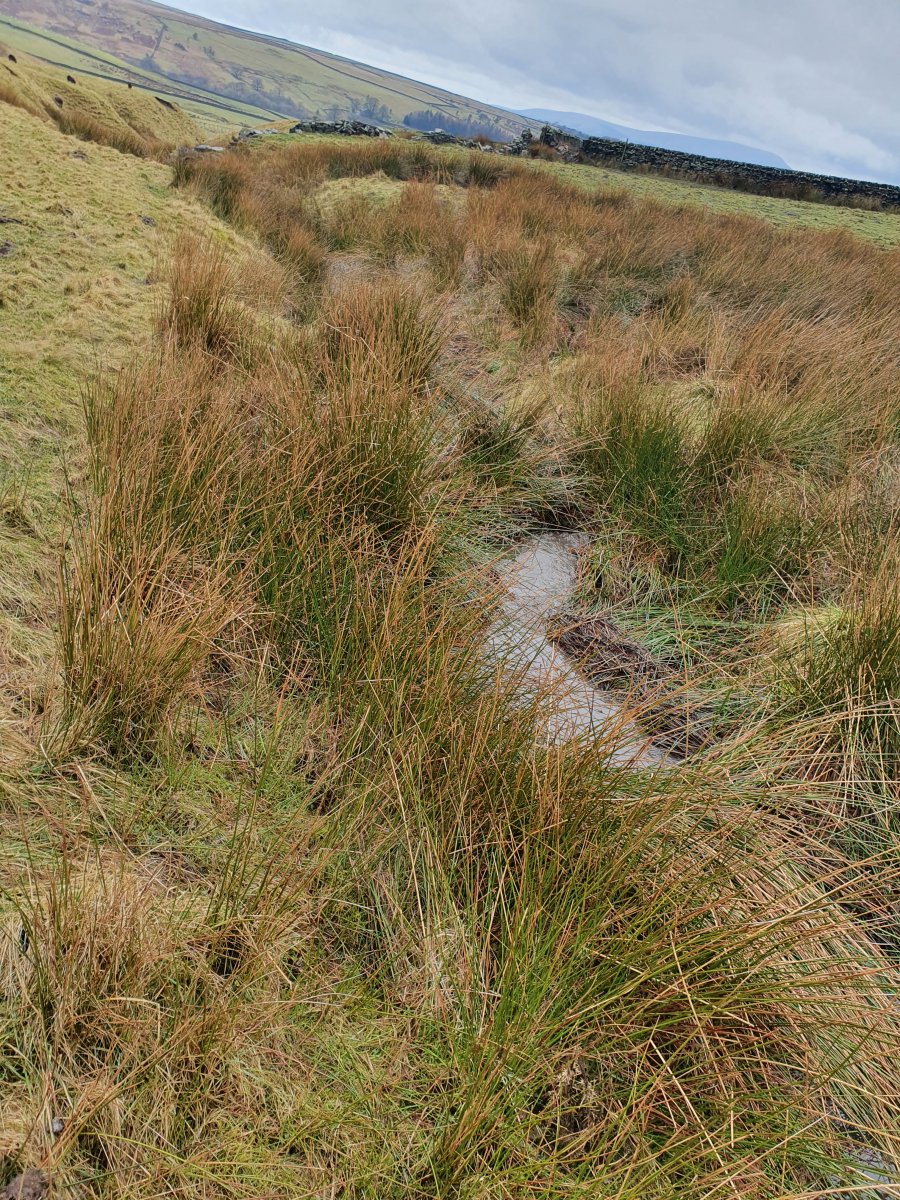

Even after a bit of rain today it looks better:
Instant success :)

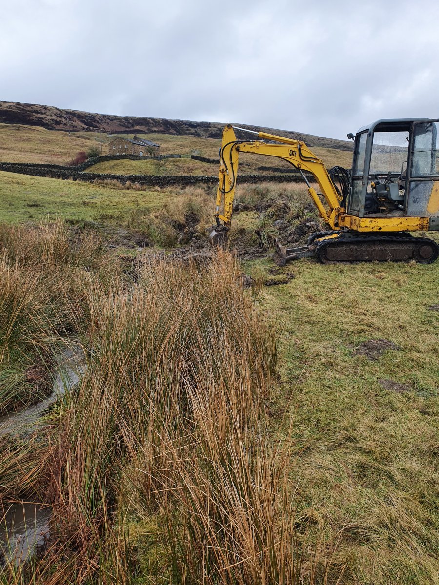

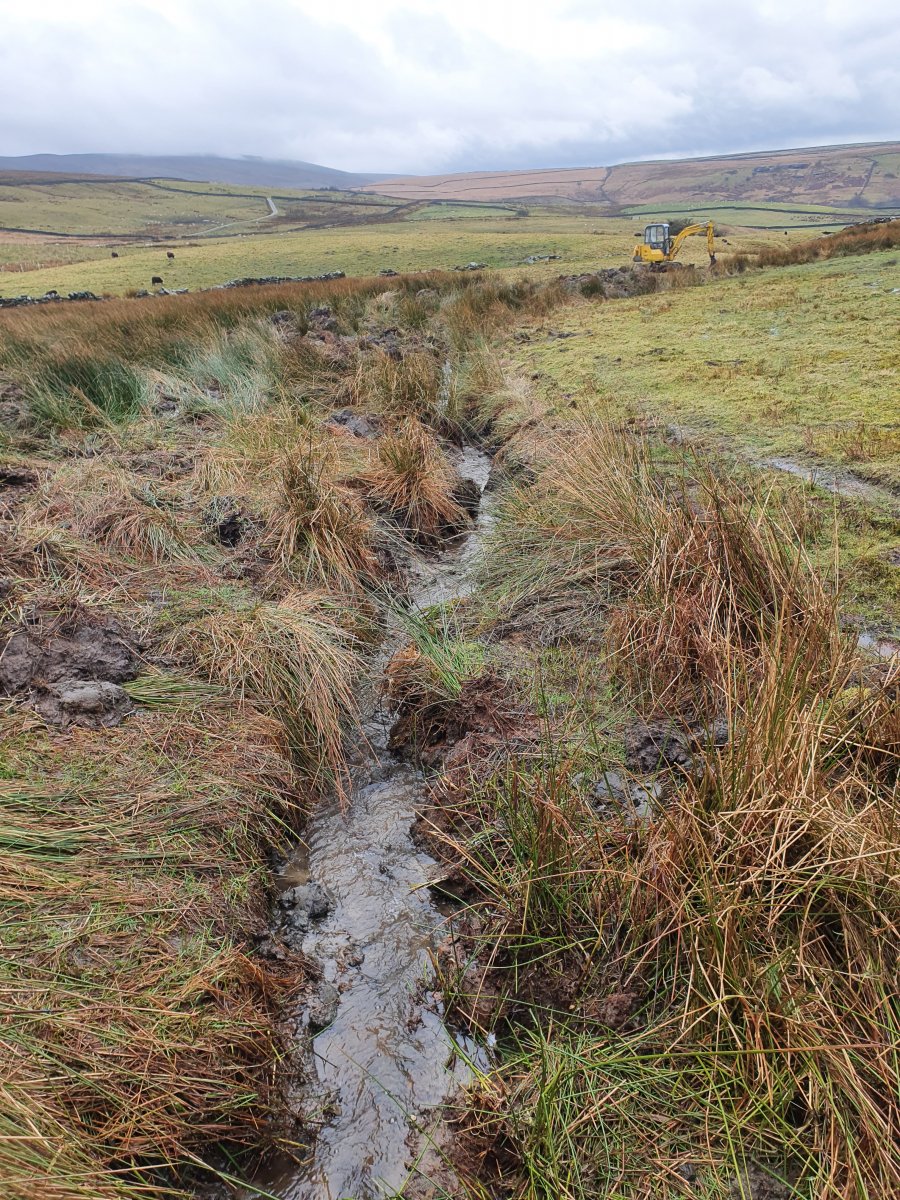

You can see where I put in a ditch to the right of the wall too. I'll keep an eye on that and the land around it, if it's needed in the future it'll stay like that.
I'd previously made sure my side was improved too. It was already running, but was overgrown and with some minor blockages here and there which came to light when it really siled it down.
As far as neat ditchwork is concerned it's crap! I took the wrong bucket with me and have still a lot to learn. It does flow though.
I'll go back in Summer when it's dried out with the ditching bucket and make a better job. Also over time the weather will break down the cack I dragged out and i'll be able to either flatten it out or put it in the dumper and take it elsewhere.

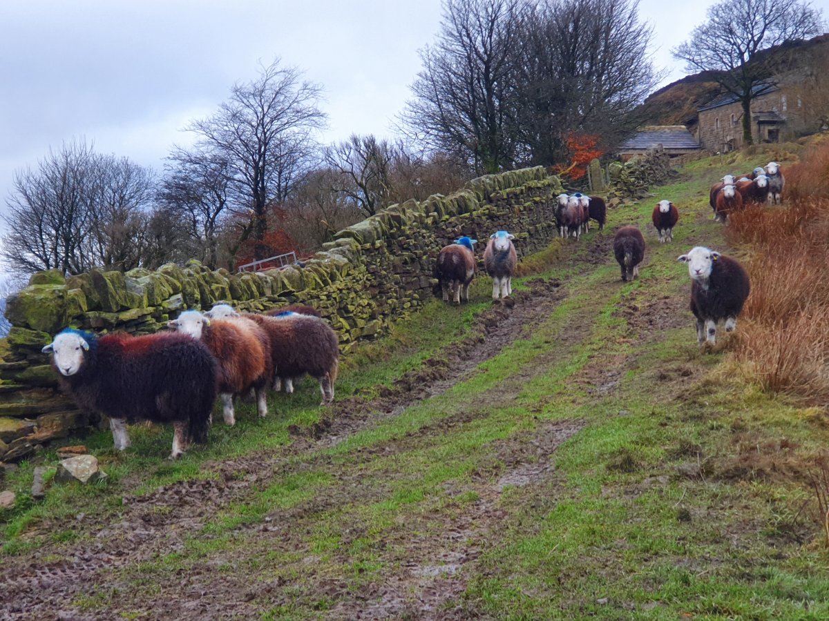

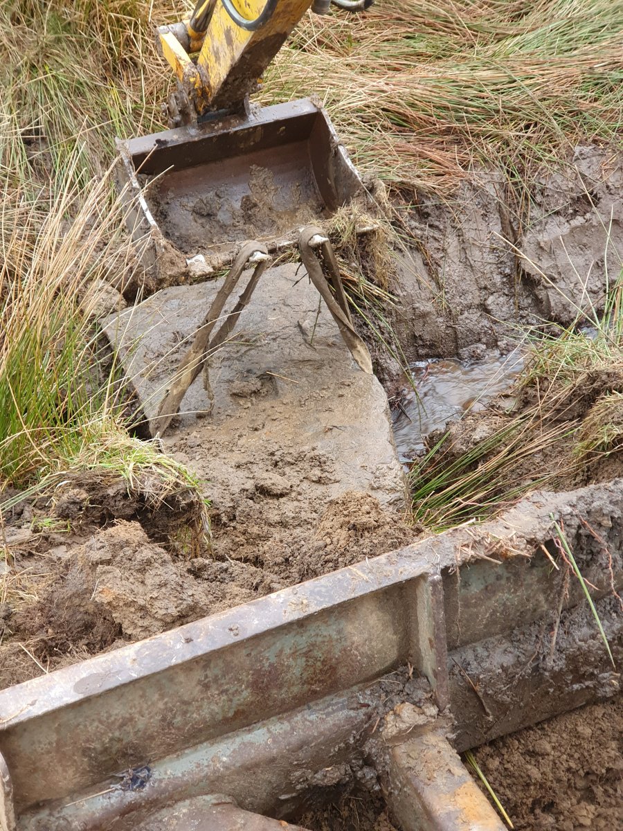

Our fields are rented off to a farmer who puts Herdwicks on there, they sometimes silently approach and quietly watch me work!
As i'd taken out some rubble they were using to get across I thought it only right to put a bridge across for them. Found an old flat gate post lobbed in the field so lowered it down:

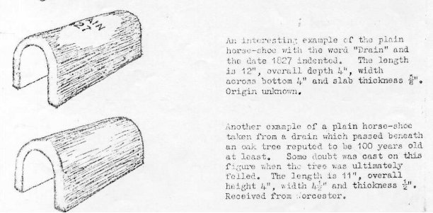

I for one never realised the efforts that went into draining upland ground like that ..... did come across a clay land drain, clearing a ditch here and thought .. Jeez some poor sod had dug a trench to bury that by hand decades ago !!! but those soughs are in a totally different league altogether .... wonder just how old they actually are ??? :unsure::oops:

I believe they are Victorian which makes them circa 150yrs old.
I've heard one of the neighbouring farms has drains put in by POWs, but don't know what kind they are or how they know this. Will find out more one day ;)
