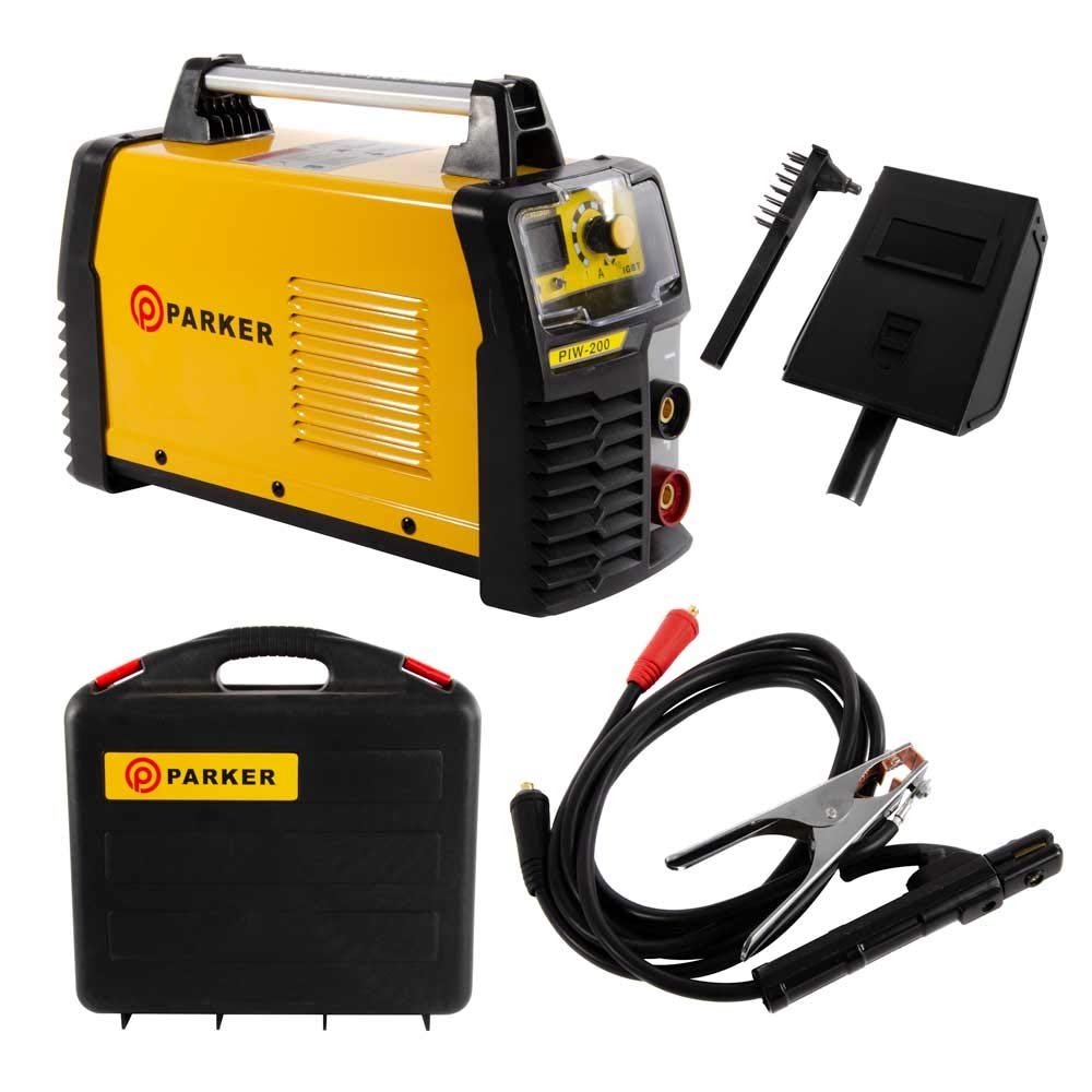

i wouldn't disagree with that but some times it is a case of getting the job done and a nice job or may be he hasten got £350 + to spend on a mig
i got a cheep (£84.00) inverter welder, works grate only bought it for one job but still going strong and works fine on 13amp and burns 4mm rods no problem i am not saying it is in the same league as Rtec and the like but got me out of a hole at the time and for pocket money
unreal price some of this cheap gear these days :rolleyes: if it'll run a 4 mm I'm impressed ..... same as a lot of things I suppose .. throw away society !!

my Esab Caddy runs off 13A, 3 pin socket .. as does the Esab Buddy inverter Ollie acquired earlier this year .... 4mm rods at 60% and 3.25mm rods at 100% duty cycle ..... perfectly adequate for what you need, as it would appear would be Anthony's above .... but a riskier purchase ... my Caddy is well over 20 years old .... TBH I will be surprised if your '150' MIG will put out enough juice to penetrate properly on anything other than spray with 0.6mm wire ..... those lil' MIGs were always wildly optimistic with their output figures

I have a cheep inverter from eBay that runs from a 230v 13Amp supply. Think it’s Italian. Says it’s 130 Amp. Trying to run 4 mm rod is a bit optimistic for it but it runs 3mm very well.
A few beads with 3mm rods on a well prepared joint and 8mm box will be well and truly glued in place and with a bit of practice the welds should be able to be made to look respectable.
