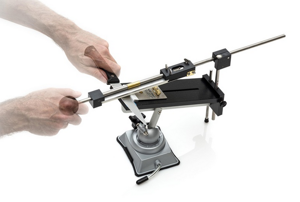

I use a knock-off of this kit to get a consistent profile the full length of the blade which can then be maintained with a steel until you want to true it up again
useful comments about choosing the "correct" angle.

I like the look of the fixed angle setup.

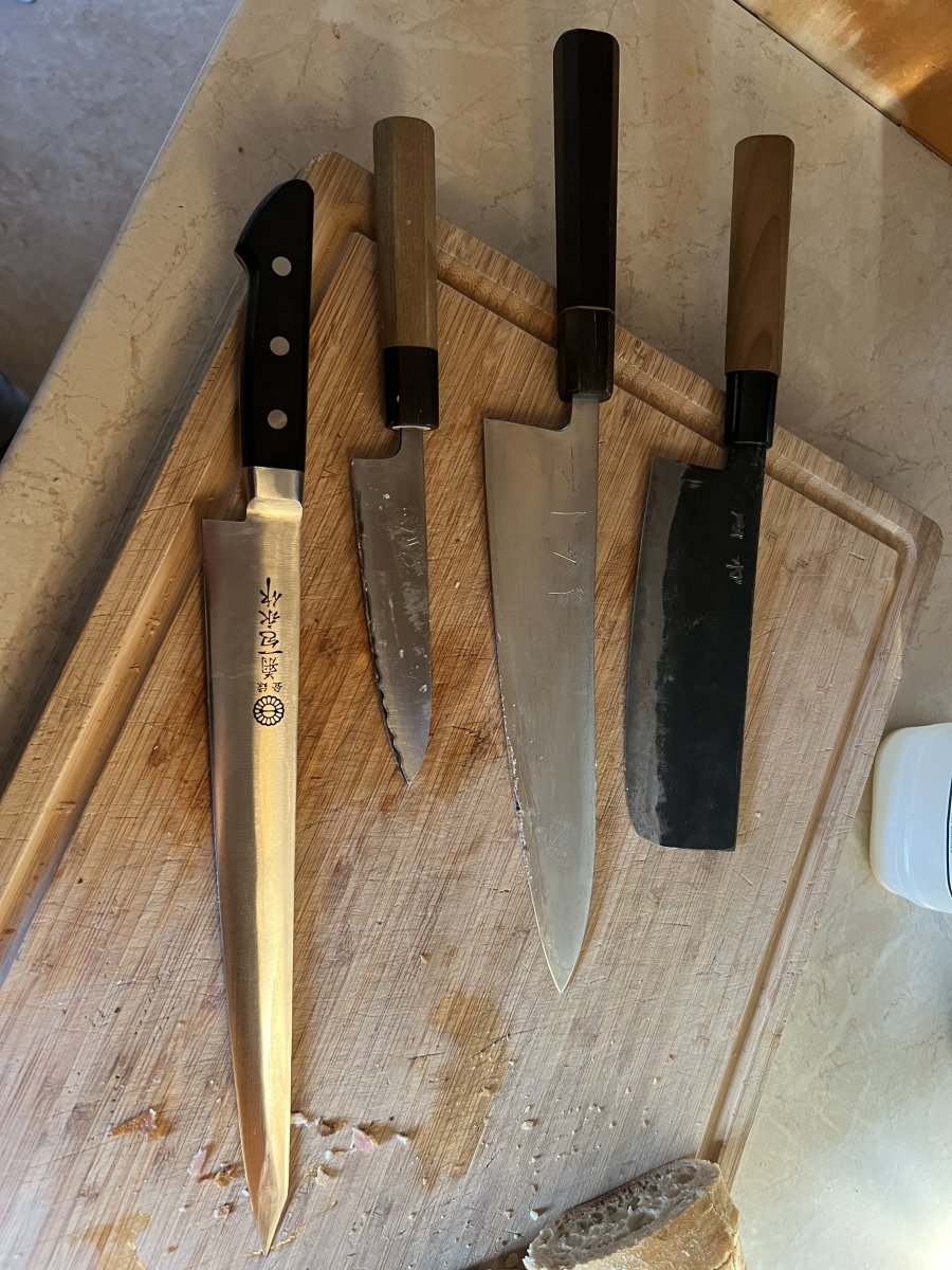

I keep my Japanese knifes razor sharp so much so no one else is allowed to use them or wash them. Have a Japanese whetstone kept immersed that’s 400/1000 give them a Sunday tune up on the 1000 and strop . The slicer is lethal sharp

A bit of googling suggests 25° for chisels/plane and the link above 20° for kitchen knives. Does anyone use a jig for chisels and plane?
