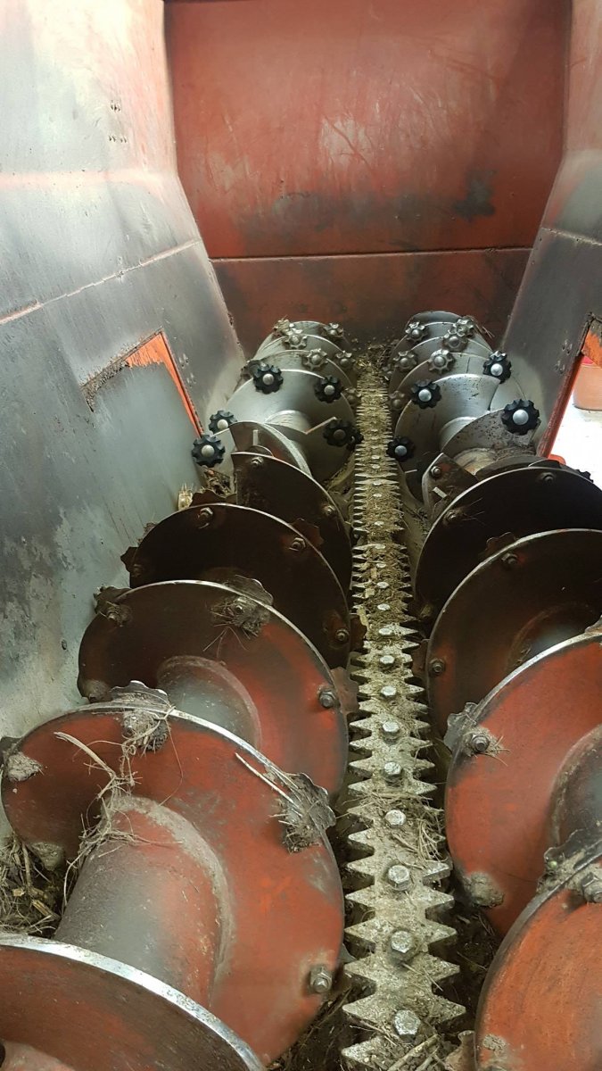

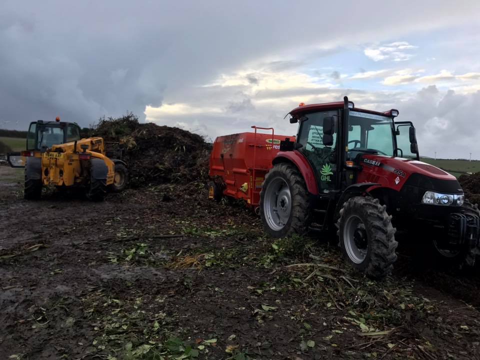

A landscaper that uses us has a tumble grinder that goes on a tractor and grinds up green waste pallets and smallish stumps end product is turn over a few times then screened and sold as soil conditioner
Grahams
Grahams
A good way to go. Making money out of what was rubbish that would be a cost to get rid of. Yes setup meant initial outlay, but if the figures stack up it is another income stream and is a tick in the green box for recycling was which goes down well with government organisations.

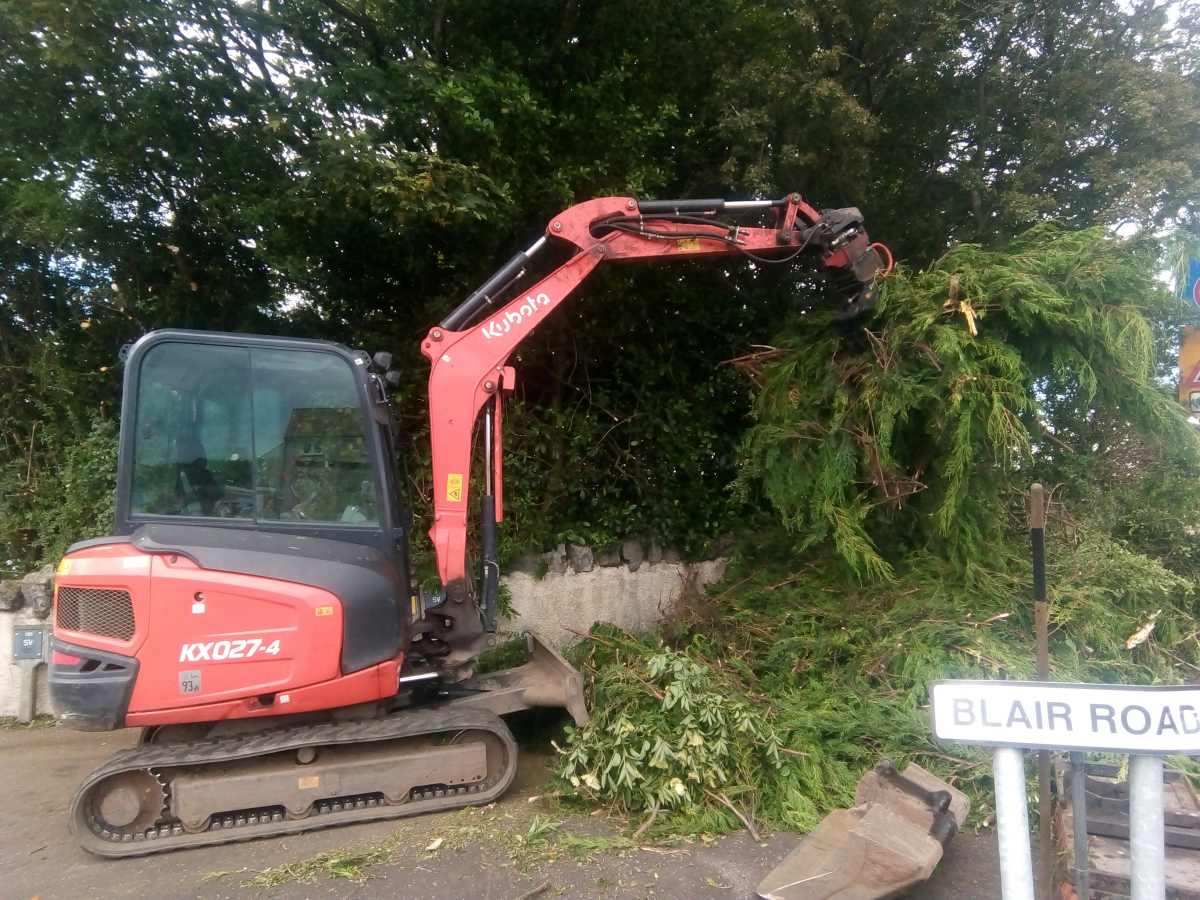

do we think the 50kg per hour is some thing you would have to stick to if so would not be a lot of good i have emailed the company for more info
did a job yesterday filed a 7 ton dump trailer with hedge cuttings mainly laylandi at 50 kg per hour thats 140 hours
did a job yesterday filed a 7 ton dump trailer with hedge cuttings mainly laylandi at 50 kg per hour thats 140 hours View attachment 7292
could that not all be shredded ? the guy I spoke of above gets loads of that sort of thing every day

The tumble grinder above is ok as long as you don't put logs or stones through it the high speed shredders will handle small logs and have interchangeable hammers to allow the to produce graded biomass chip from whole trees and the slow spread ones can chew just about anything lumps of metal the lot

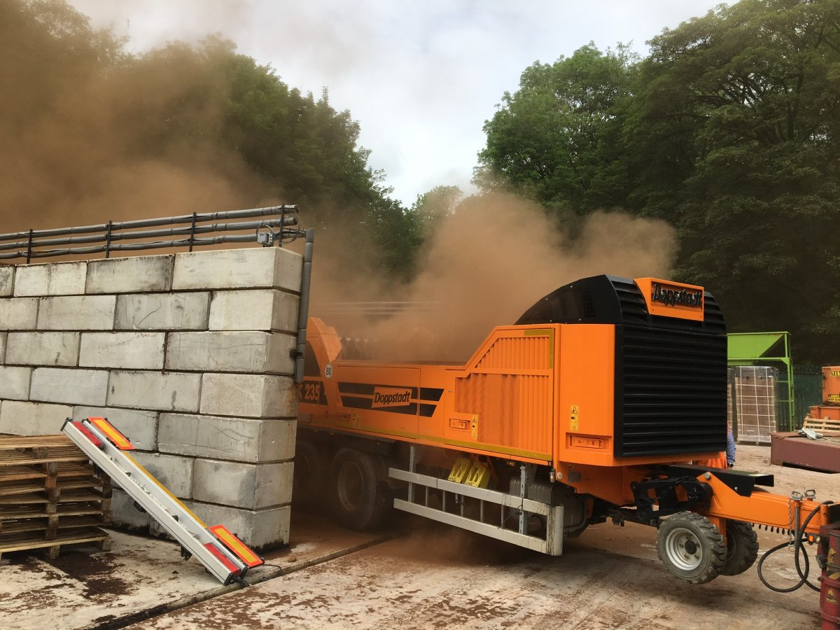

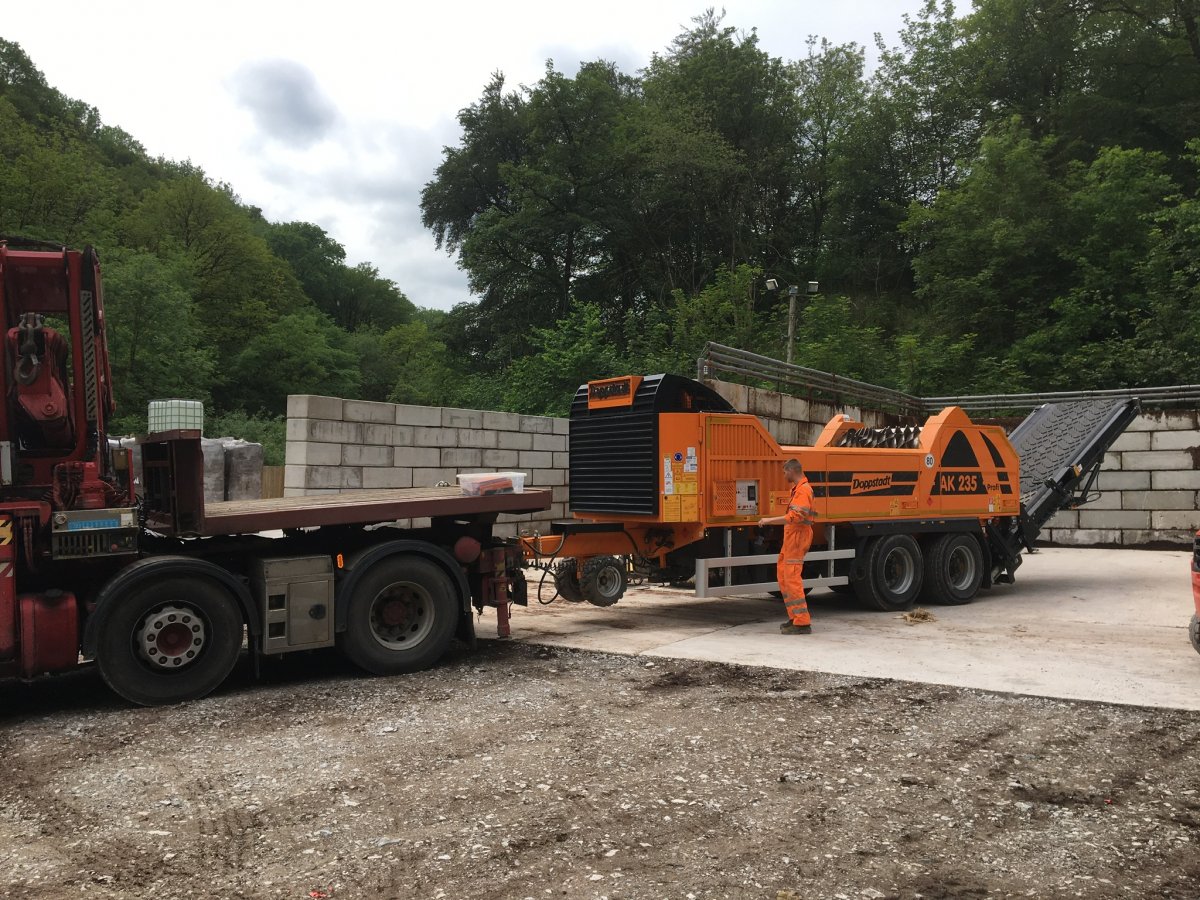

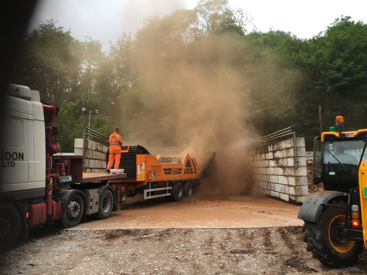

Took this small one for a demo today only weighs 15 tonnes
Took 2 hours to turn 20 tonnes of coconut husk blocks into a powder
Was a bit dusty until we got some water spraying in the drum
