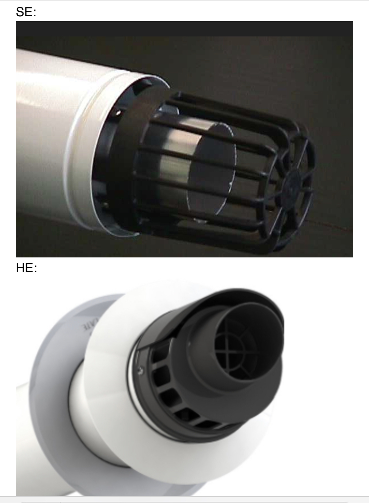

That flue doesn’t look right to me, looks like standard efficiency one not condensing version?

I’m pretty sure that flue is for a standard efficiency boiler (no longer allowed to be fitted), and has a metal internal flue section. Using this on a condensing boiler will mean the acidic condensate will rot the internal metal section out, then the external one! It would be worth checking as the consequences could be lethal!

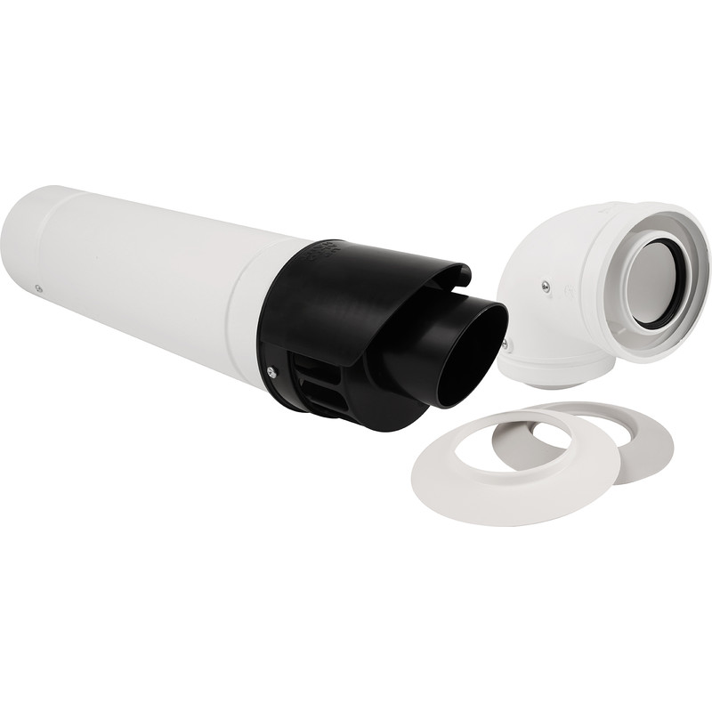

I think this is the correct one...

The issue of the wrong flue is understood and will be addressed ASAP.
Thanks for showing me the correct plastic one.

Regarding the replacement flue kit, I can get this in ready for the engineer to fit.
Do you have a preferred supplier? (Not Toolstation who sell the boilers and send out flue kits without the 90 bend!!)
