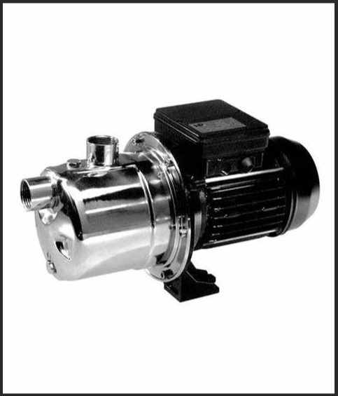

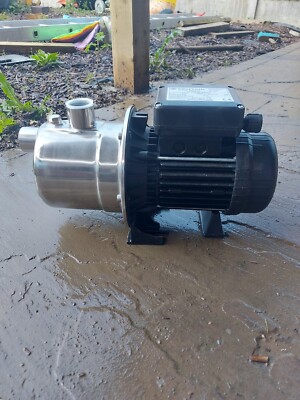

will be pretty much the same sort of set up as I have here at a guess .... assume tap will be just std domestic type thing?

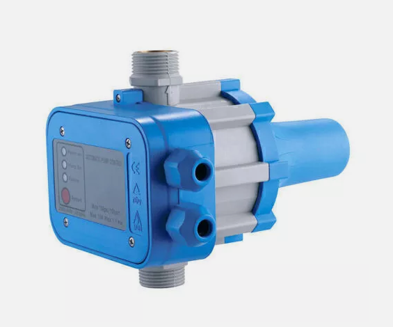

I have a Nocchi jet inox (potable S/Steel pump) with a pressure switch on the outlet of the pump with a non return valve built into it - that controls the pump motor - knocks off when system is at 1.5bar .. open the tap and it switches on as the pressure in the system drops .... also have an expansion vessel tee-ed in to 'smooth' the pump's cycling, if tap is on/off/on/off a lot

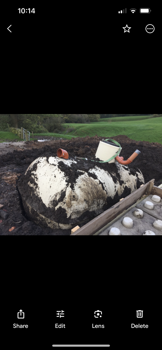

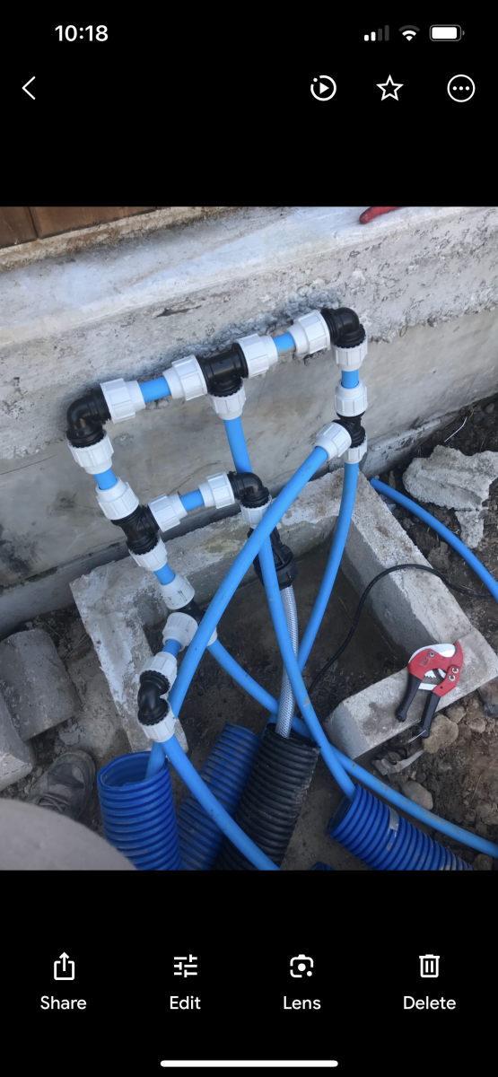

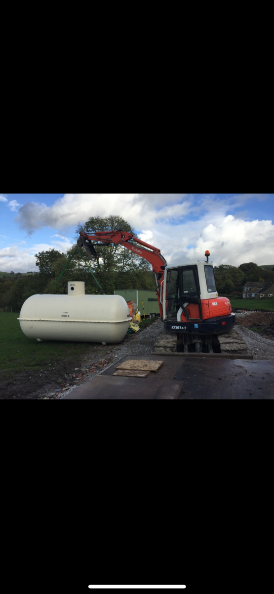

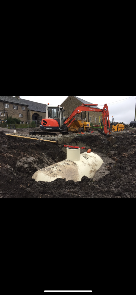

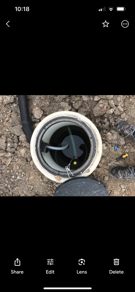

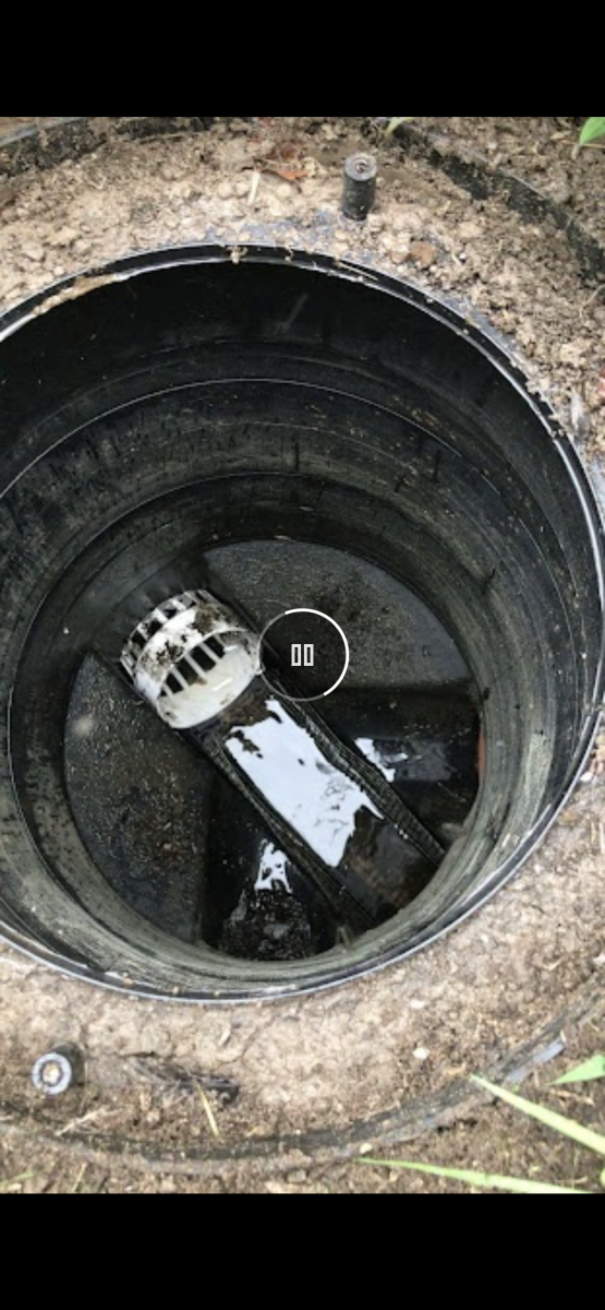

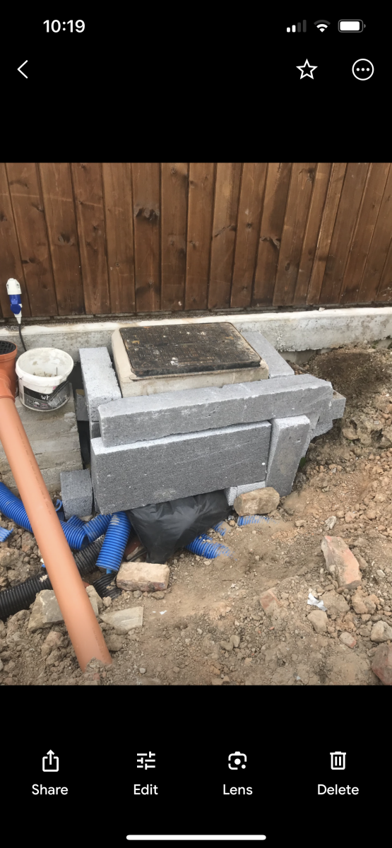

Basically I’d priced a £150k full 14 stable yard and yard redo, I’d not seen the specifics on the rainwater harvesting on requiring 2 on demand taps from it. So had to do a system for the £6k I had in the budget for in my mind was just a tank.
Tank was only £2500 installed it filled it with water didbt put a drain in then few days later tested the pump which had a float so pickup always 4” from surface to avoid scum etc in tank.
Lads used all the water in tank for wash off and mixing had a wet weekend before tank was connected to drains and it emerged like a Russian submarine when we arrived Monday morning lol 😂
So lifted it out re dug it and installed a deep land drain and re installed with more concrete and made sure pump was removed so lads had to use hosepipe from farm house 100m away.
Had to design it and install it myself so bit of research and trial and error got it working feeding two 3/4 taps. Takes 700m2 roof watershed but no ground drainage. Had an overflow to drain.
Made a crude filter in inspection chamber leading into it but nature of pump means it’s resilient to crap.
50mm hose comes off pump into union then goes to the two taps and two auto level concrete troughs
Filled the inside of the chamber with 50mm celotex and rock wool

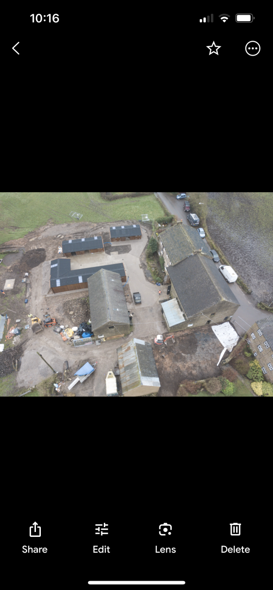

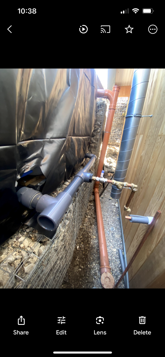

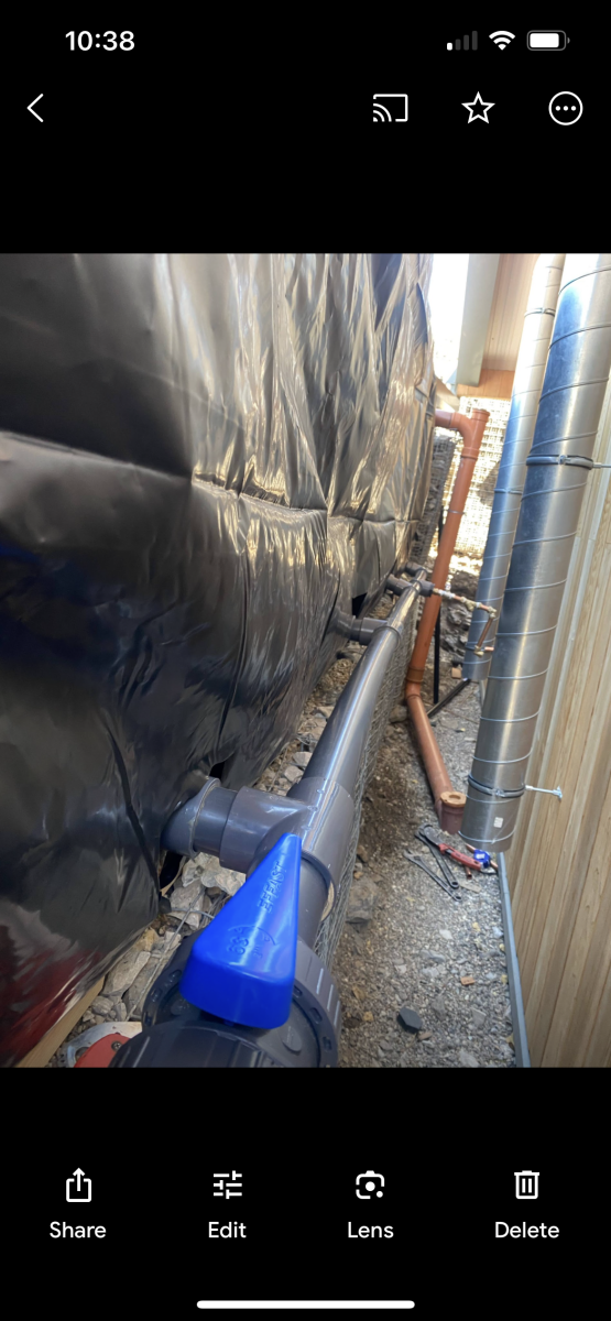

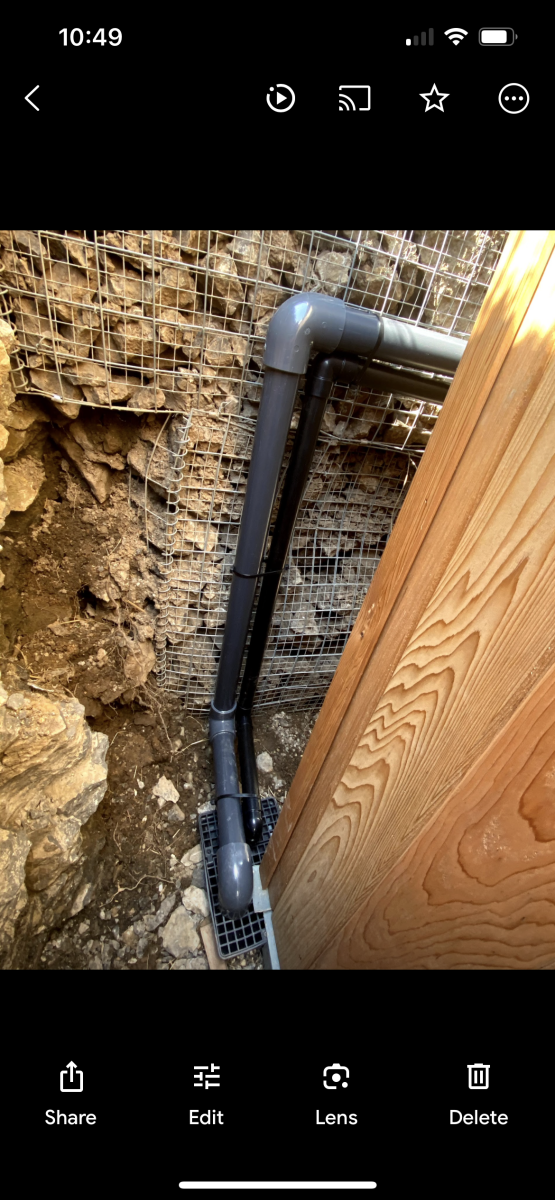

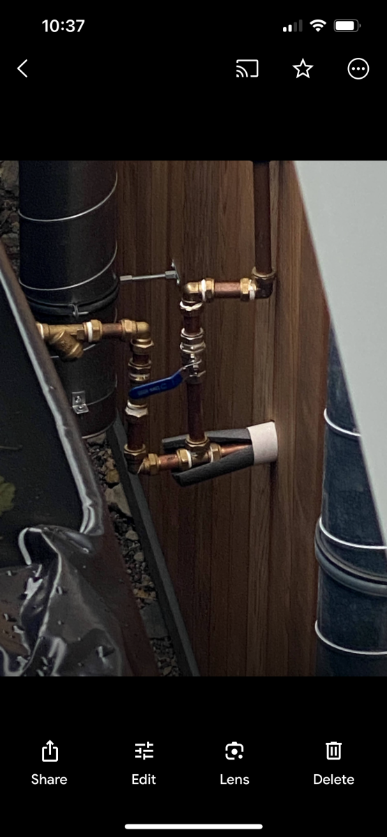

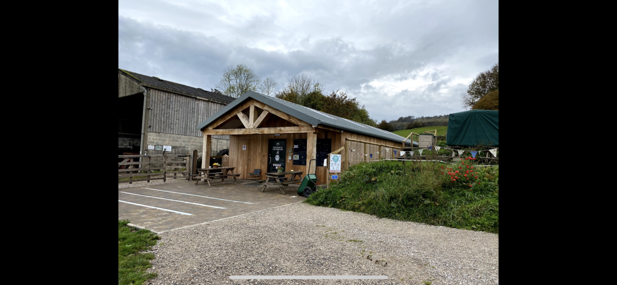

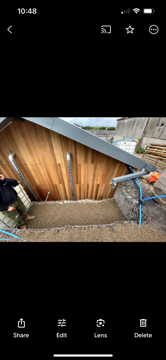

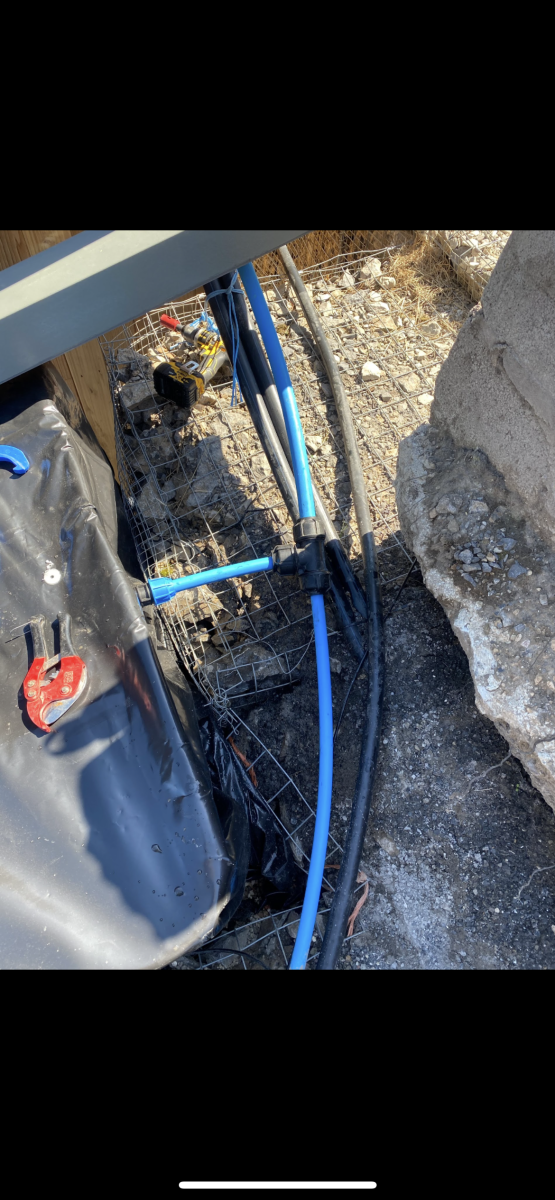

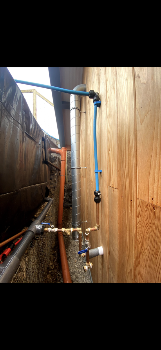

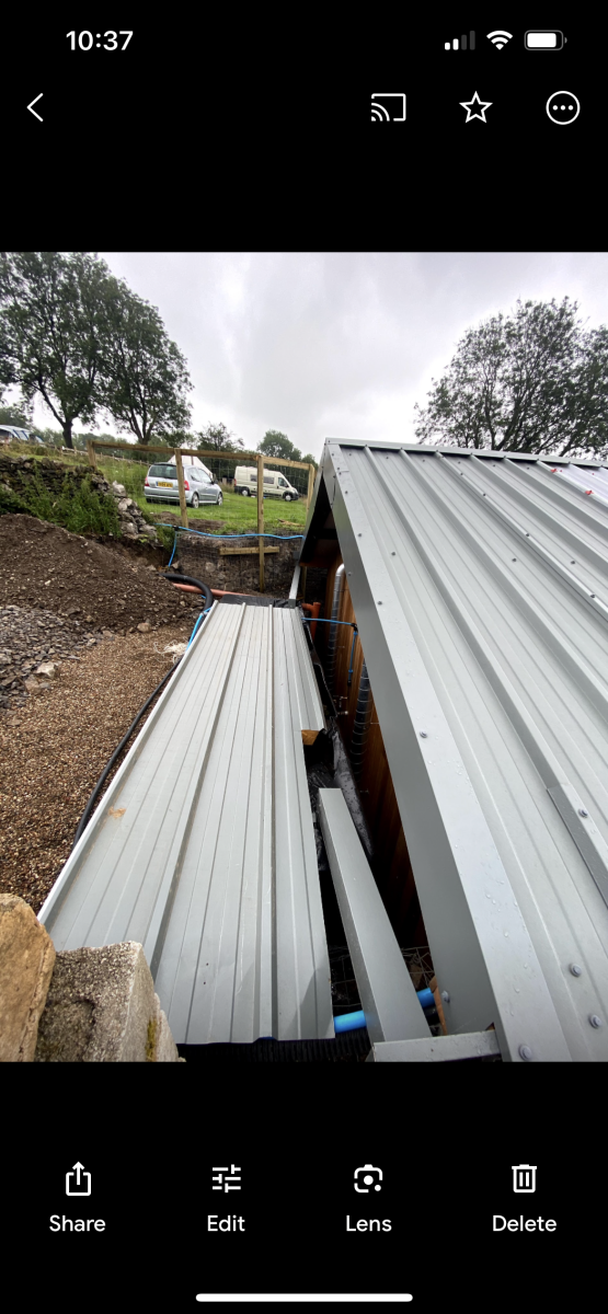

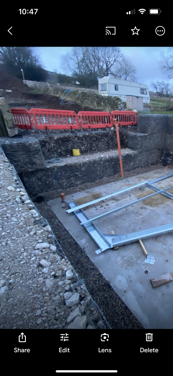

This was a trickier one, we built this 20m x 8m welfare block for a camp site had 7 toilets they wanted to flush with roof water. Had 4 ibc wrapped in plastic, I interconnected them, then a filter then into toilet feeds with only like 300mm head,
Put a float valve into 1 tank to control level off mains and later added a 15mm feed off it into the feed in just to give it some pressure as the cisterns took to long to fill. Was a big ask on no budget again to feed 7 toilets in busy camp site. Needed a pump etc.
Again self designed self installed system still working. Had primary mesh filters on gutters then Geotextile bag filters then inline filter
Would do it differently now but was making it up and learning as I went
Was a bugger to work on no room
Put in bypass in 3” to dump all tanks to drain
And built in space for ibc in solid rock dig out

Few reasons but frost proofing it, easy of priming, ease of installation etc
