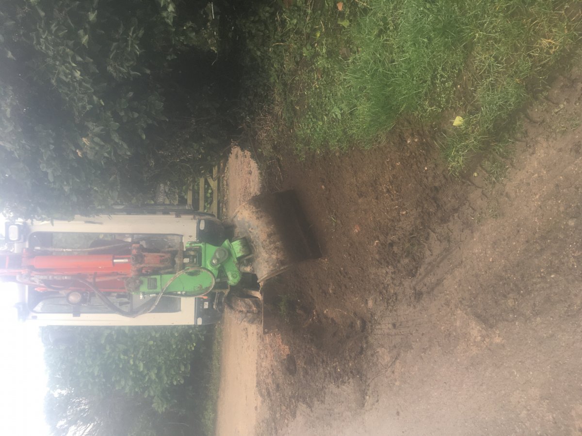

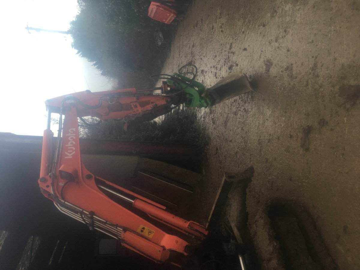

My tilt hitch, not as bendy as yours Rory.😏
@Hg2702 you prick the pins don't match :ROFLMAO:

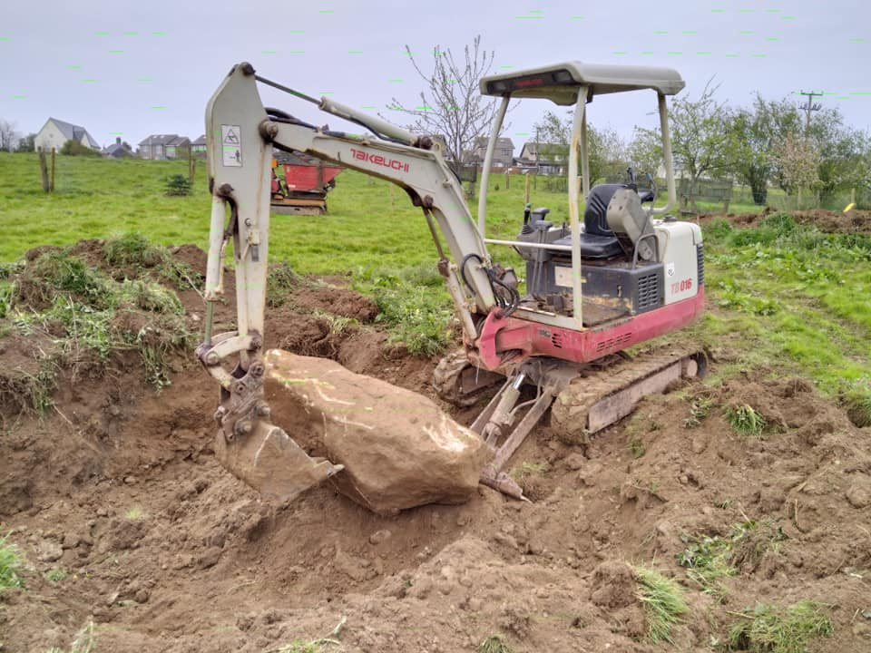

Oh and a Pond....
And a Stone.... the 200 series are s**t.... I rest my case.

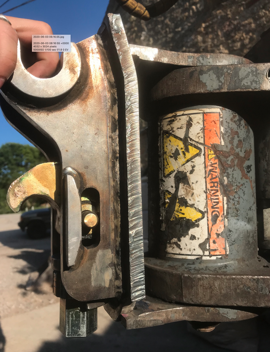

Cut that crappy semi Q/H off. BMC will supply you with a screw type hitch plate that you can weld on. A massive improvement, keeping the pins tight. Speak to Robert Welsh, he's a true gent and couldn't be more helpful. The backing plate it comes with is pretty damn close, it's an easy fit. Then you can use that new impact wrench to tighten it.
Around £300 from memory, it's great. You have to adapt or remove the safety pin that locks the screw as it's in the way of the Helac unit, but I'm sure that won't bother a man of your standing standards! :ROFLMAO:

No, no to s**t screw type hitches. If I was over worried about tightness I'd be going hydraulic but I'm not.
What’s s**t about it? It’s a perfect soloution.
My wedge lock on my 3 tonner seems to work undone after an hour or two. Not enough to let go of the bucket but certainly enough to give it enough slop to put it on par with a spring hitch.
