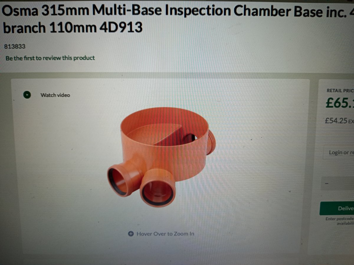

Proposed drainage connection.

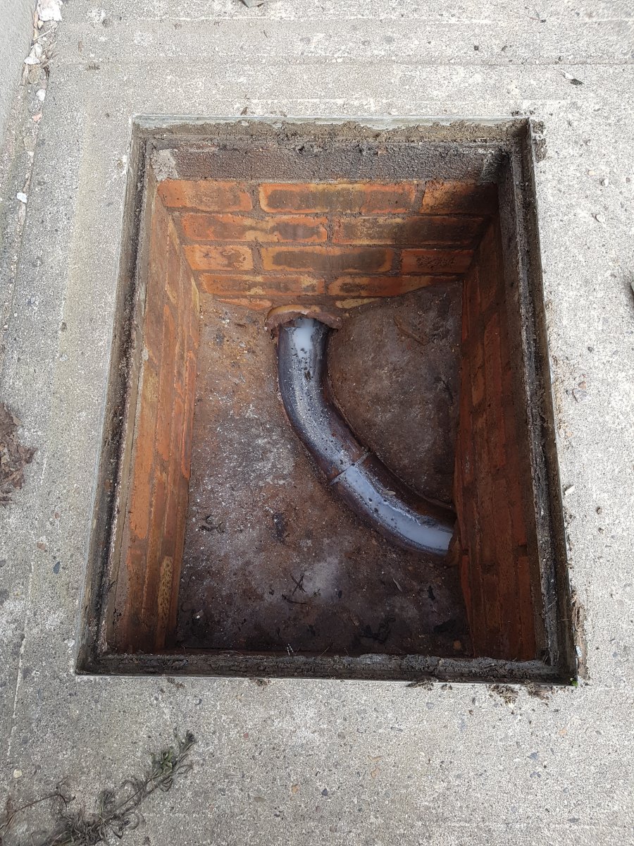

The rubber connectors can leave a lip between the clay and the plastic but if you cut a slither of 4 inch plastic and put it around the outside of the plastic pipe it is enough to make the inverts perfectly flush and will also still seal
Will have to give this a go, always dubious that they're lined up properly. Plus means even less pipe waste 😏
