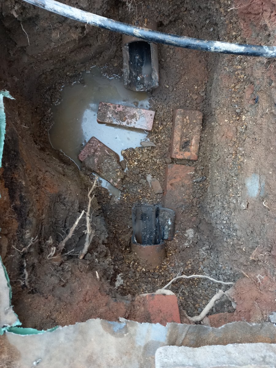

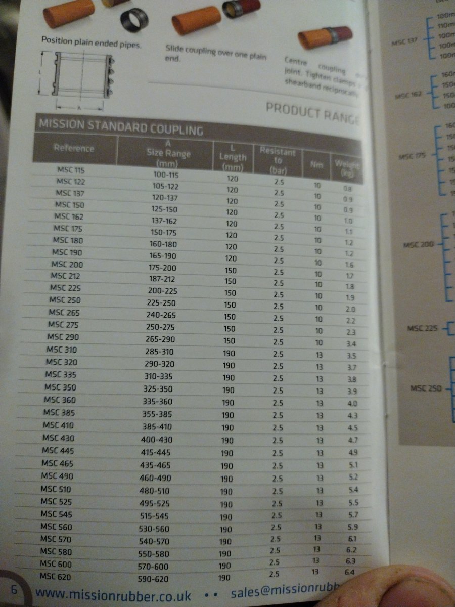

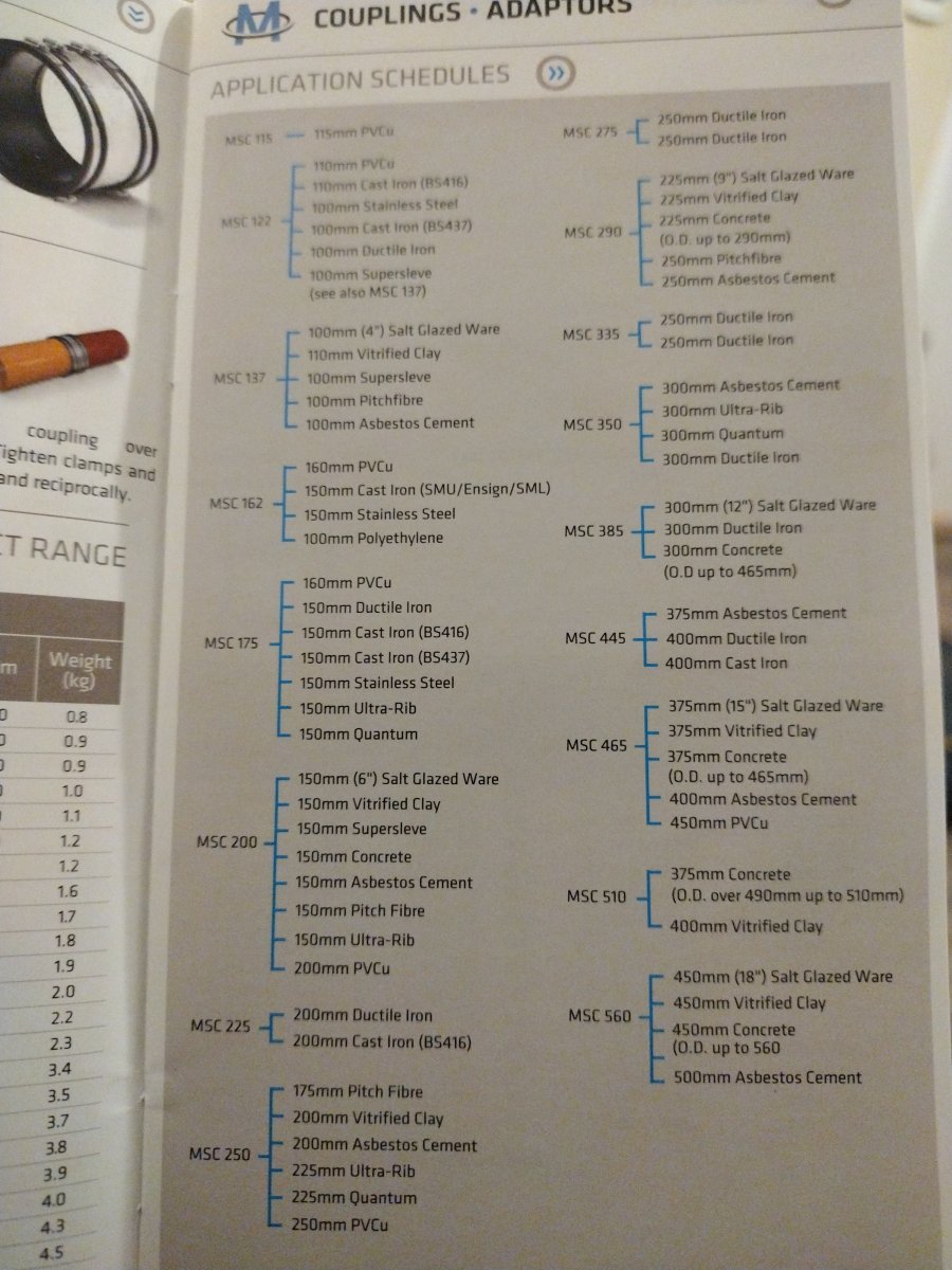

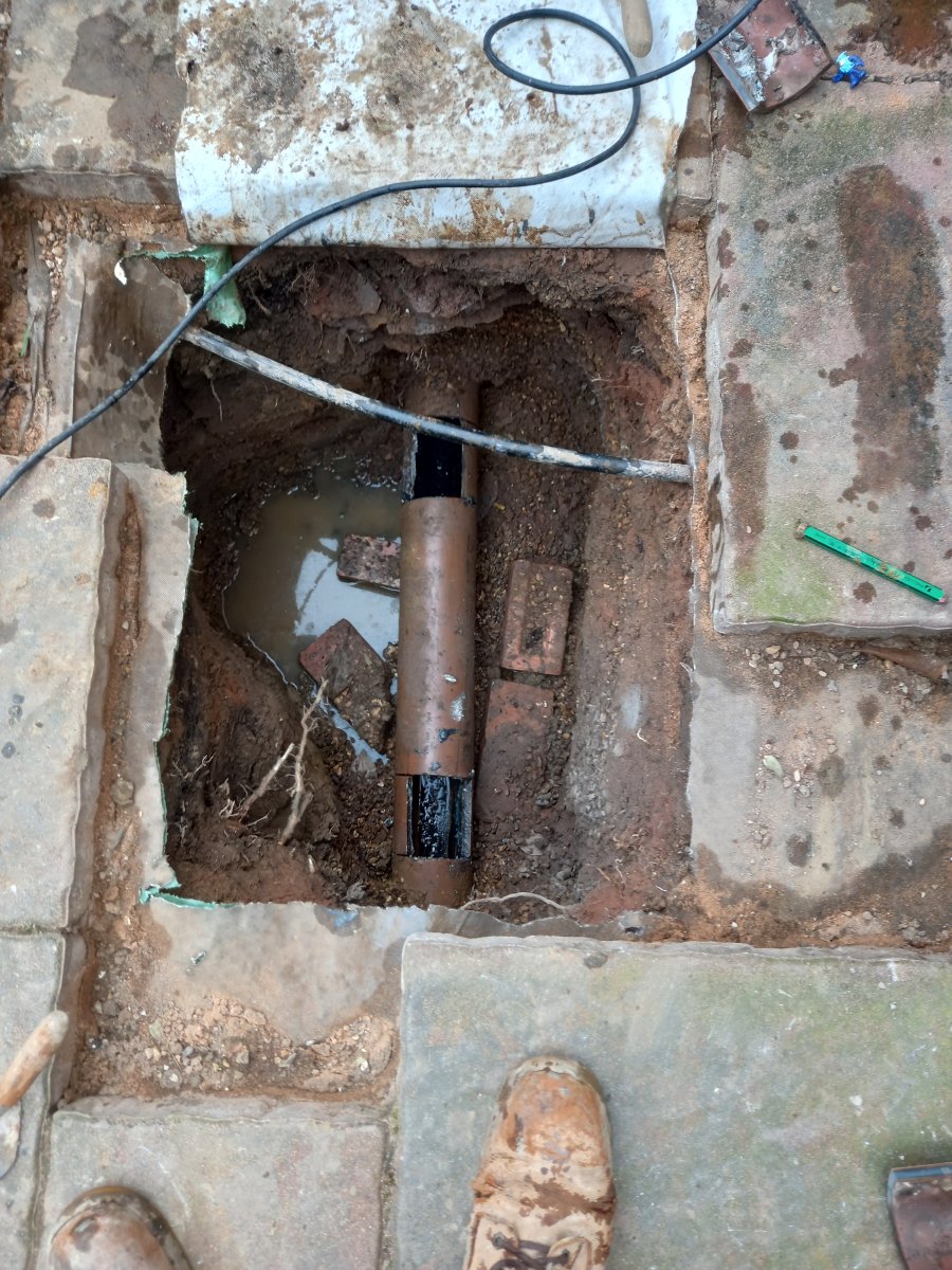

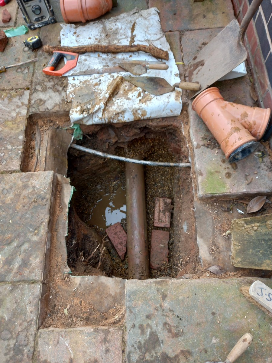

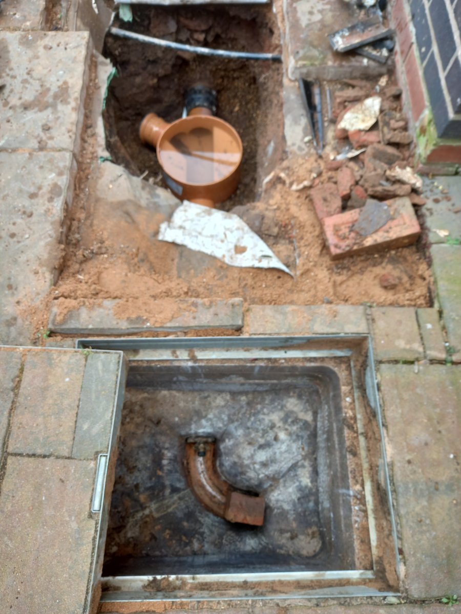

Just dug it out gonna go fetch the gear existing pipe is supersleeve 4" what is that 122mm external? Its a different flex band to the standard clay saltglaze one?
helluva root :oops:

That's not that old supersleave you should be able to get fittings for that .
supersleve was nice stuff to use i always thought, the pipes were gun barrel straight a bit more harder to use than plastic but a better job all around. mind i wasnt paying for it though, it was a fair bit lighter than hepsleve or naylor clay pipe.

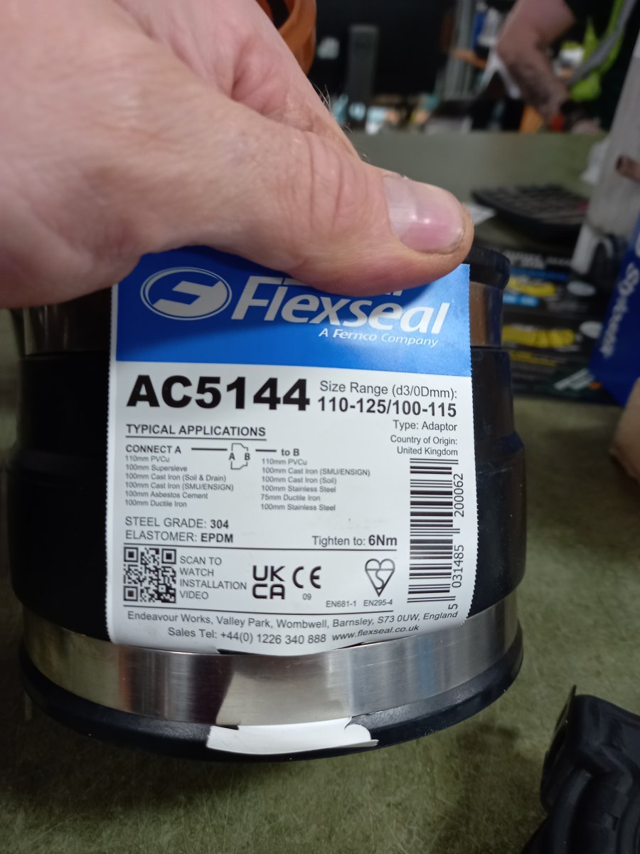

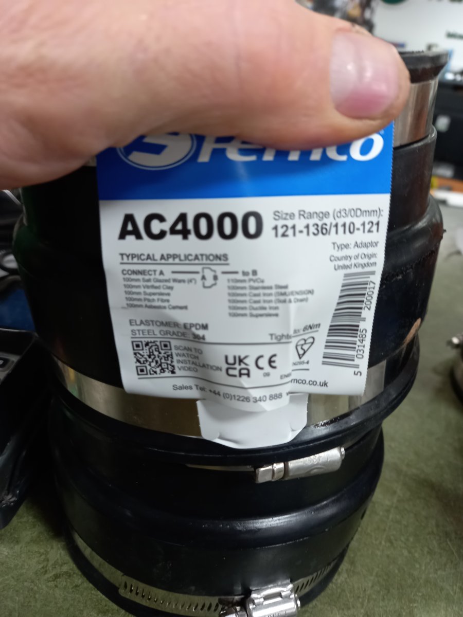

Went with the smaller one i think both were suitable but there was so much slack on the big one.

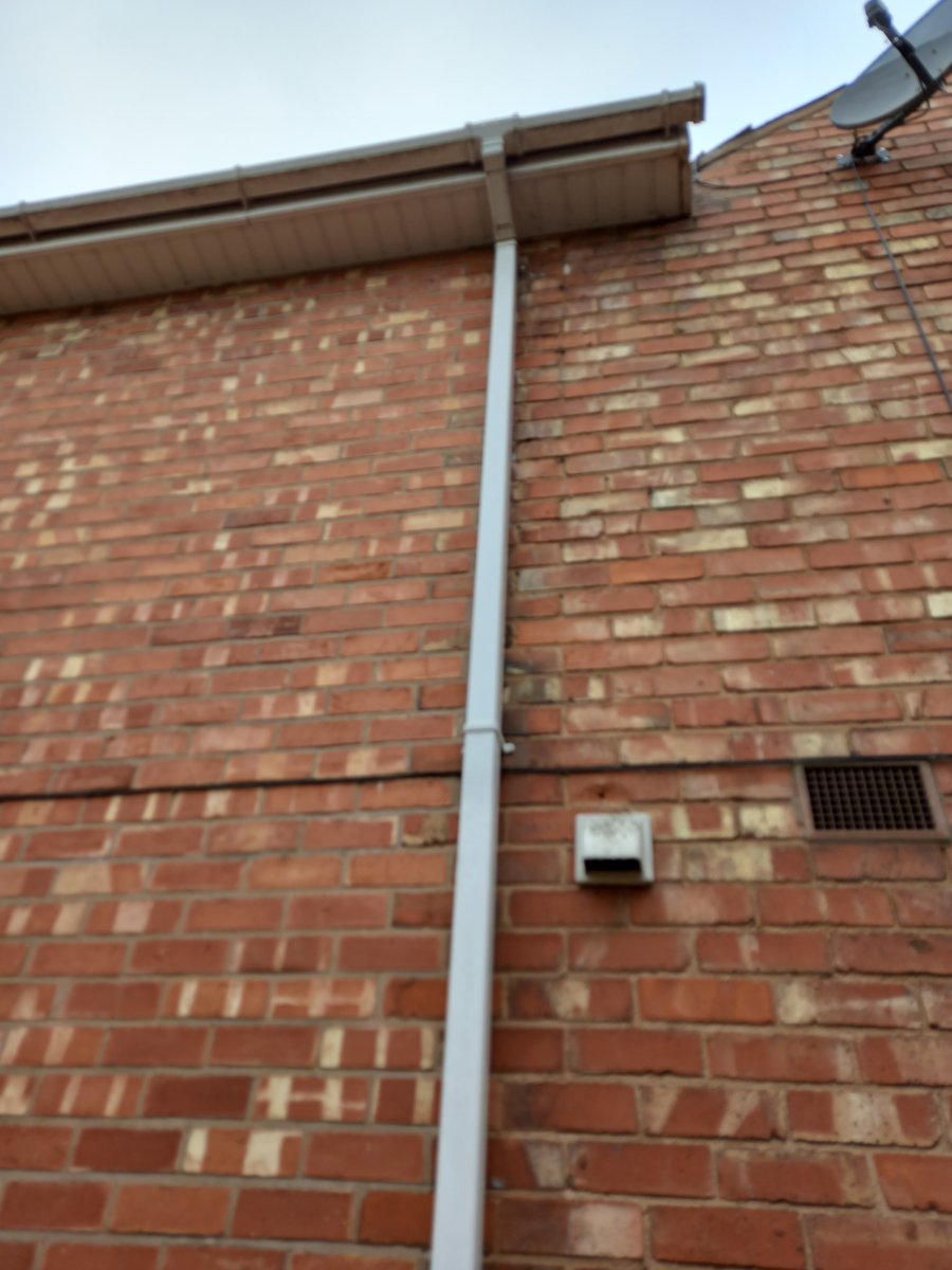

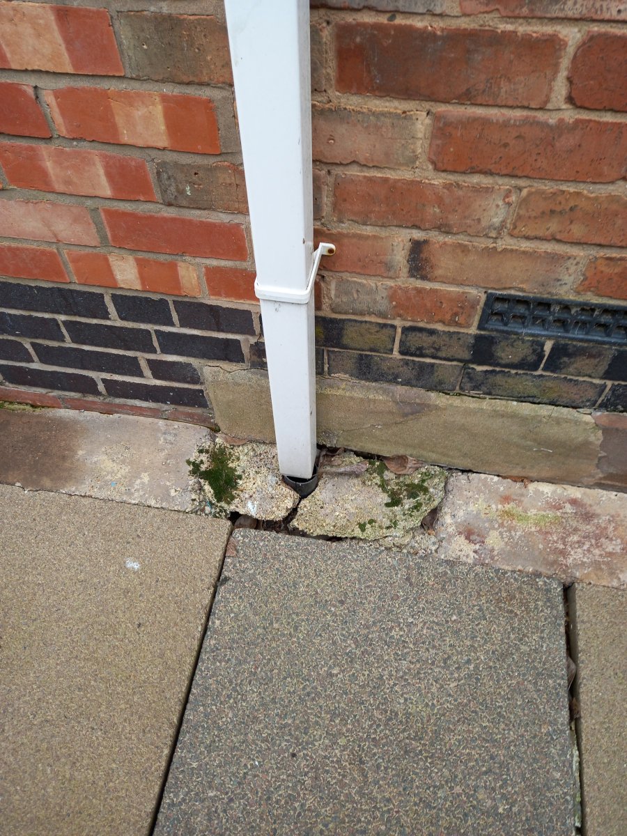

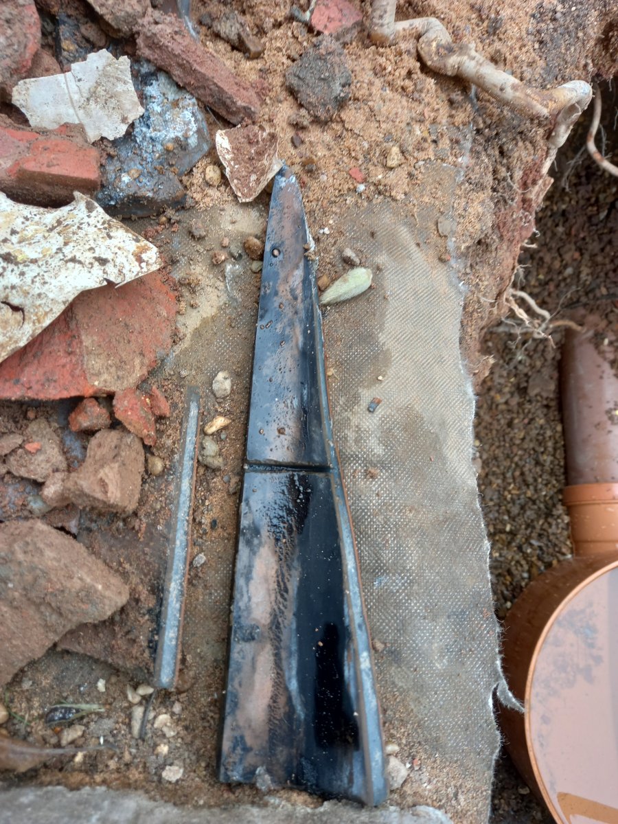

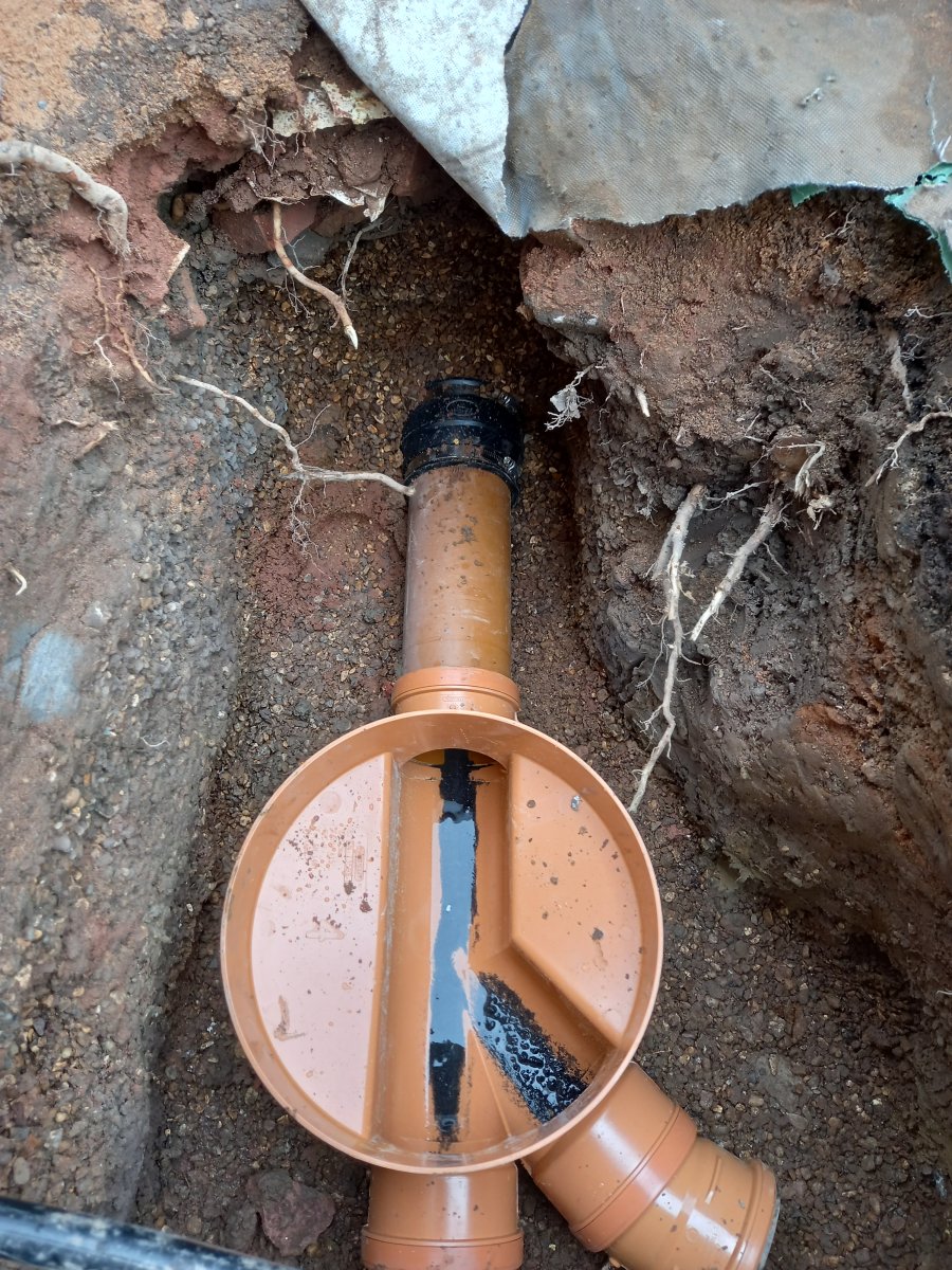

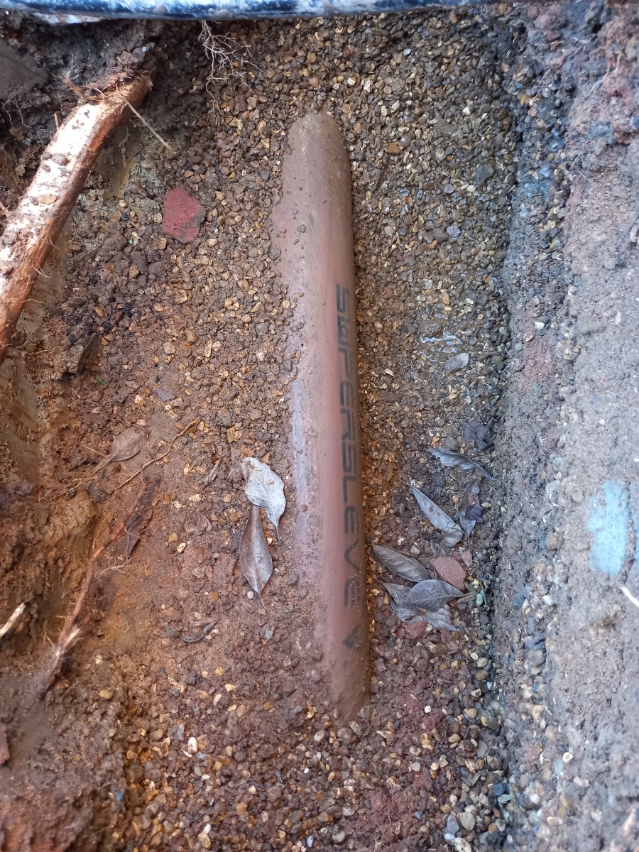

Well made the connection this morning was a right pita. As well as the pipe nearly being full of black sludge i had to push out (only grey water upstream) that supersleeve stuff seemed to splinter so easy and it wasnt from being smacked with the shovel it was all pea gravelled around. I cut 2 pockets out to get the 4" cutter in without guard and supported the pipe underneath. Upstream cut went fine downstream one the pipe splintered right at the bottom and i had to chase it further along. Luckily there was just enough room to get the flex on before the benching. Ive never had that happen with salt glaze can be pretty brutal with that. I filled it up for a test and was losing a couple of litres over a quarter of an hour but atleast its back live for her kitchen gully. Im going to bung the back of the ic base ive put in aswell as where i had it bunged in the pic and just make sure my section is watertight. Not much i can do about the old existing further upstream. That said i dont think theyre too bothered about water here see the downpipe connection no wonder the big root was there.

We’ve got a chain cutter somewhere for salt glaze and clay does a good job in tight situations or if you’ve got one 14” ts420 plunge through in one cut
I was being so gentle with it couldnt believe the way it splintered. Ive never connected onto or really worked with the more modern clay is all supersleeve dead brittle like that?
Yeah, if it cracks it cracks big style!
It’s also sharper than anything known to man!! Soon take a chunk out of your hands, or tyres!
