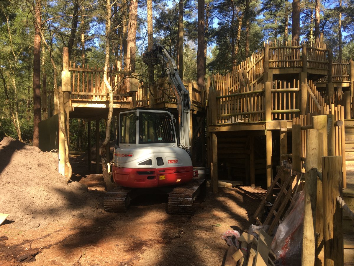

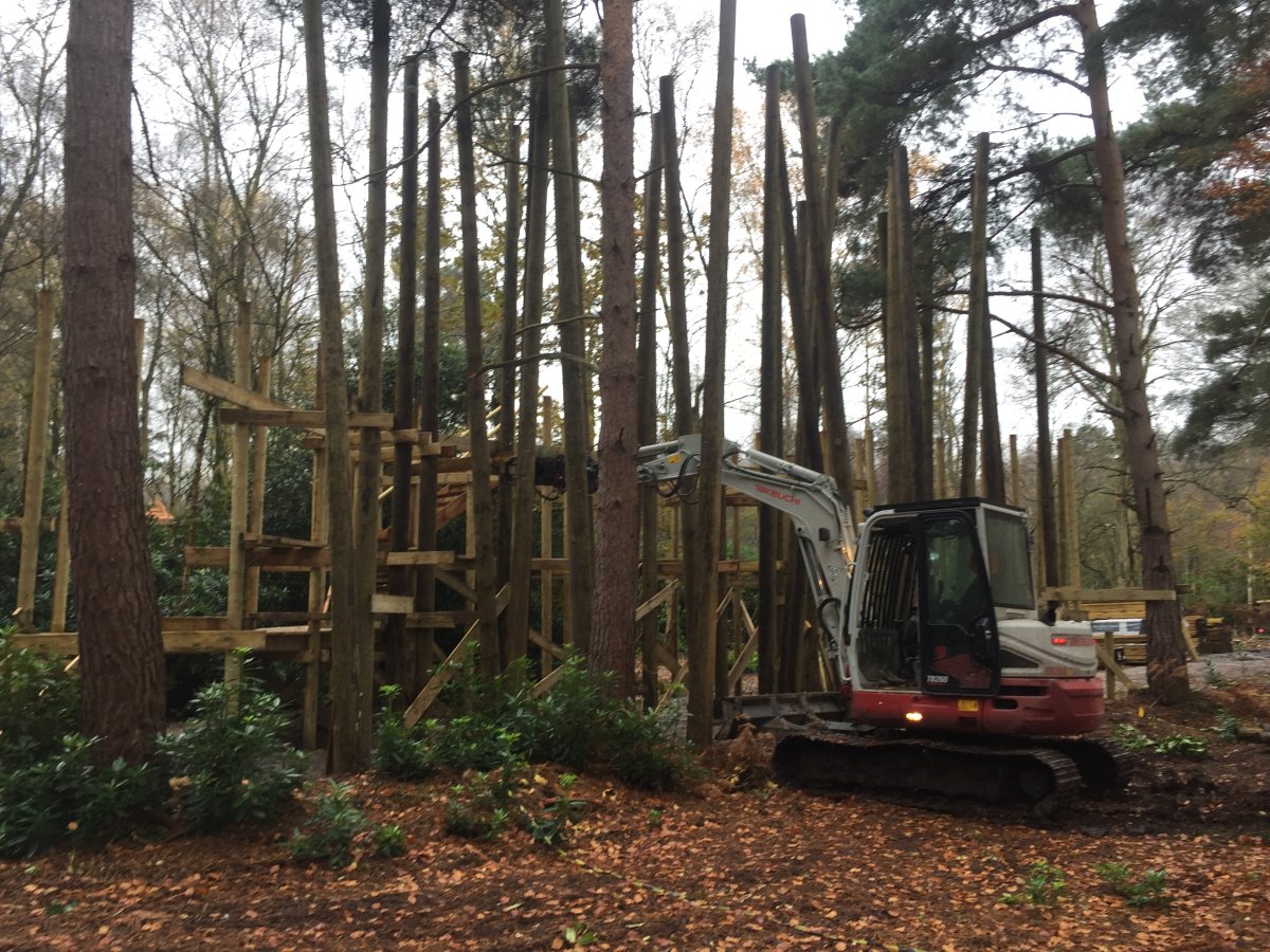

I stood a load of telegraph poles up and placed them into sockets when they were building Bewilderwood (a kids treehouse-theme park) during Covid. The builders drove posts below ground-level with a 3 tonne machine fitted with what I now realise was one of these attachments (they put a galvanised socket on the top of these posts to receive the telegraph poles, to help avoid rotting (but I don’t think it has worked!…)).
It was a very good piece of kit!

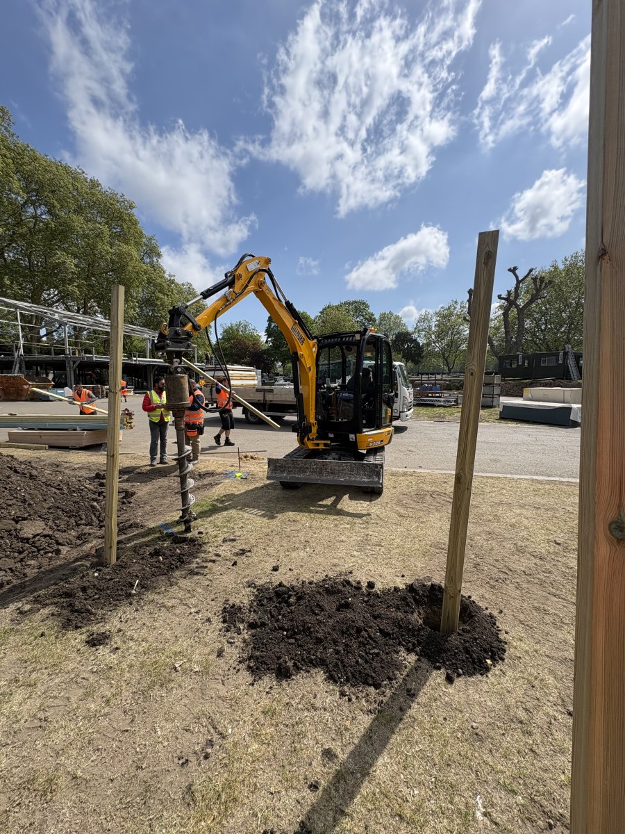

Not used my big 30” yet bought it for tree planting job but ended up just digging them Out as soil was solid clay so could not be re used
Hopefully come in one day
There’s a trick with mounting a 4” bit of steel off auger bracket and dangling chain then can work off a string line if you offset the string line 4"
