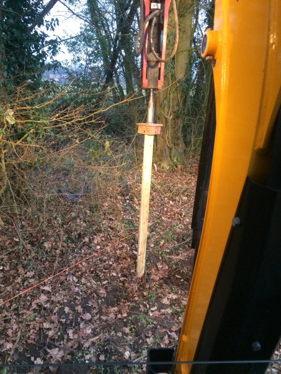

One pictured I believe is mine, Fired 40 posts in within a hour and a half in moderate ground. That is on a 5t, JCB backhoe type breaker fitted to my TB175 (Breaker is off a 2cx)
IMHO need to have a 3t plus carrier to drive posts with a breaker, 7 tonner fires them in no bother, we have gone up to 8" posts this week using a different head/tool on the end of the point and it works well, We also have quoted a job driving RSJ's into a riverbed where the breaker should piss it.

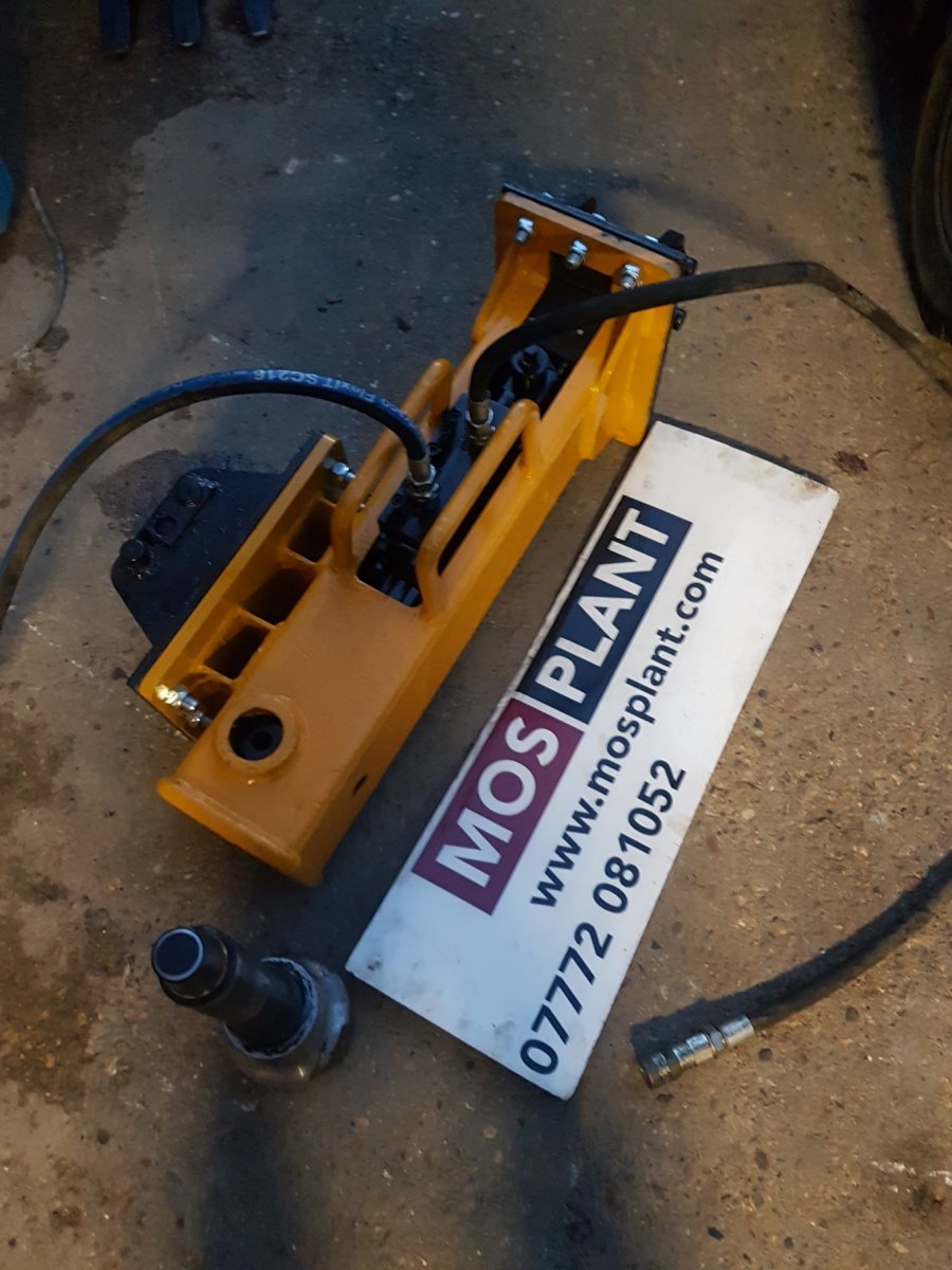

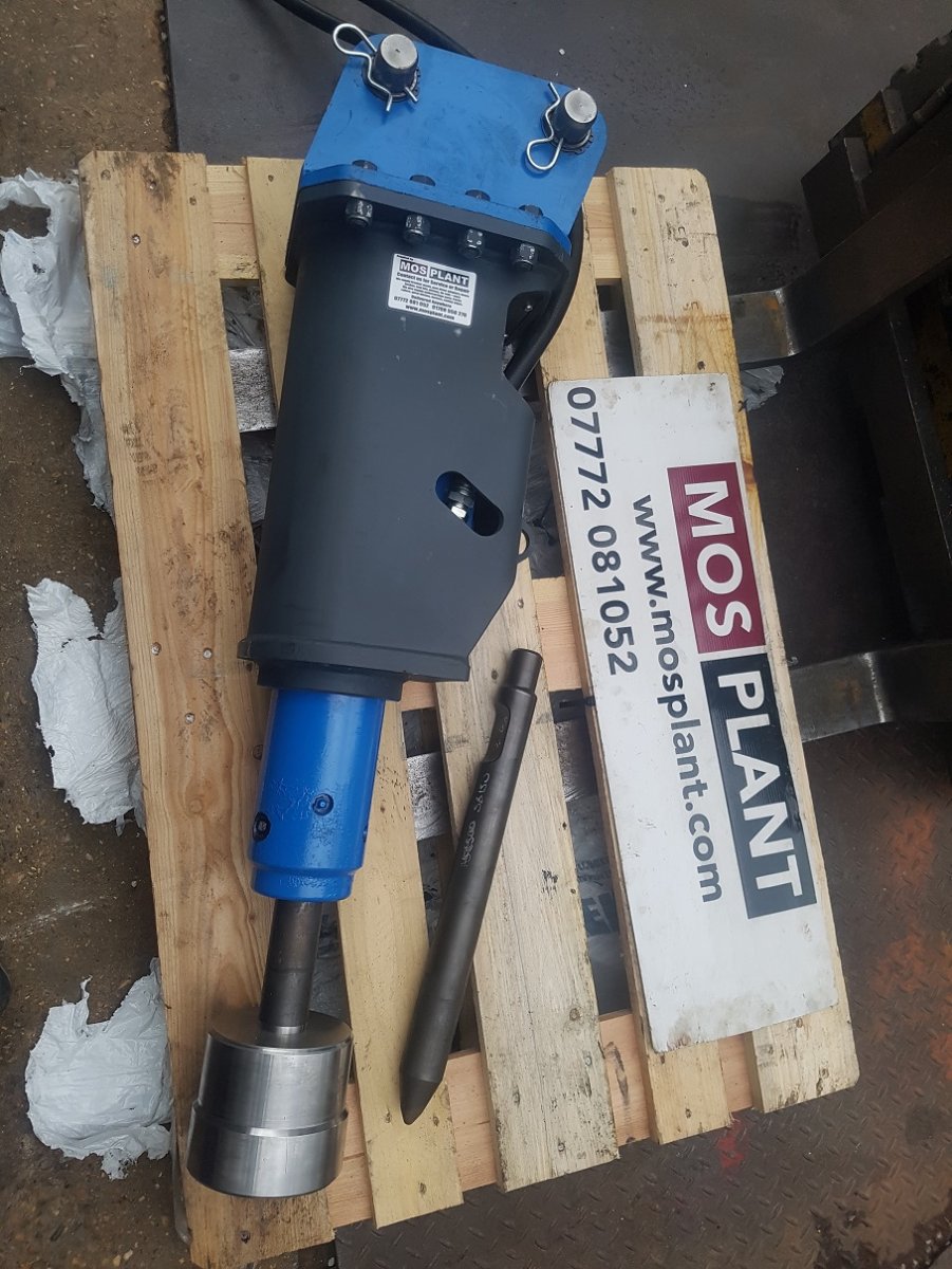

MOSPLANT
Hi Everyone and thank you Wee Gus for your recommendation for our post drivers.
That is also us in the ebay link above.

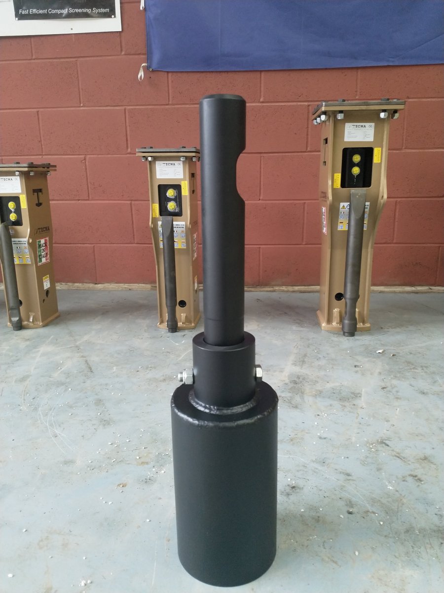

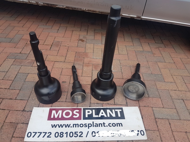

So, as per a few previous comments post driving cups for breakers are a great way of saving time and saving your back. Obviously if you are driving into stoney rocky ground you will have limited success but clay and topsoil are perfect and the posts will fly in.
You need to be realistic about it, I have customers calling me up asking for an 8 or 9 inch cup to go on a 1.5 ton breaker, I point out that its way too demanding and will break the cup or even more expensive the breaker! Realistically on a 1.5 tonner you can do 4 or 5 inch posts with ease and we do make 6 inch cups for certain breakers to do straining posts every now and then and these can also be used for smaller posts.
They are not cheap, but like everything cheap things will not last. Some customers get a price from us and after they have managed to stand up again they go and make their own from an old point but 9 times out of 10 they come back saying the welds keep breaking and they then order one of ours.
We can also fabricate lower mounts for some breakers (not all) and we also supply new used and refurbished breakers if you dont have one already.
Cups are turned on CNC/Lathe from a lump of quality stock steel so are solidly made, there are some hollow pipe types on the market but more and more customers are telling us that they have not met their expectations.
We are here to help and happy to give advice and quotes on whatever you need, whether is be a breaker or just a cup.
Not sure if I am allowed to put contact details on here, admin please remove if not allowed
Martin, MOS Plant Ltd 07772 081052 / 01708 691150 (website is currently being revamped and will be live again soon )

Been there done that with the home made modified cup idea. Breaker smashes them in the ground easy enough but its hard to keep them upright as you go down the digger has a habit of pushing the post away from the machine due to arc of the boom. And then the cup breaks, so you weld it again, and it breaks again 3 posts later.... and so on. :rolleyes:
