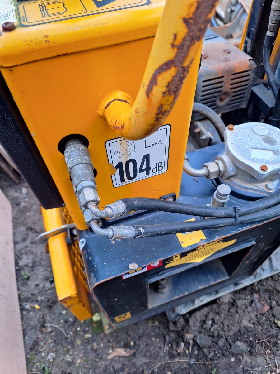

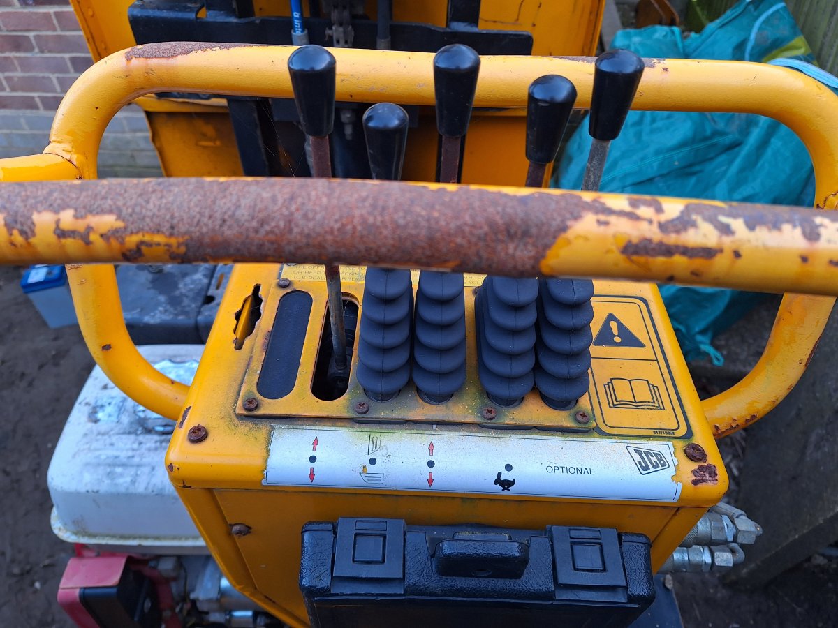

Photos attached for those who are interested in the couplings on the side and controls

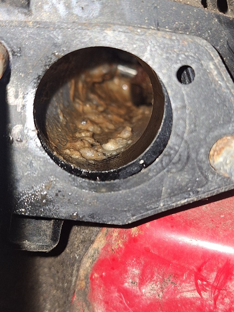

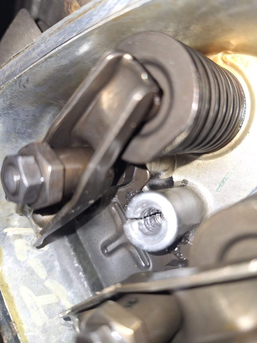

Obviously someone didn't like looking after it 🙄 it wants to start tho believe it or not but just doesn't it coughs and splutters etc think the carb is blocked up
fill the spigot with Devcon/plastic metal, drill and re-tap it to M6 ;)

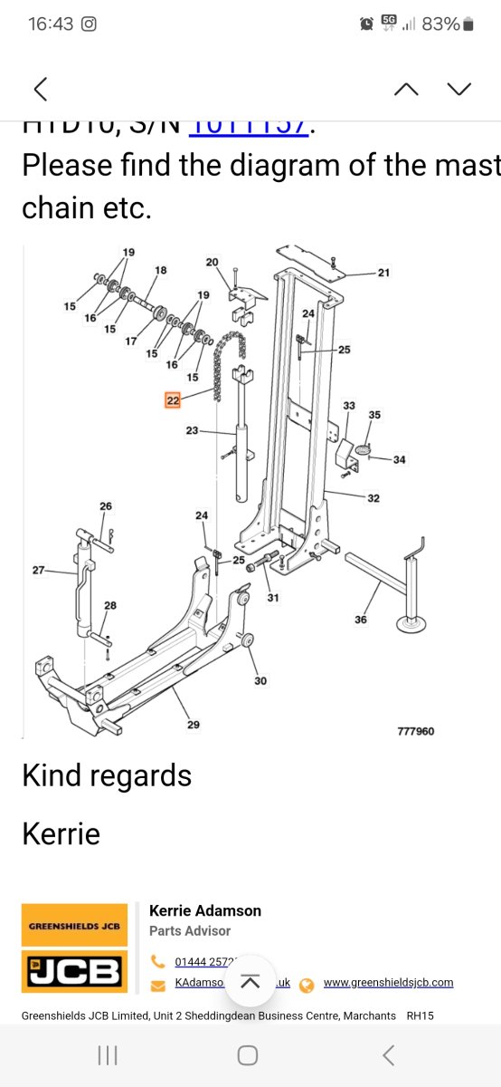

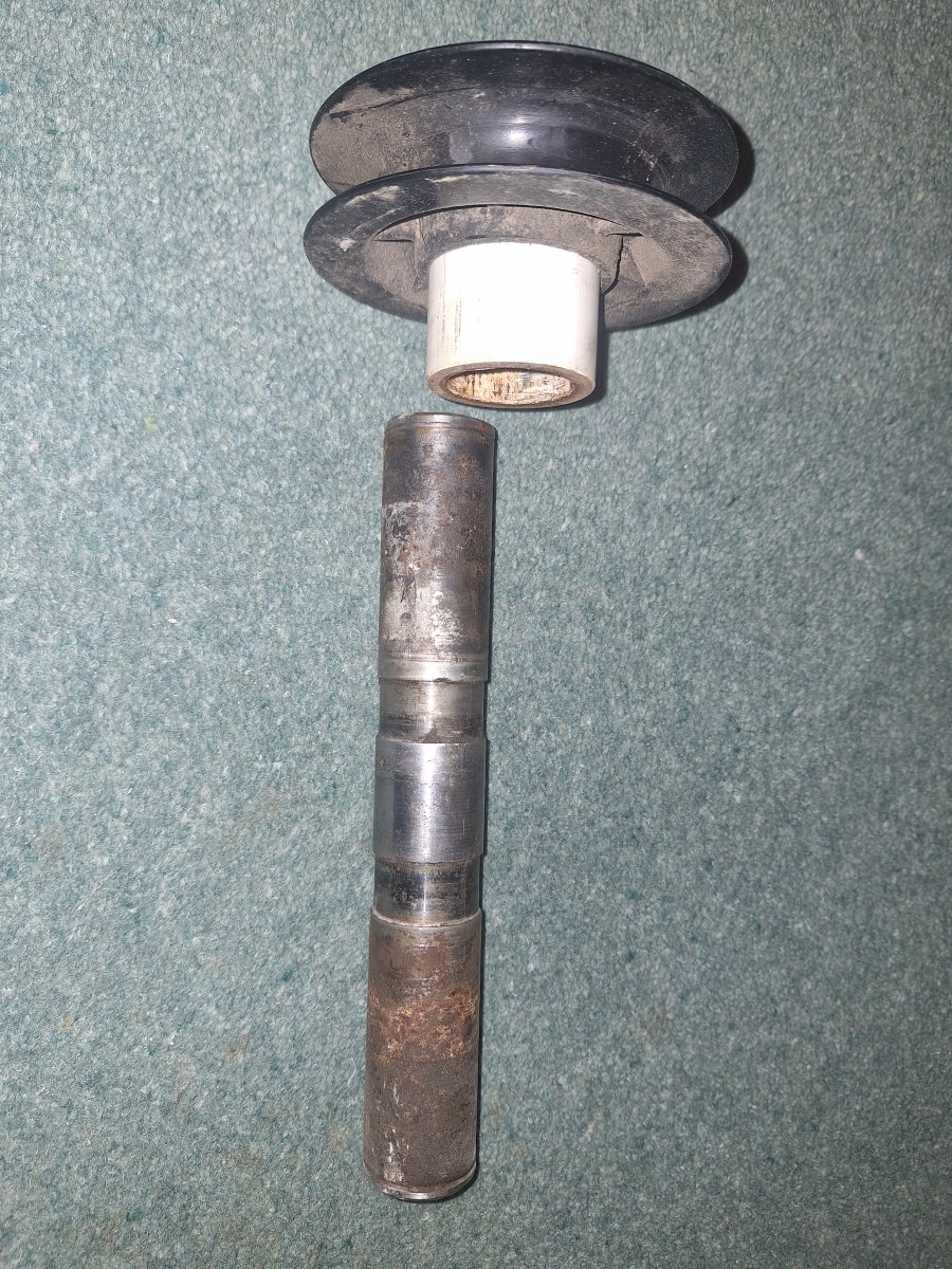

Does anyone know if the white plastic bush should be greased and spin on the metal shaft or should it be a tight fit and the black plastic guides allow the hydraulic lines to just slide though them ?
I'd imagine the black pulley should free rotate as the hoses pass over them ... no sense in wearing the hoses outer by sliding
