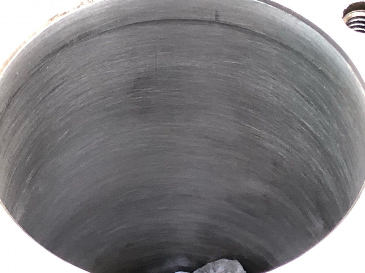

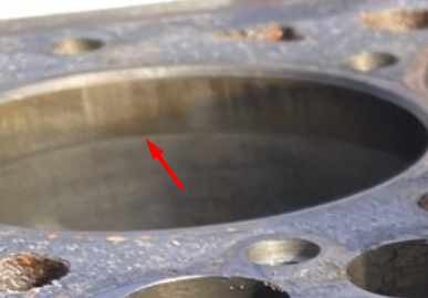

Can you feel any ridge at the top of the ring travel?
Is it just the top ring or both that's broken?
The bores look good, but my thoughts are that if its had a new set of rings and they've hit a ridge, then broken top ring and damaged piston is exactly what you'd expect.

Here’s a photo of the honed bores
Graham said - Negligible ridge. Mostly taken out by honing. The rings won’t knock any more than the originals!! 😜 Just got pistons in. Looking good so far. Photos later…..
