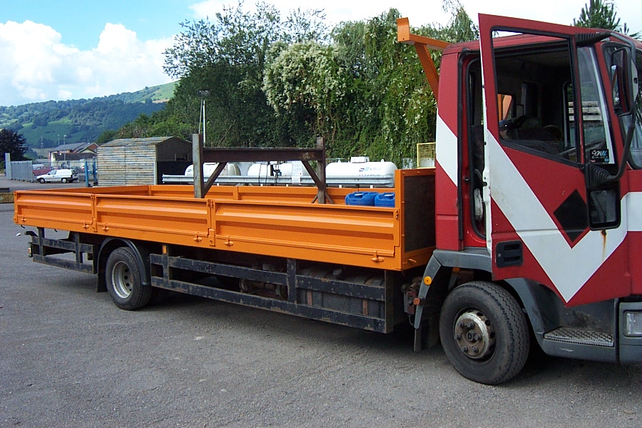

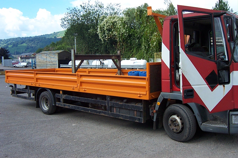

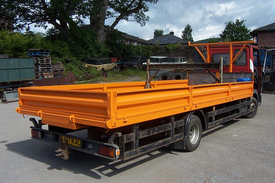

that must be some heavy build at 5t ...... my old Iveco 21ft flat dropside was a dead 4t with an arse in the seat on the bridge .... 3.8t without the sides and spare ...... but had a pretty solid bed (1" keruing) and all the under-runs .... it's possible to build down to 3.5t tare
that must be some heavy build at 5t ...... my old Iveco 21ft flat dropside was a dead 4t with an arse in the seat on the bridge .... 3.8t without the sides and spare ...... but had a pretty solid bed (1" keruing) and all the under-runs .... it's possible to build down to 3.5t tareView attachment 22751View attachment 22750
The emissions systems on the tier 6 lorry's adds a surprising amount of weight
Coupled with modern lorrys being heavier in general then the weight of the tip gear all adds up
Also yours is an iveco which are a few hundred kg lighter than dad or man the same size
Basically 7.5t traditional lorrys are a dieing breed
