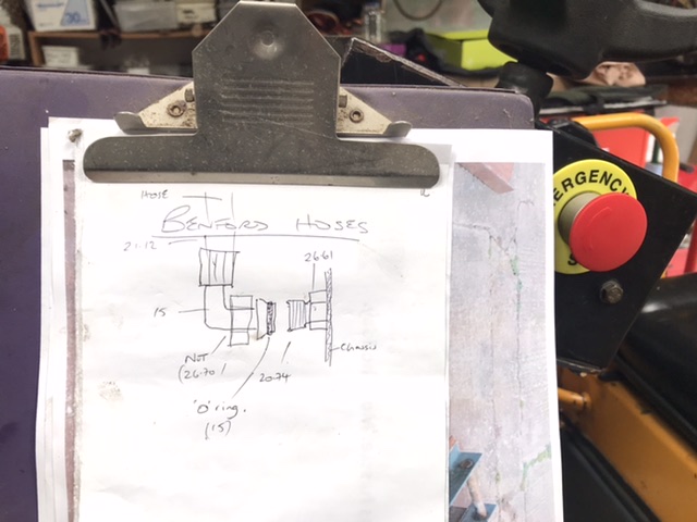

So it's time that I changed some hoses on my trusty old Terex Benford HD850
And this photos shows that they are O ring jobbies

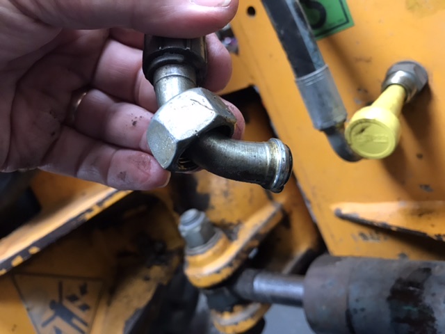

Here you - one end pulled out and butt plug insertedAs a minimum stick a photo of the ends on here before ordering, so everyone can disagree as to what you have!!!

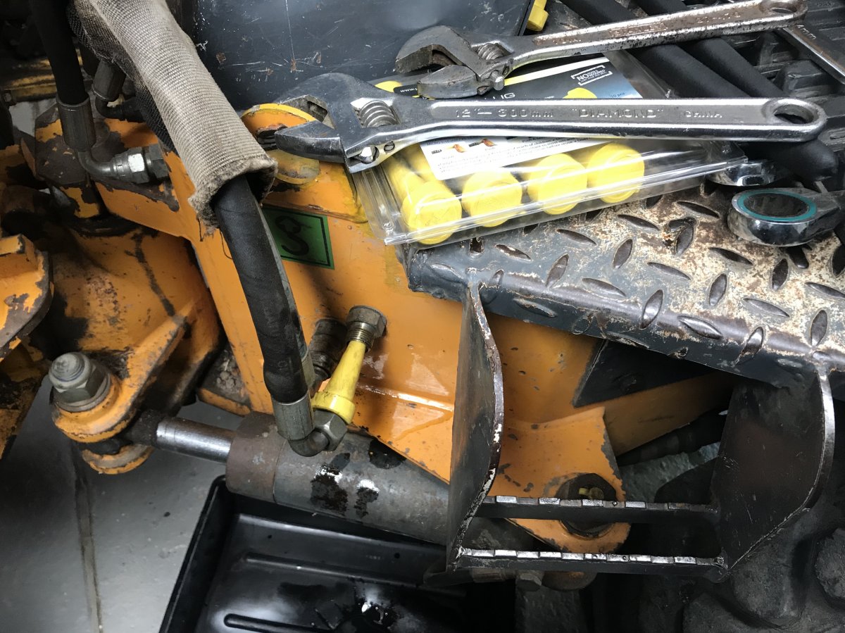

The thing is that I have some very nice sets in the back of the truck just too lazy to go fetch themFor God's sake get some proper spanners man!
Yes at least use a bachoFor God's sake get some proper spanners man!
Or bacho adjustablesFor God's sake get some proper spanners man!

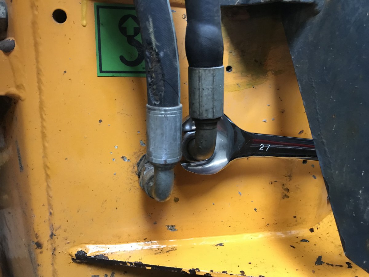

27mm? Think routy just got too preciseodd size spanner for 1/2" BSP ??![]()
Here you go......27mm? Think routy just got too precise![]()
