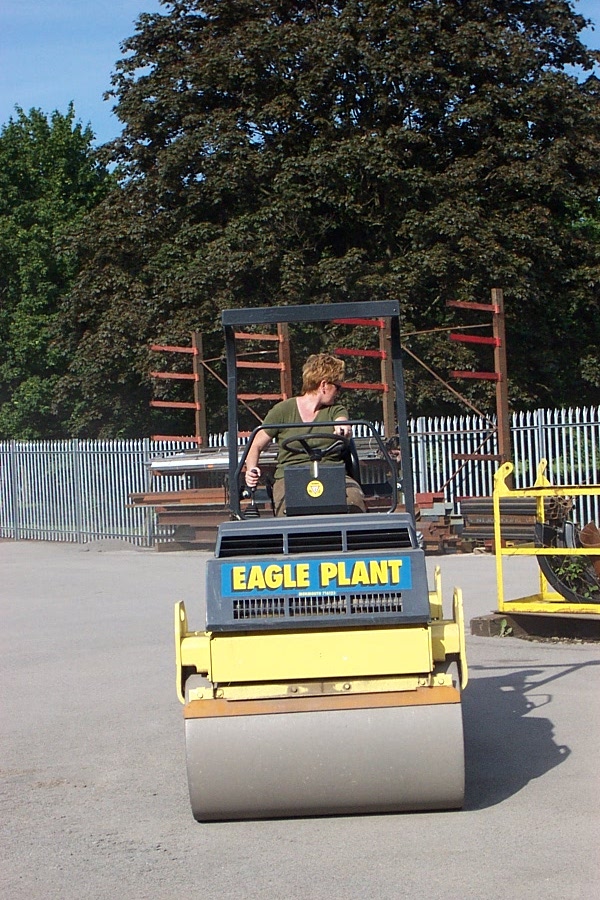

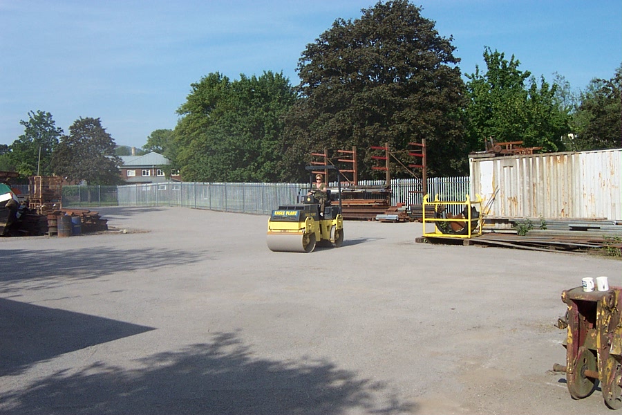

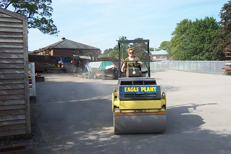

something akin to 'quarrydust' over here 'praps ... tops planings off nice .... put 60 ton down in my yard to blind off the hundreds of tonnes of planings when I did that years ago
guess who on the roller ... looking much younger, one Saturday afternoon, in June '02
