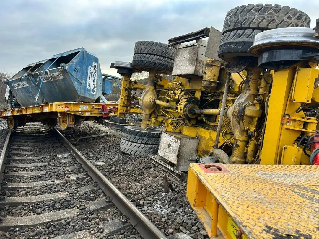

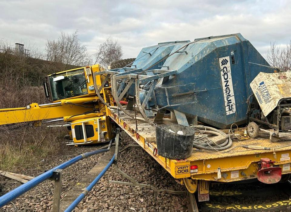

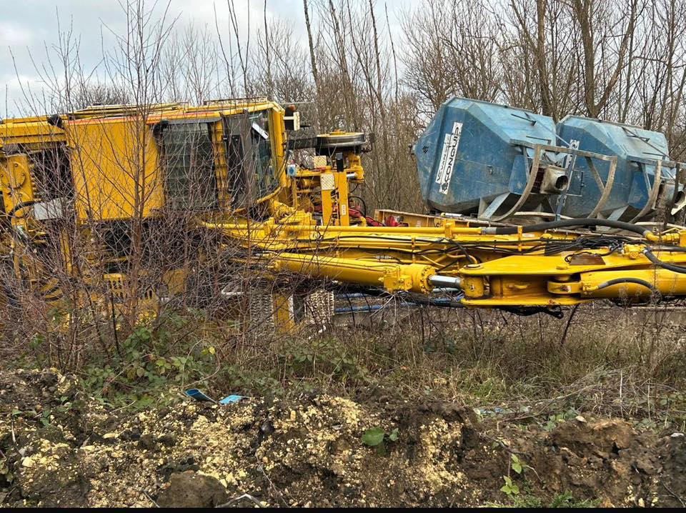

4ft 8 on your rails 5ft3 on Irish broad gauge. Not a lot of a foot print for lifting operations, the rail wheels only make contact ok the rail head of about a pound size..1.4m something on rails vs 2.4m? on tyres wont help![]()
He was tandeming two rail trailers one front and one back and only looking at the pics there’s a fair cant on the track. Really handy to derail for the slightest thing. Lucky they went over the way they do and not cab sideNot a good start to Christmas shut down for someone
View attachment 78383View attachment 78384View attachment 78385View attachment 78386
