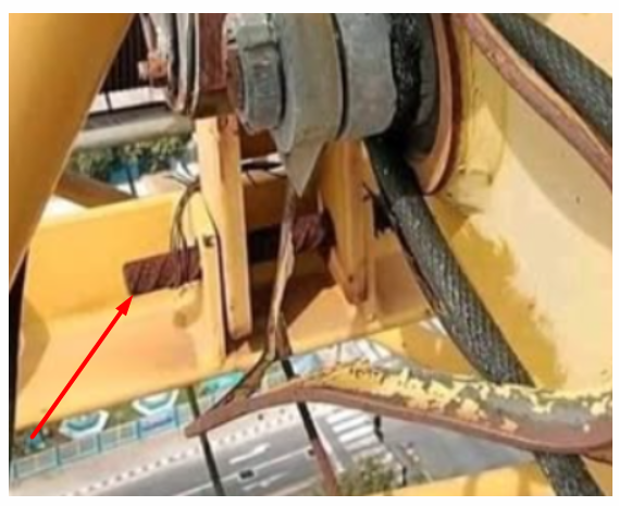

no it's the sheave's flange, peeled off - lack of inspection for wear
Sure, the sheave is FUBAR, but the pin below tells its own story
Ah right - hadn't spotted that :oops:
Don't think it's that structural 🤔 , lovely retainer though 😁
I'd guess it's retaining the sheave mount and possibly dynamometer behind the sheave - so very structural :oops::cry:
least of the issues there though ....... that sheave is probably 5 years past its serviceability on the wear front :unsure:o_O:oops:
looking at the Casar anti twist rope I'd guess that's on one end of the hoist trolley's lift cable reeve

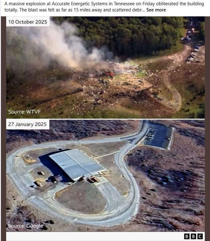

You do wonder how on earth that happened. It was a proper factory that had been in production for years. These sort of places are generally incredibly safe, more so than normal factories, as they know the risks. Lucky it was in the middle of nowhere.
for sure - and probably why it was ....... one thing for sure - no one will have walked away from that :cry:
We drove past that the morning it happened. Never saw the lorry, we all reckoned he had kept driving to clacket lane services parked up and walked home
