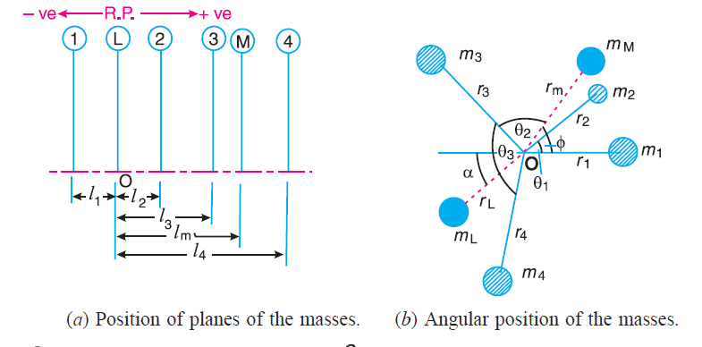

Going back to basics, take a skinny motorbike wheel - when a tyre shop balances it, the weights are on (or close) to the centerline (sometimes on the spokes). That'll give you a static balance which is good enough because the wheel is narrow.
In this case, the out of balance wheel may be treated as a single point mass at a single radius, resulting in a centrifugal force: F = m ω^2 r
where ω is measured in radians.
The balancing mass and the radius may be quite different to the 'out of balance' mass, but will balance perfectly so long as the equation: m1 ω^2 r1 + m2 ω^2 r2 sums to zero.
When you go to a car-width wheel, weights are put on the inner and outer (usually at different angles) because the greater width means the dynamic component becomes significant.
Going to a multi cylinder crankshaft, you've got multiple masses at different angles on multiple planes
Borrowing from a textbook
