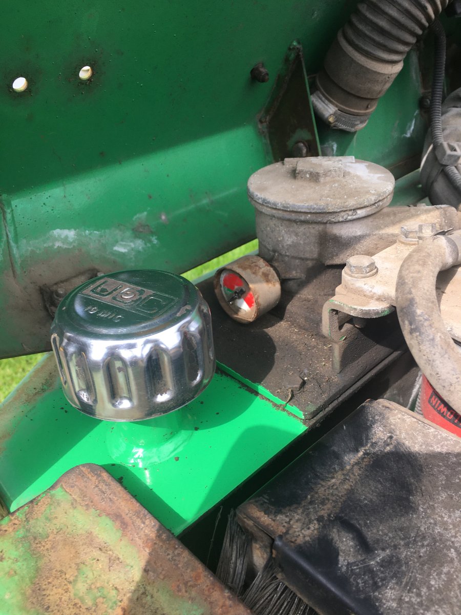

Have found a tiny weep from one of the hose that does tip ram. How do I check fluid levels as the red/green gauge looks knackered.
got a pic of said 'gauge' .... where is it ?

If I lift the engine cover, on the hydraulic tank is a cap that spins and another with a gauge on it with a needle most of the gauge is green with a tiny section of red.

If the needle does work on the gauge would that show half way on the green or all the way round ?

Anywhere in the green is good! This is vacuum! The spiny top cap is a breather filter cover, does it steer?

Hi all tightened up weep still no change. For some reason I can’t upload any videos from my iPad. Only picture of gauge I’m afraid. I didn’t have a large enough spanner to take the chrome cap off to look in the tank but I took the filter housing cap off and this was full to the brim. Still doing the same all works fine for a minute then lose low tip and lower raise. Anyone local to Bishop Stortford who can fix this I don’t have the skill set lol
the gauge is to alert you to a blocked return filter ...
with the top off the filter housing it will be full, but does not indicate the state of the contents or level of the tank itself

I have downloaded the manual but it seems it has more detailed tear downs of pumps and transmission. So do I pull the filter to check the tank level and just clear up my mess Many thanks again lol
Yeah, if you pull the filter housing out you will be able to check level. You might be able to check more easily by removing the filter and inserting some clean plain fencing wire or similar as a makeshift disptick.
When the skip is lifted and tipped as far as it will, are you still able to drive normally? Assuming yours is a hydrostatic version rather than a gearbox, if you can still drive normally this suggest that the fluid levels are OK. If it's jerky drive, jerky steering then oil must be low.
