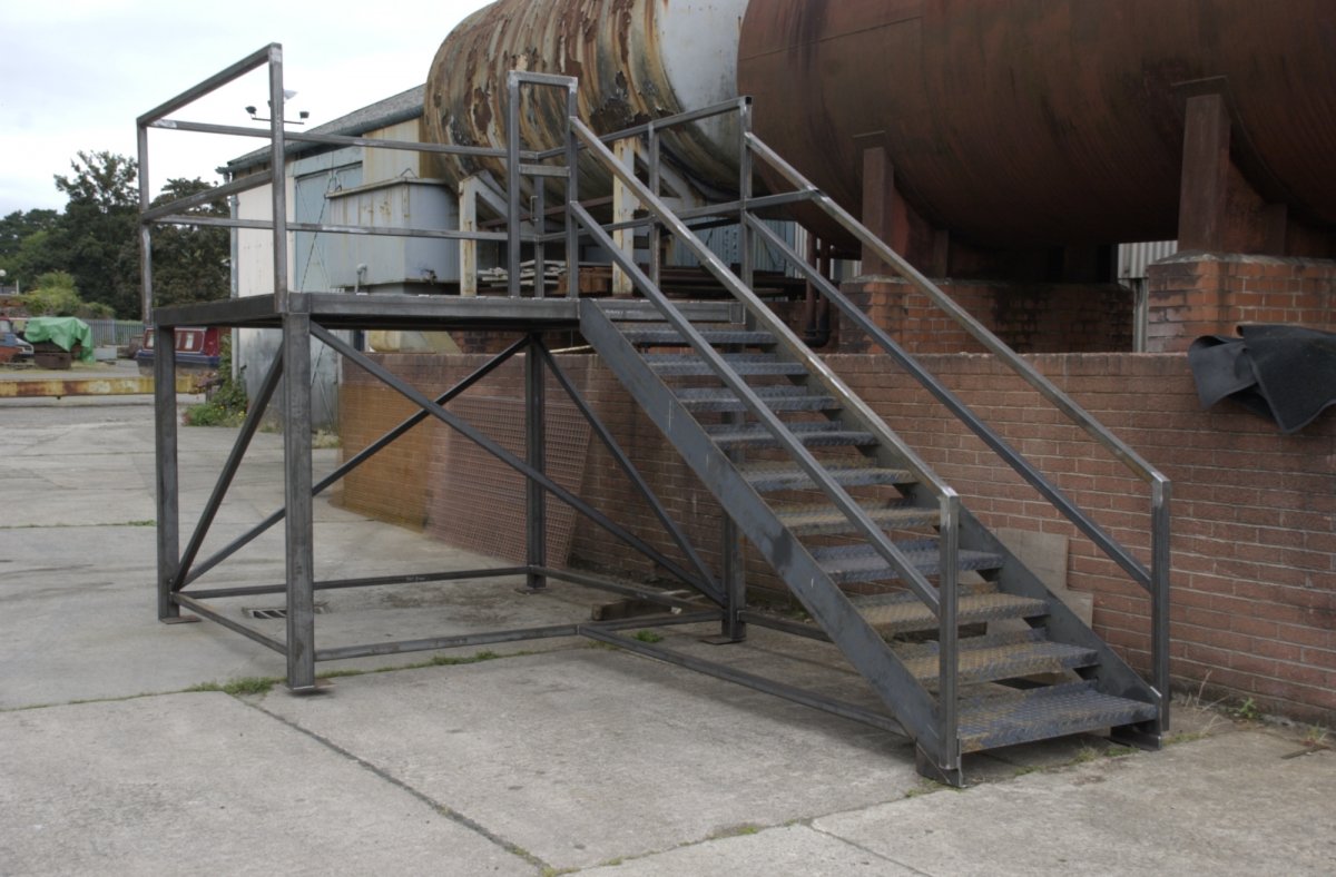

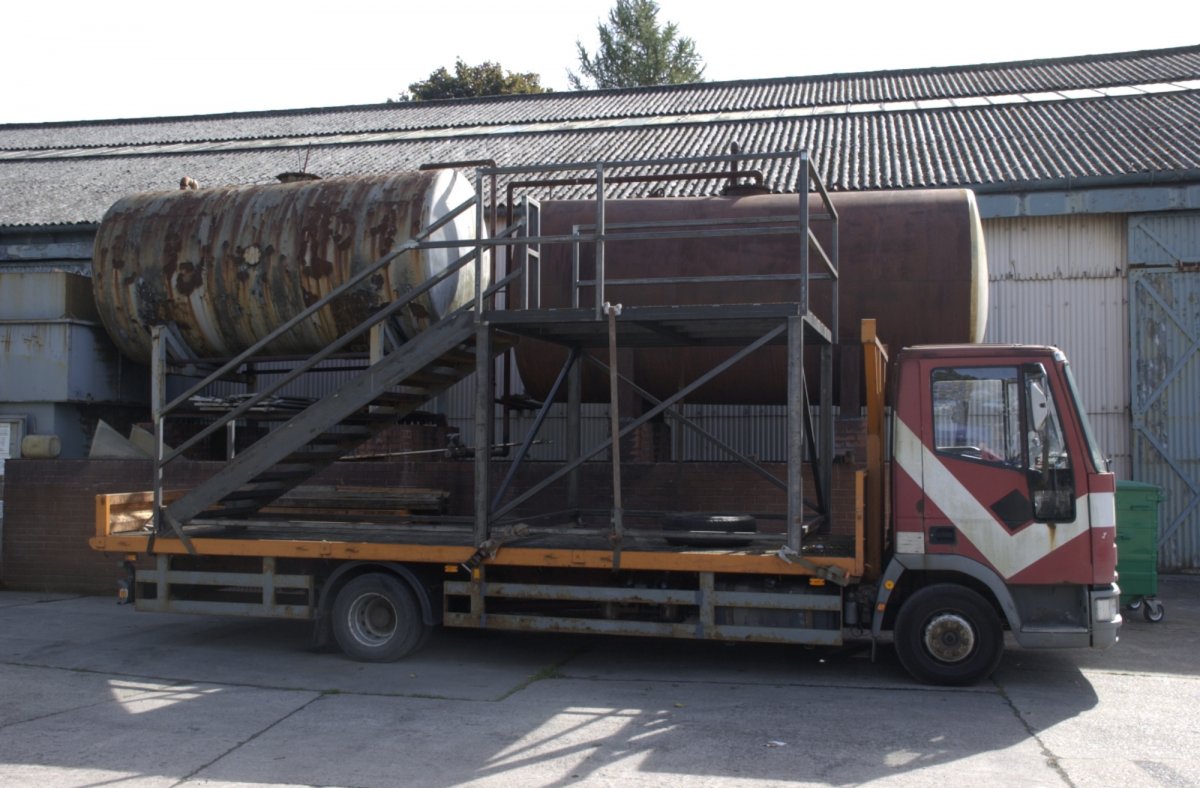

access platform and steps for a machine .. can't recall what exactly .. Aug. '07

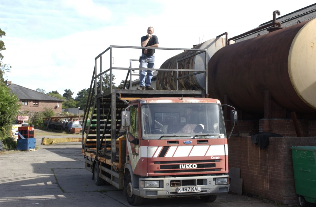

my old Iveco .... mentioned elsewhere recently :rolleyes:
Guess who :giggle: not very often found this side of a camera lens :rolleyes:

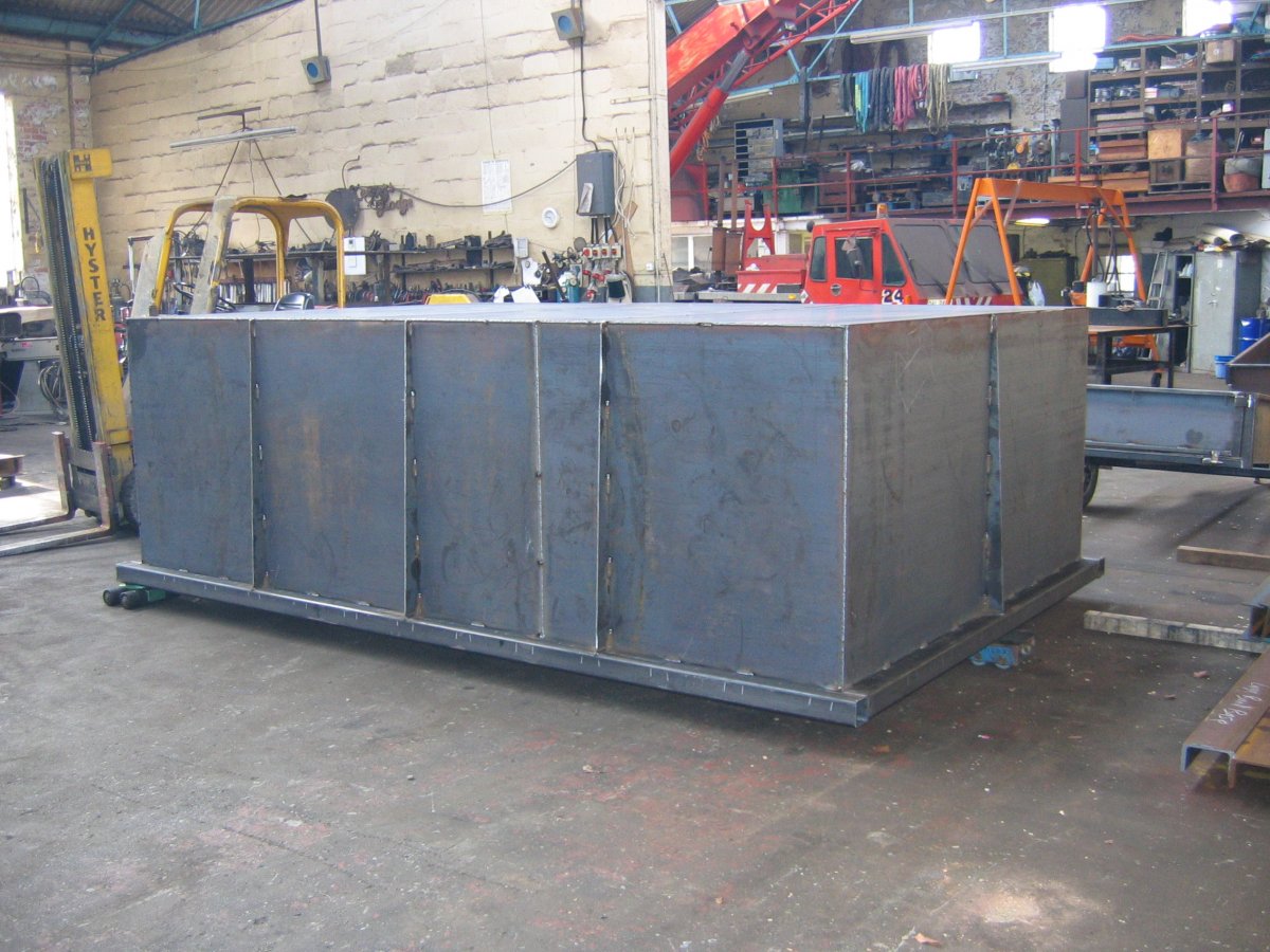

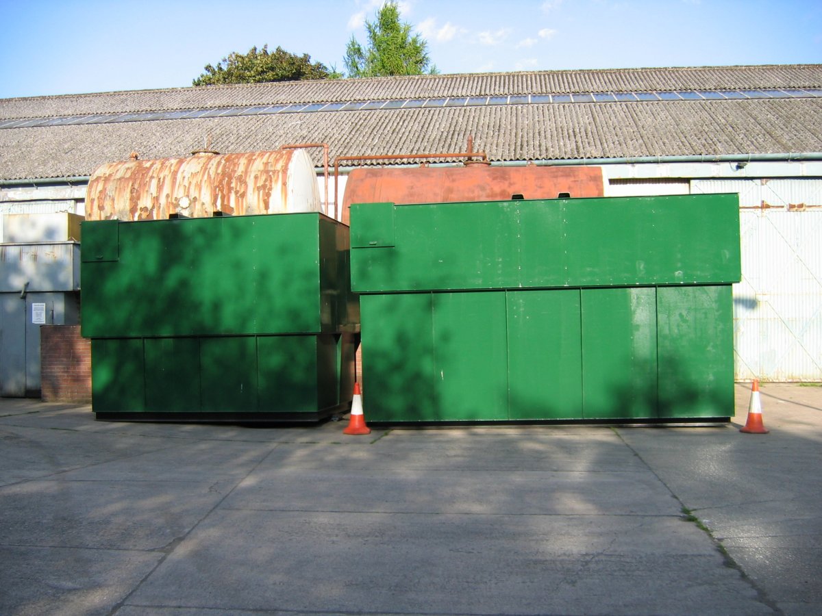

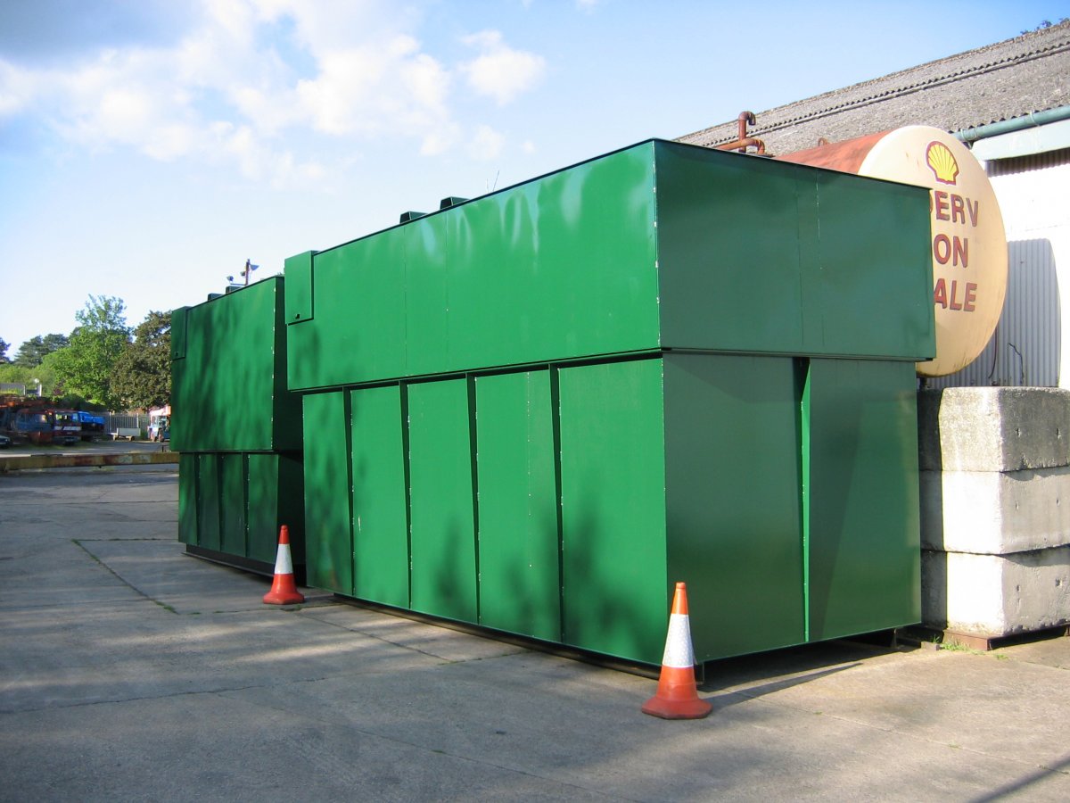

some large bunded fuel tanks for a local out fit, with lift off lids
tailor made to suit their locations .. odd sizes ... 6mm bund sides on an 8mm base ... 2mm lids, cladding an SHS framework.
used to do a lot of 'tailor made' tanks to fit in odd spaces

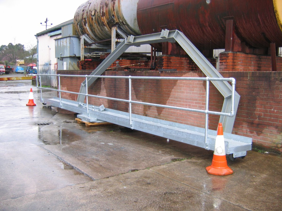

Galvanised access swing bridge for the Swansea Canal ..... an' a lump of attic roof steel for a timber frame build ... huge amounts of that sort of stuff

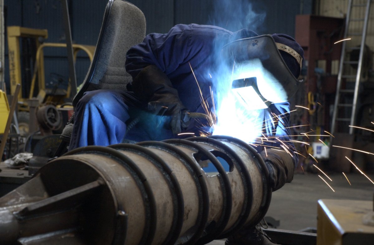

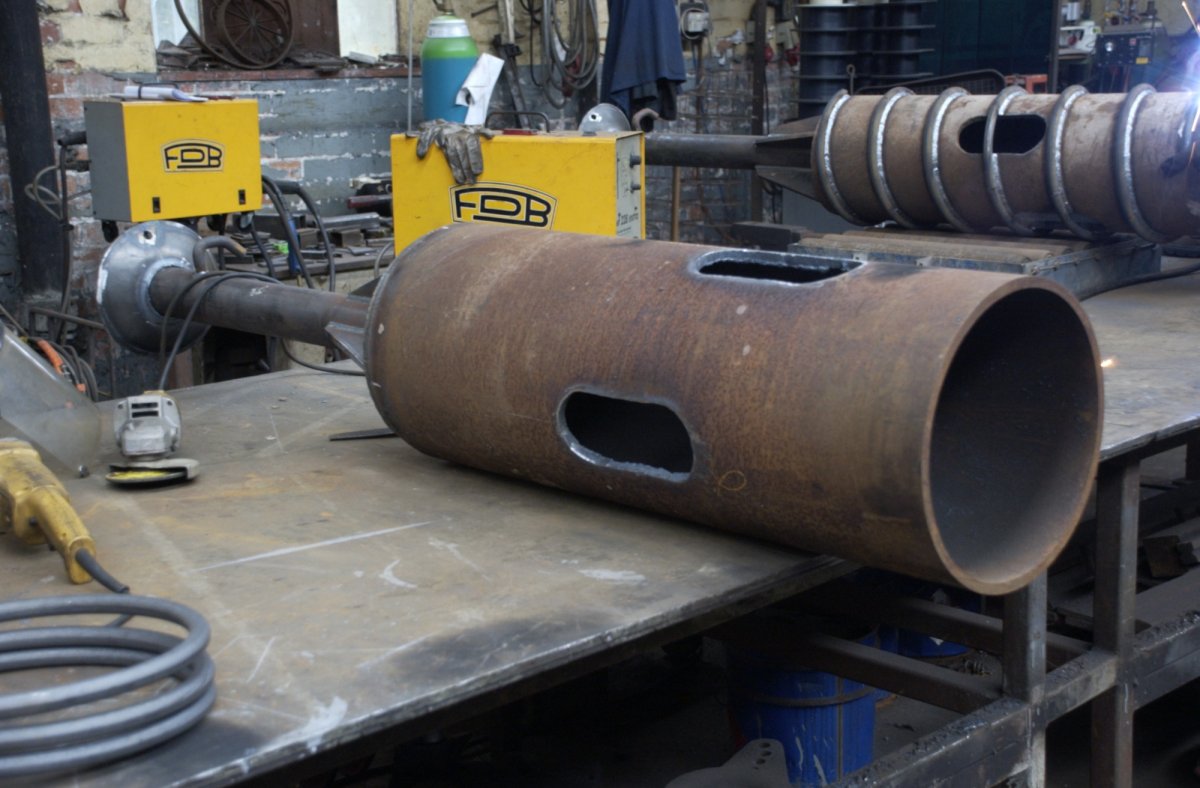

some core drills for a regular who did a lot of pole planting with a 'polecat'

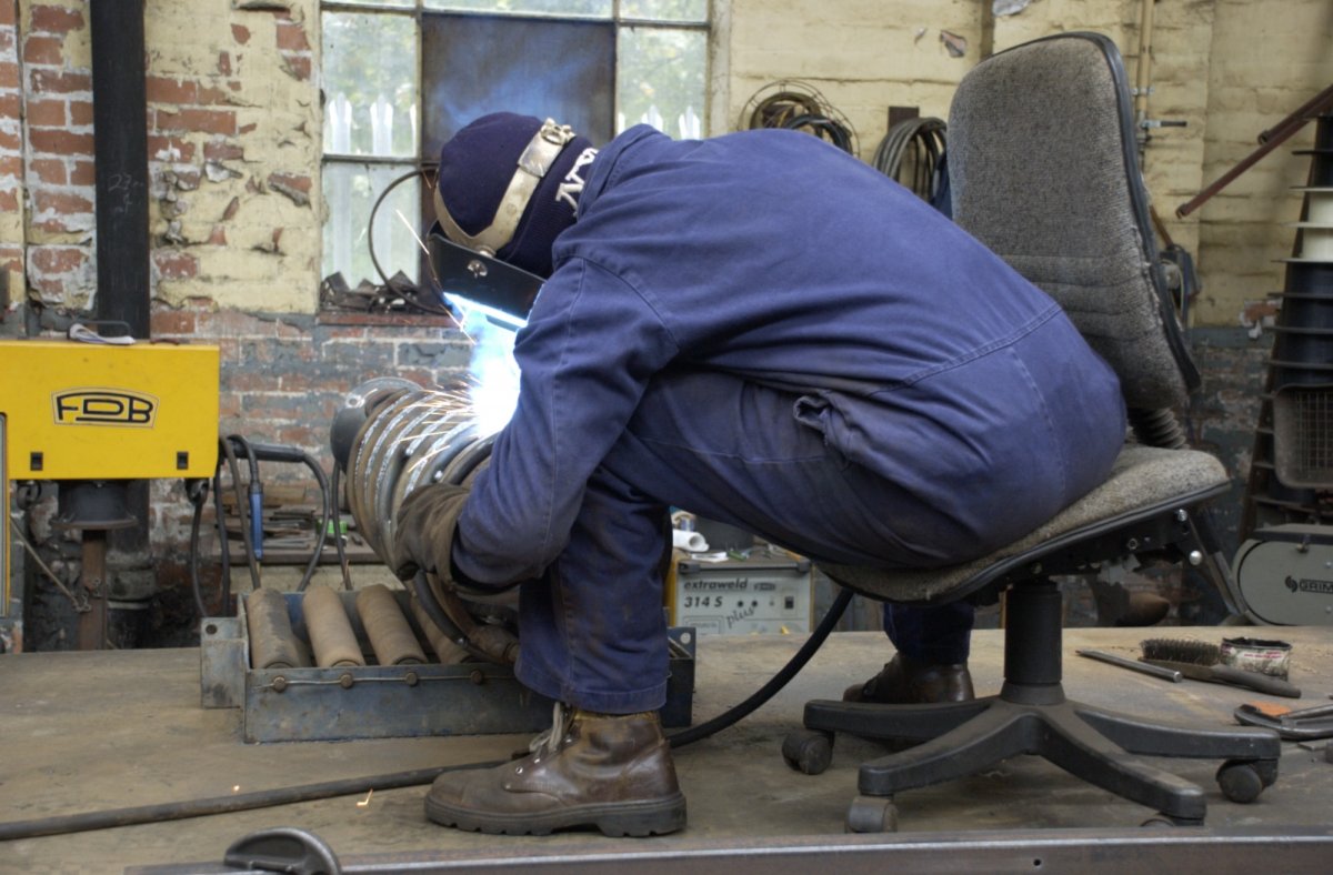

Richy consolidating the flights
rule #1 for a nice weld ... be comfy :giggle: .....
note the box clamped to the bench as an edge ...stop him scooting his arse off there backwards :oops:

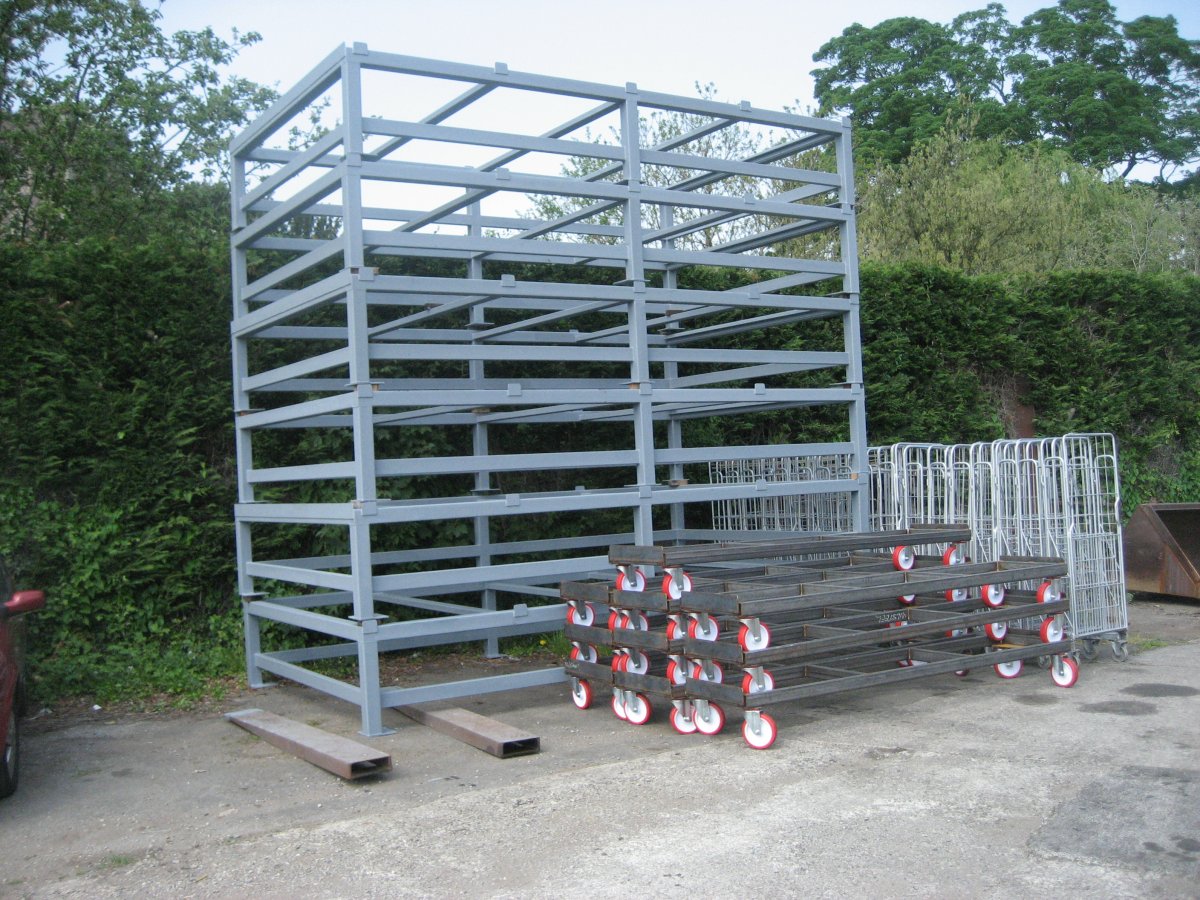

half a dozen timber frame building work/assembly benches/jigs -- had to be cock on perfect .... and a load of panel trolleys for the same place

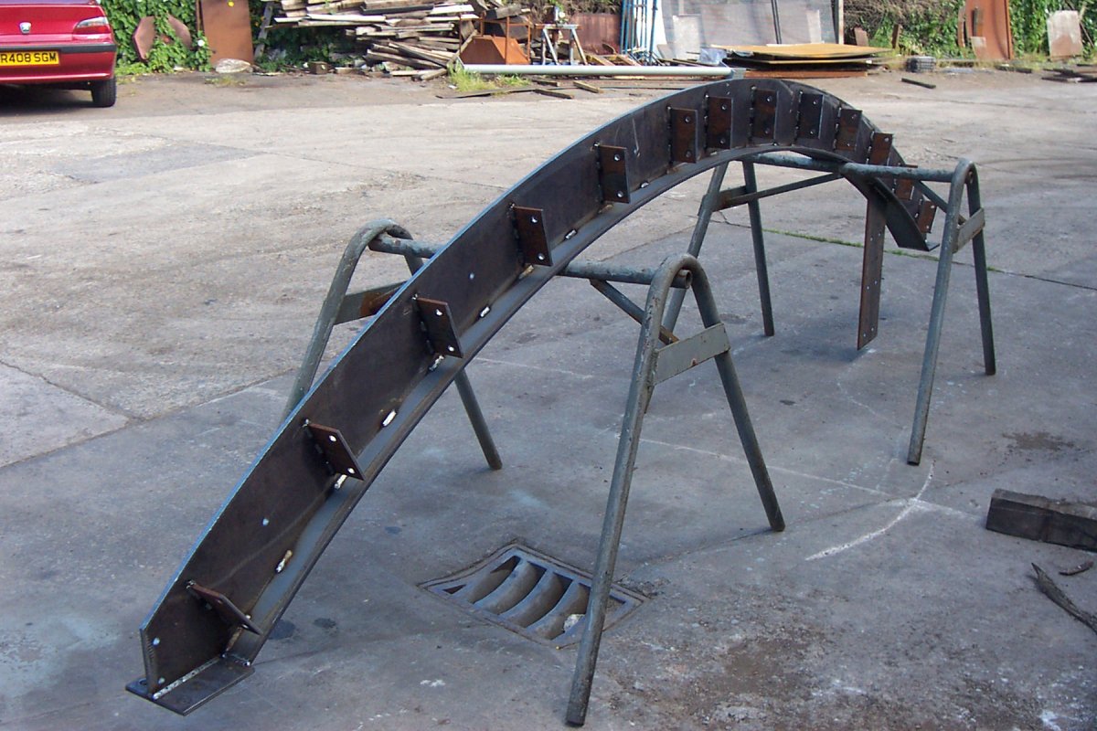

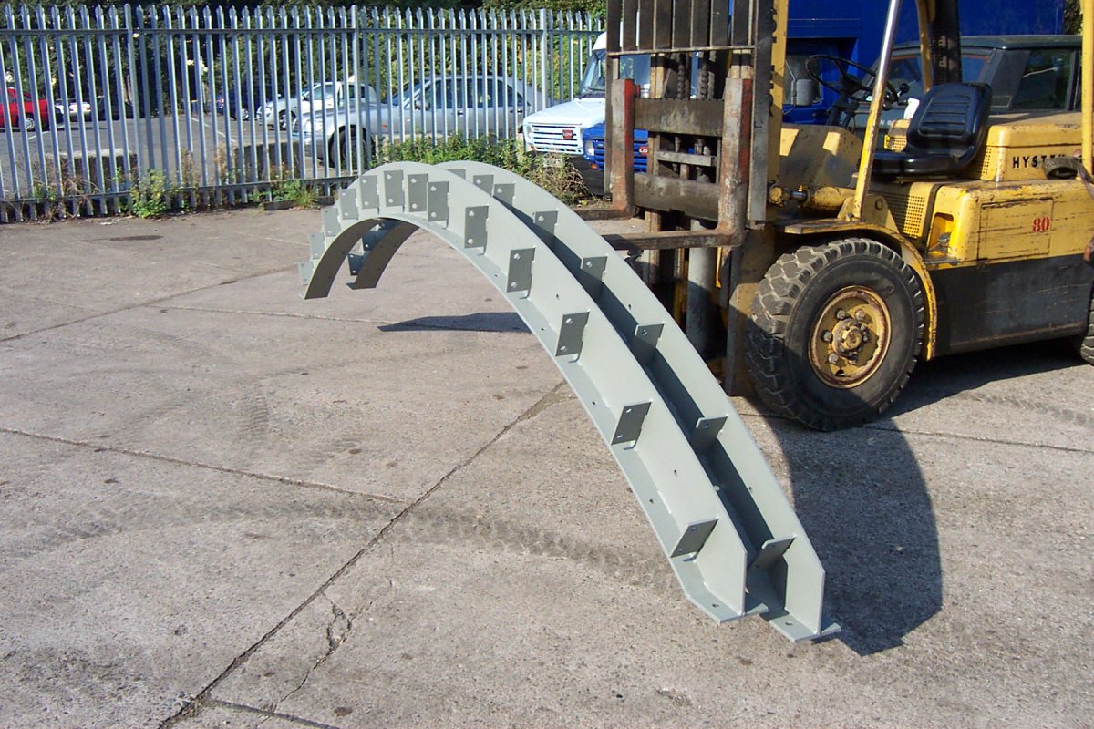

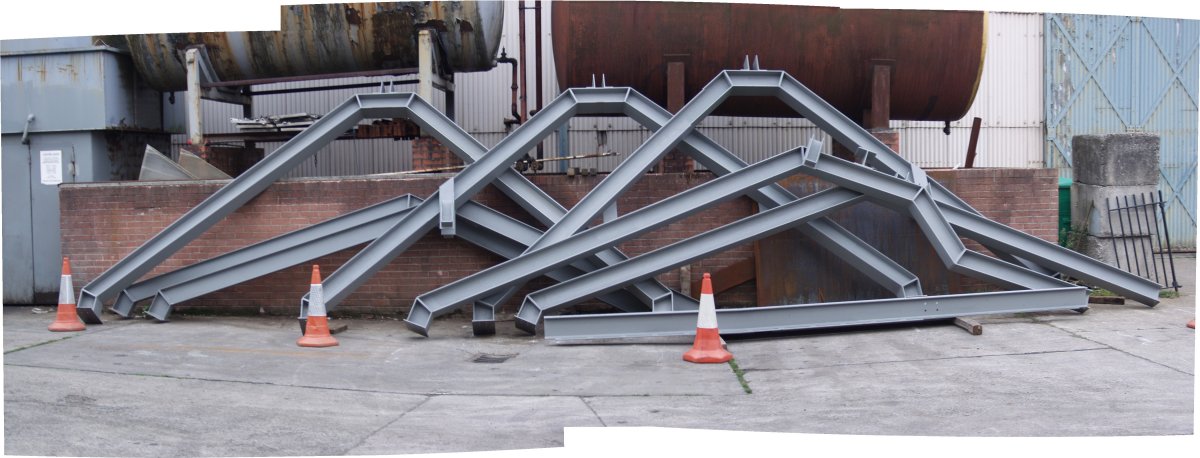

timber frame again ... curved roof lintels .... made dozens of these for one particular site

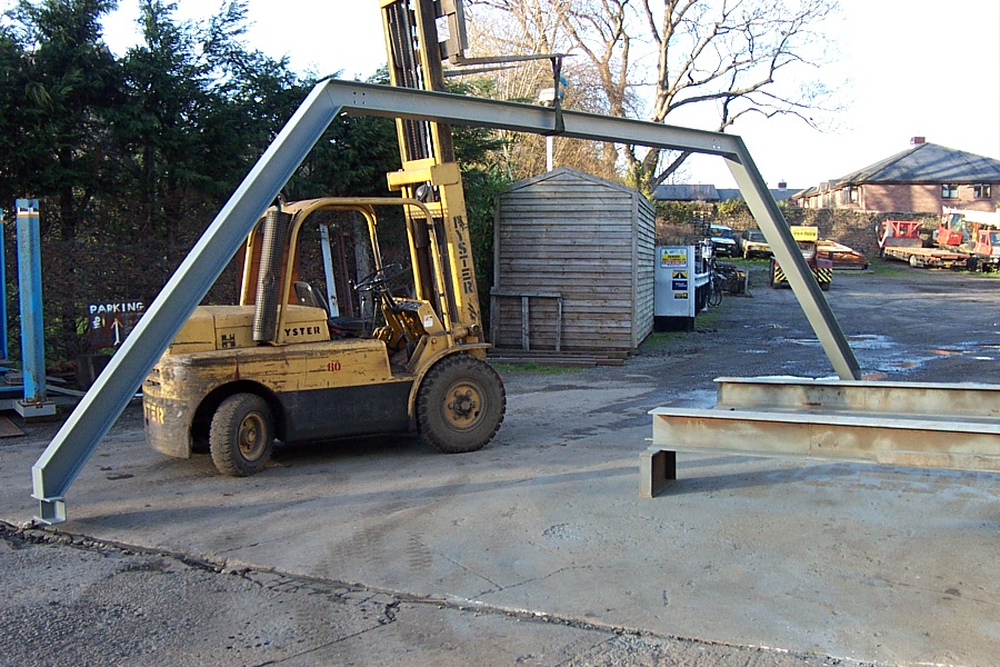

a n other 'interesting' roof for 'em

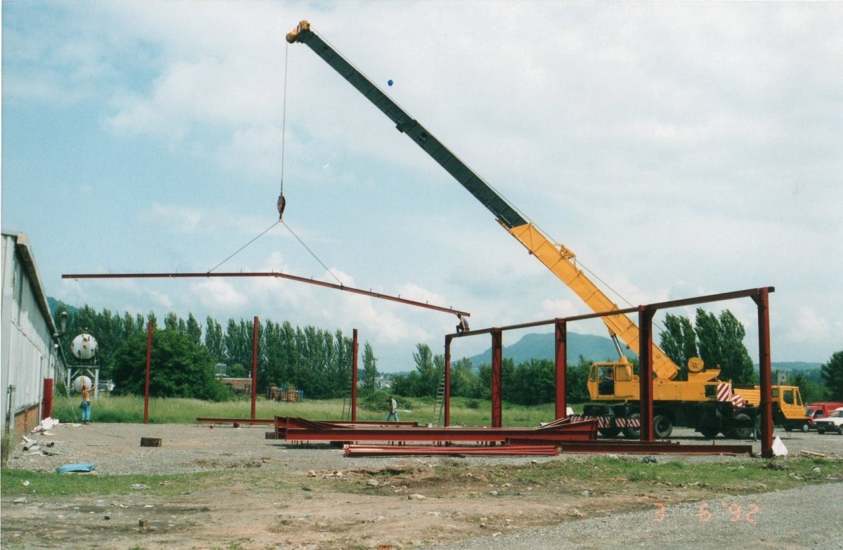

extension to Cooper's Filters stores in town ... a good few years ago now ... my 45 tonne Grove TMS475 ELP ... and a very flat roof :oops: ... did question it when the drawings arrive ... but was told it was right :unsure:

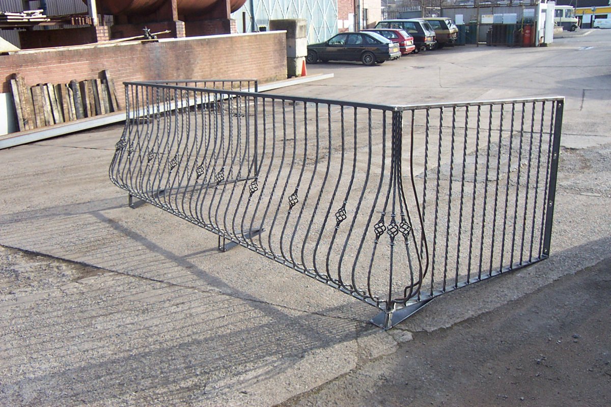

fancy balcony rail on a sloping roof / balcony BTLs .. can't recall exactly

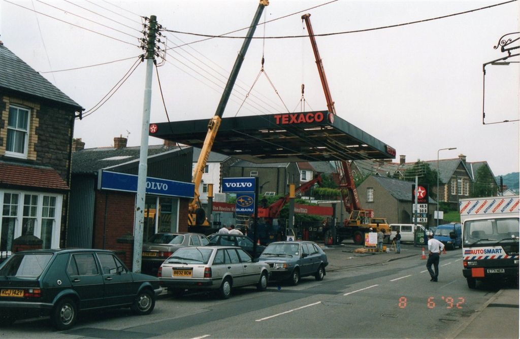

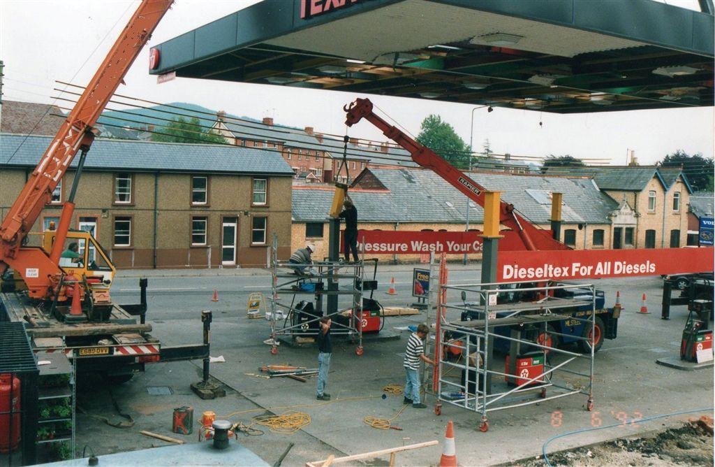

this was an 'interesting' lil' number
petrol forecourt in town - raise the canopy to get bigger vehicles in ....... bloody long time ago

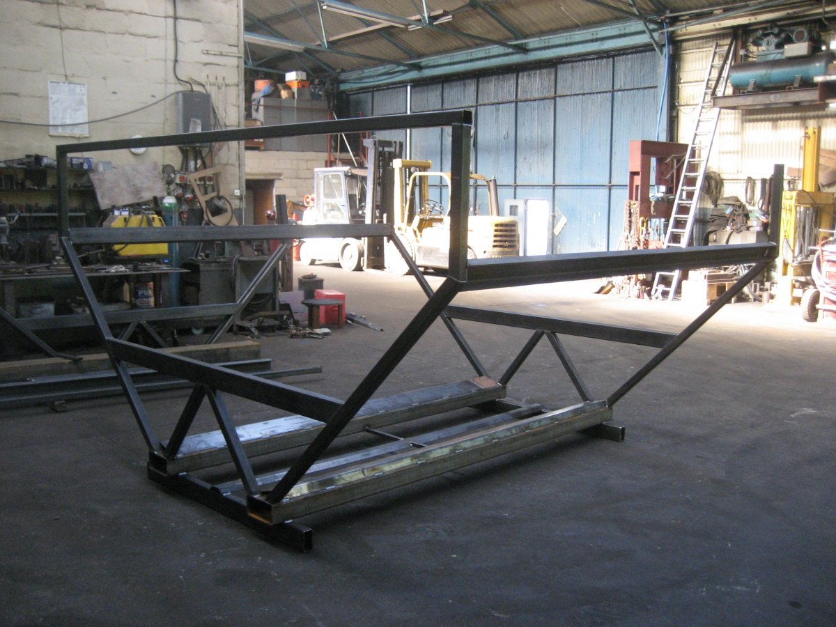

last one for tonight .... Did a hell of a lot of work for Amec Utilities .. pipe coil racks .... did lots o' these

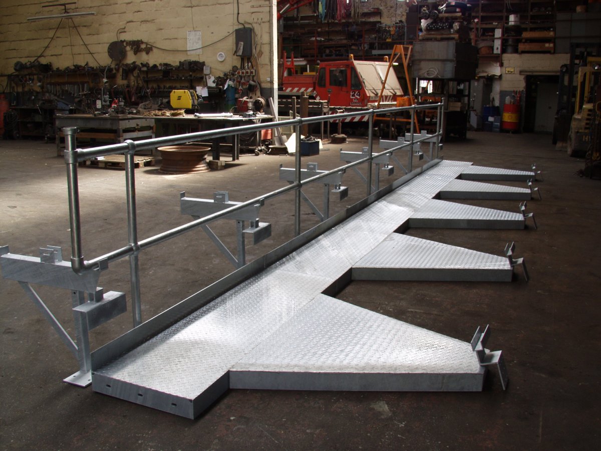

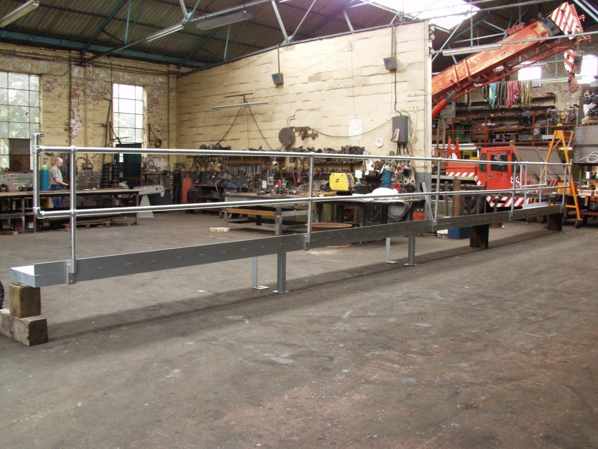

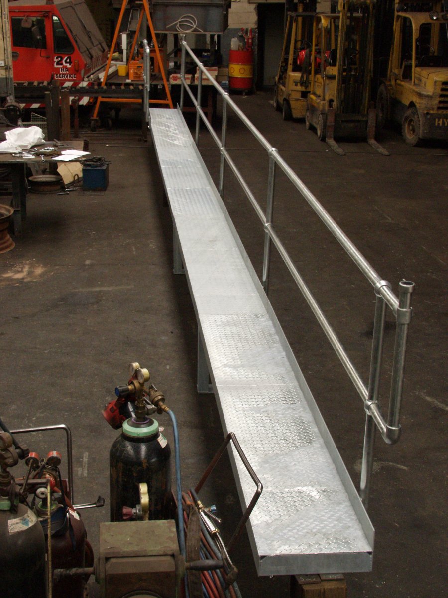

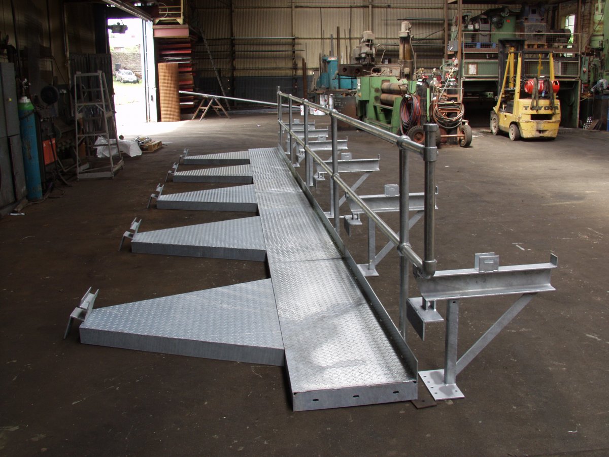

seeing as I just found these ..... and @Regy53 loves his canals ..... specially for Ross ...

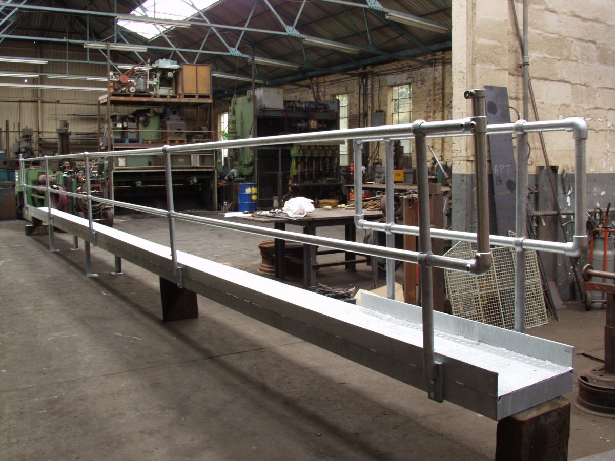

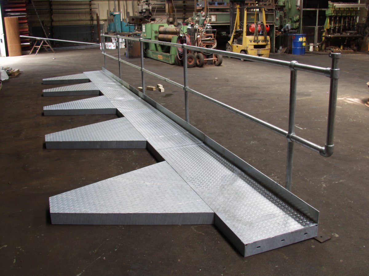

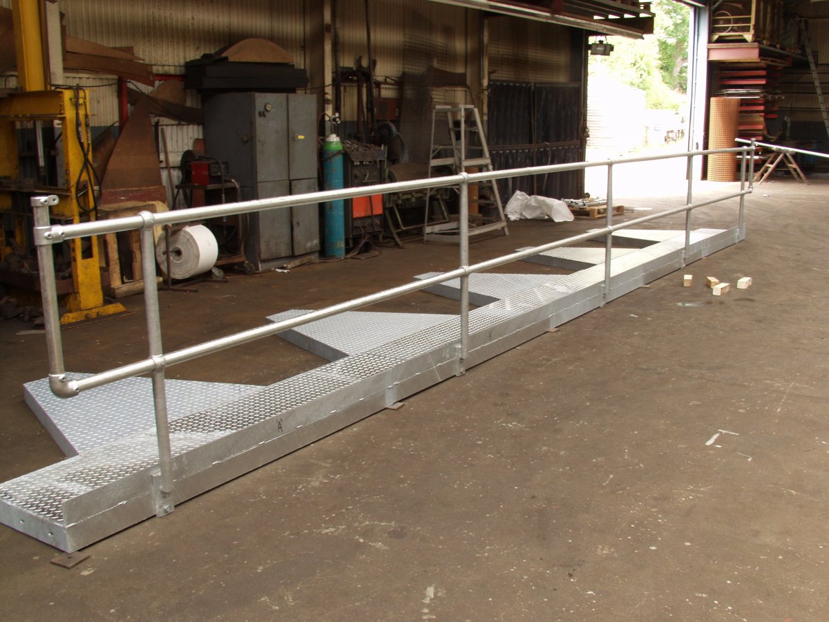

a job for BWW usually started with a call from Kevin, in the local office, who was in charge of all the daily maintenance/running of the Mon & Brec. ... "can you just ......... " well this one was above and beyond the norm. ".... have a look at the spill way weirs up at Llanfrynach ... we need some working platforms for clearing 'em off ... H&S are giving me grief " :( :unsure::oops:
took me a day to survey it all and measure up .... one was easy ... t'other was a dog tooth affair .... all had to galv.ed, so had to be perfect straight off and was always left to me to come up with their solutions :rolleyes: ..... all had to be man handle-able as no way could i get lifting gear anywhere near this ... middle of nowhere :(

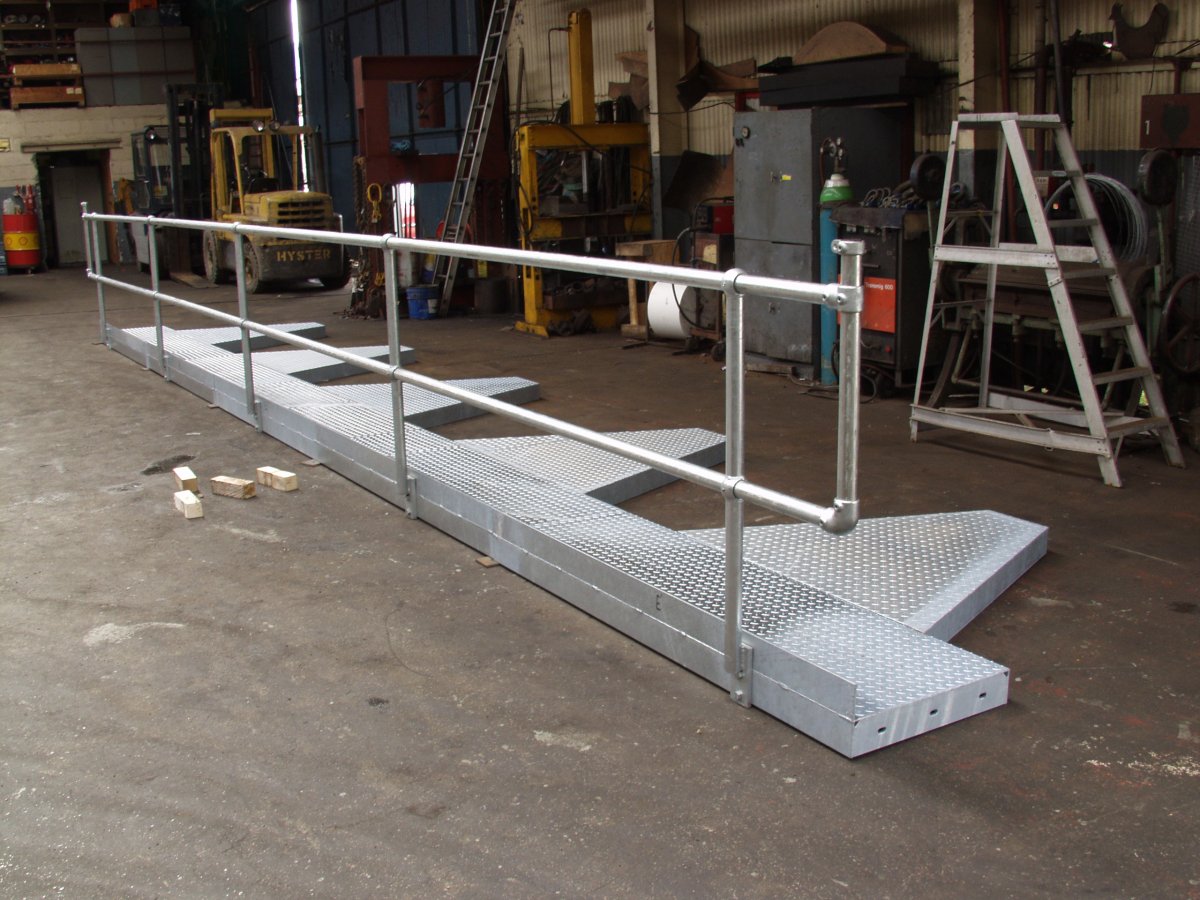

this was the easy one

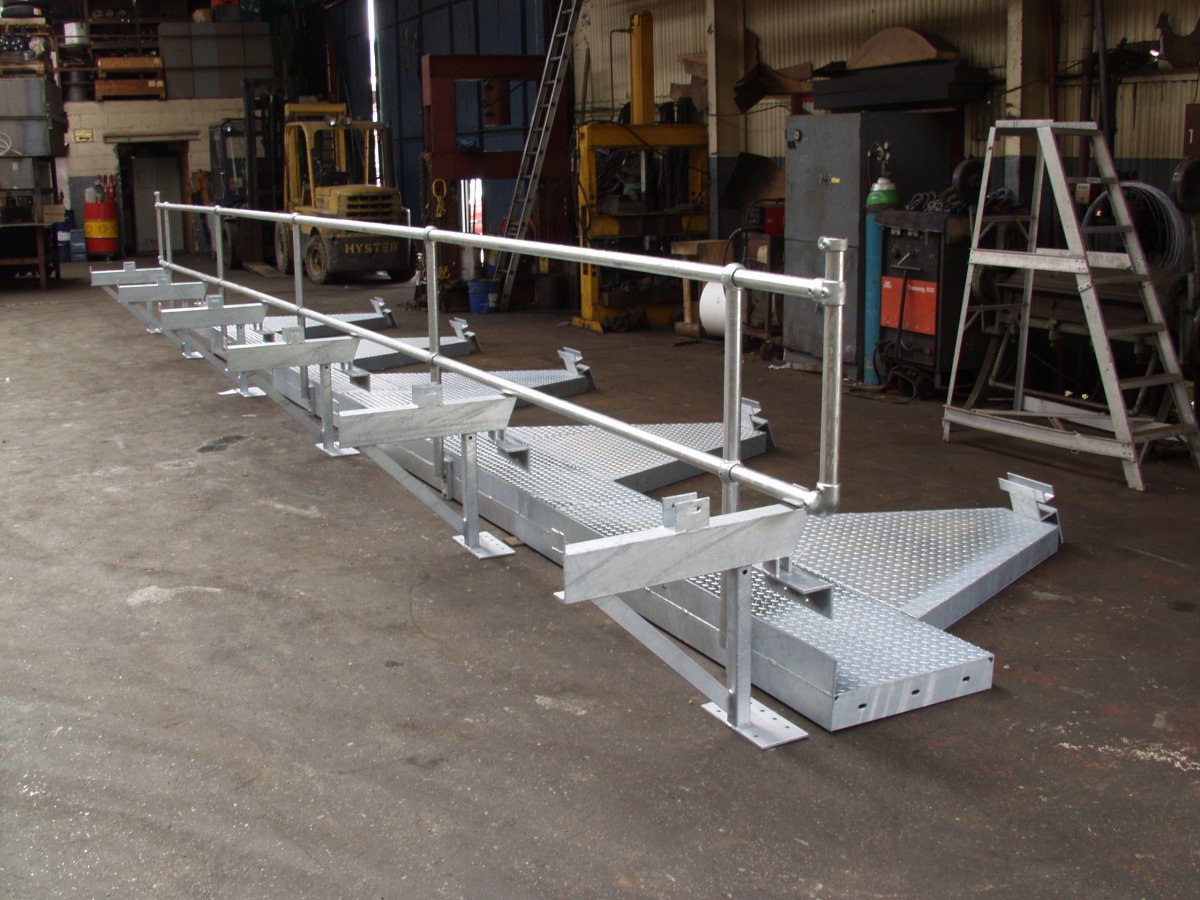

as if the decks weren't bad enough .... the support system was something else .....
some where I have some pix of this lot installed ...... but damned if I can find 'em .. went in sweet as and fitted like the proverbial glove (y):)

How do you set the flights up on a drill like that looks interesting

pretty straight forward .. divide the circumference into quarters .... if you're spacing is say 4" ... first quarter is an inch drop from start point ... second is two inches, third, three.... etc. ;) rolled some 20 mm bar into a spiral, in the section rollers, after sussing the diameter on the first set of markers, then work your way down with a spacer bar, stitching as you go .... only have to get the spiral roughly right in the section rollers ... spacer and brute force sorts the detail.
flights weren't critical anyway .... just creating some 'loose' around the drill body, so's it'd come back out the hole easily ..... the 'cutting edge' had six gums and TC teeth fitted into it ... should have some pix somewhere ? :unsure: apparently they were awesome at making holes in just about anything :giggle:(y)
