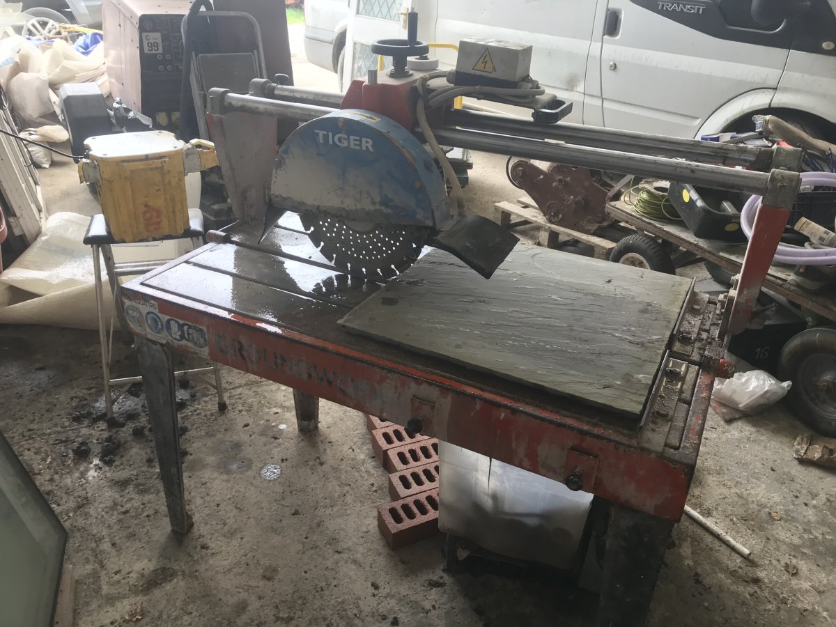

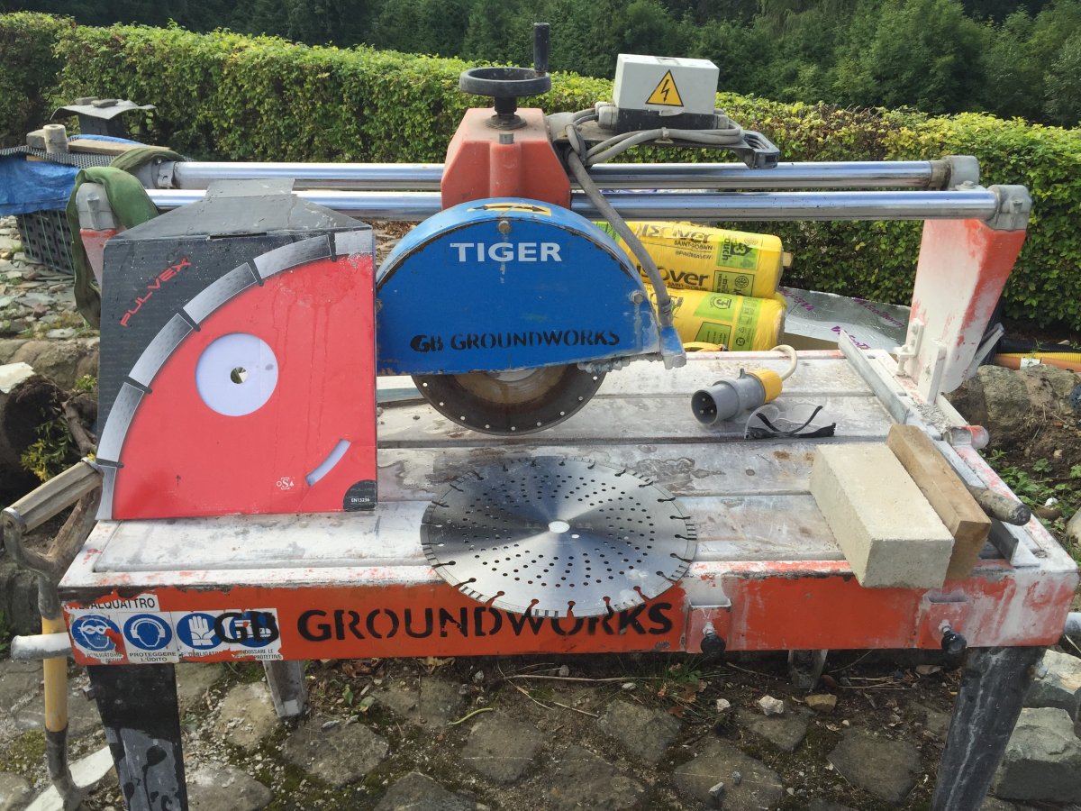

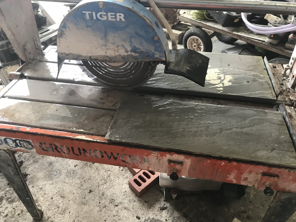

I bought this tile saw for £300 from local hire shop, had pulvex make me custom blade, cuts 100mm block no problem. We use for paving, block work, block and beam floors etc, fill base with water pumps Rd runs off 16amp 110v but should be on 32amp really
I'm jealous! That's a good deal, and a bloody good saw by the looks of it. Do you ever have problems powering it off regular domestic electrical supply?

32amp 5kva tranny will run off domestic ok if you use common sense
no runs fine, run it off my little 6kva generator some times as well that runs it fine, but as long as you use the box by the socket and use 110 extensions in 32amp fittings it’s fine. Not sure how it’s be on a big 13amp 240 lead
