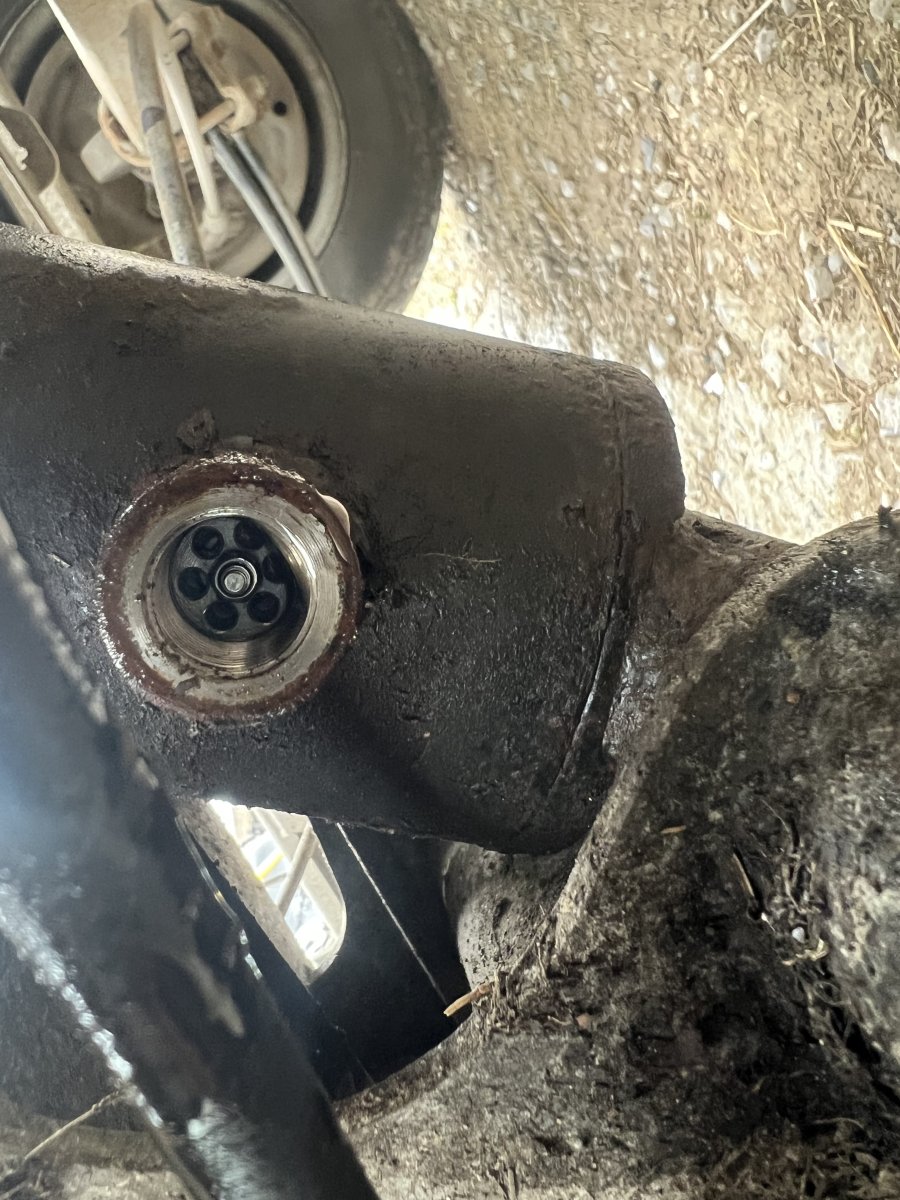

Mines gone really slow on down after tipping, there is a valve in the bottom of the ram i guess like a check valve type
Guess ram off and try unscrew the mesh see if anything in it?

Flow / orifice restrictor plate BTL,s

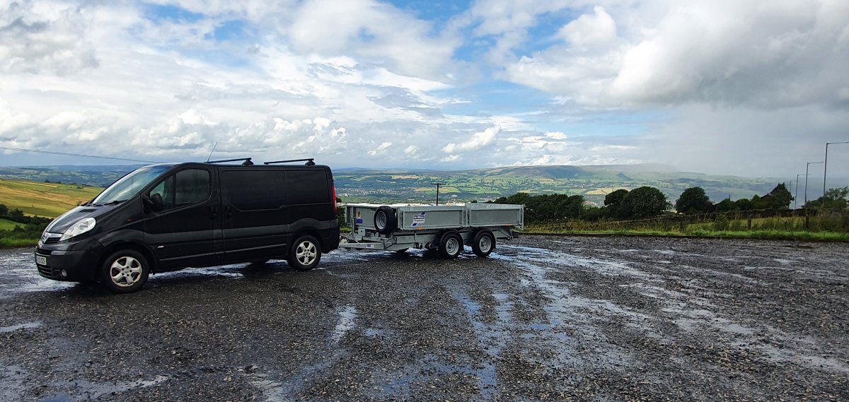

I got a good deal in the end, found two of the best priced dealers and pitched them off each other. I got solid sides too, they just hadn't arrived today when I went to pick it up. I didn't need them either today, I reckon I was well overweight with the load of sodden manure I had in it as it was. Ffs, I couldn't have picked a worse time, it's chucked it down heavily along with shitloads of high wind all day like much of the UK. I was pretty much expecting to get stuck in a field offloading it and wasn't disappointed.
It then went downhill from there too! :ROFLMAO:

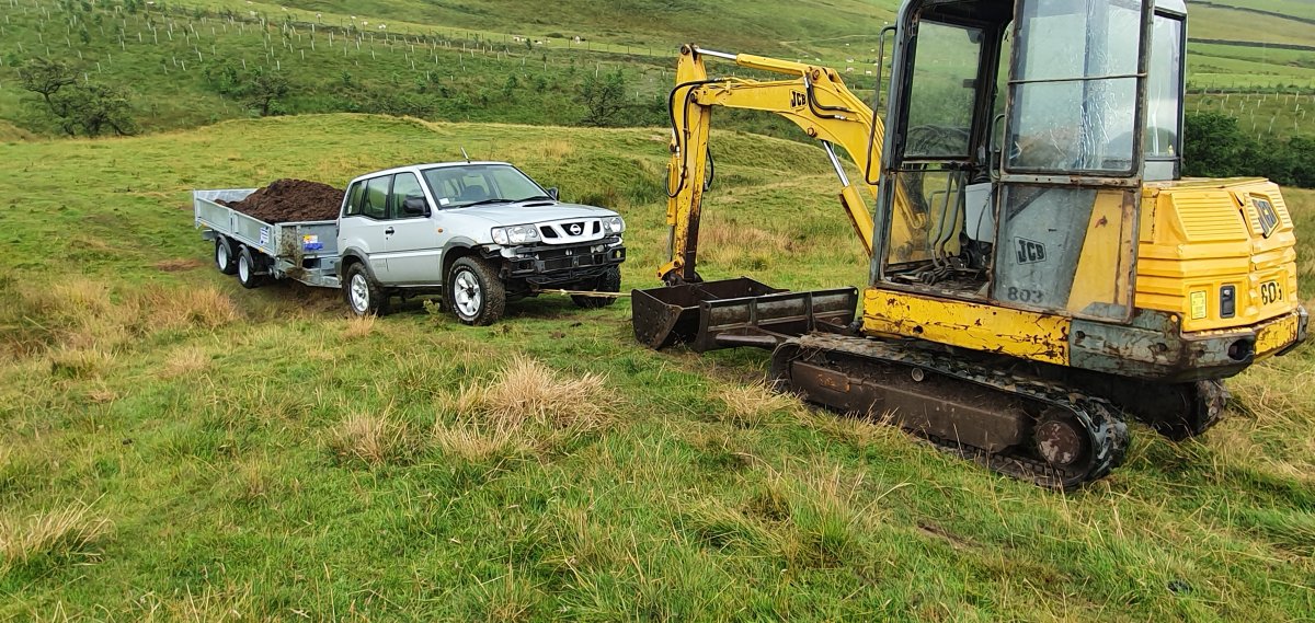

I did briefly consider a tipper truck, but for me it's just not worth the expense of maintenance, Tax, MOT, insurance etc when it'll be stood for most of its time.
If we'd had a Summer like the last two, or even back in June at least it would have got up there, but not after the recent heavy rain.
My 4x4 is off road only so I can play with it when I get the time. They came with two types of rear diffs and mine had the crap one (which went to no LSD) I had it swapped out for the earlier stronger version which I realise now was a mistake maybe, what I should have done is welded the original one up solid. I still have it so plan on doing this - if it ever stops raining. The later LSD in there now is much better, but it still slips if enough torque is applied.
You might recall from my other thread that I have a locking front diff kit for the front, I just haven't had time/weather to fit it yet. With a locking front diff and welded rear diff it'll be pretty much unstoppable as it's only when it goes 2wd that it struggles (one at the front, one at the back). There is that and also improving the bits of land where it does get stuck. The one in the pic is on my land so I can drop a load of hardcore in and make it less steep. It was such a steep incline the hitch bottomed out in the dip which didn't help.

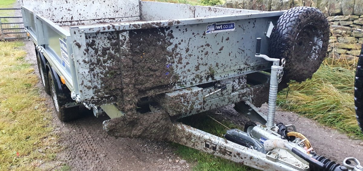

The entrance track to our house and fields is owned by our nobber of a neighbour who has messed them both up with his greed and stupidity before we got here. Just trying to get out of the fields today over his ruined track took several attempts and my lovely new trailer looking like this:
Taking it slowly and surely failed twice. It needed a run up with a bootfull in a higher gear to do it, but I was lucky not to slide into a wall.
It'll powerwash off!
Totally the wrong tool for the job. They are for taking larger loads of spoil on the road, thats all. Pretty useless for anything else.
I always find it more effective to run a pair of 3.5t tippers with one guy hopping between them, unless it’s a job a way away. I rarely use my tipper trailer.

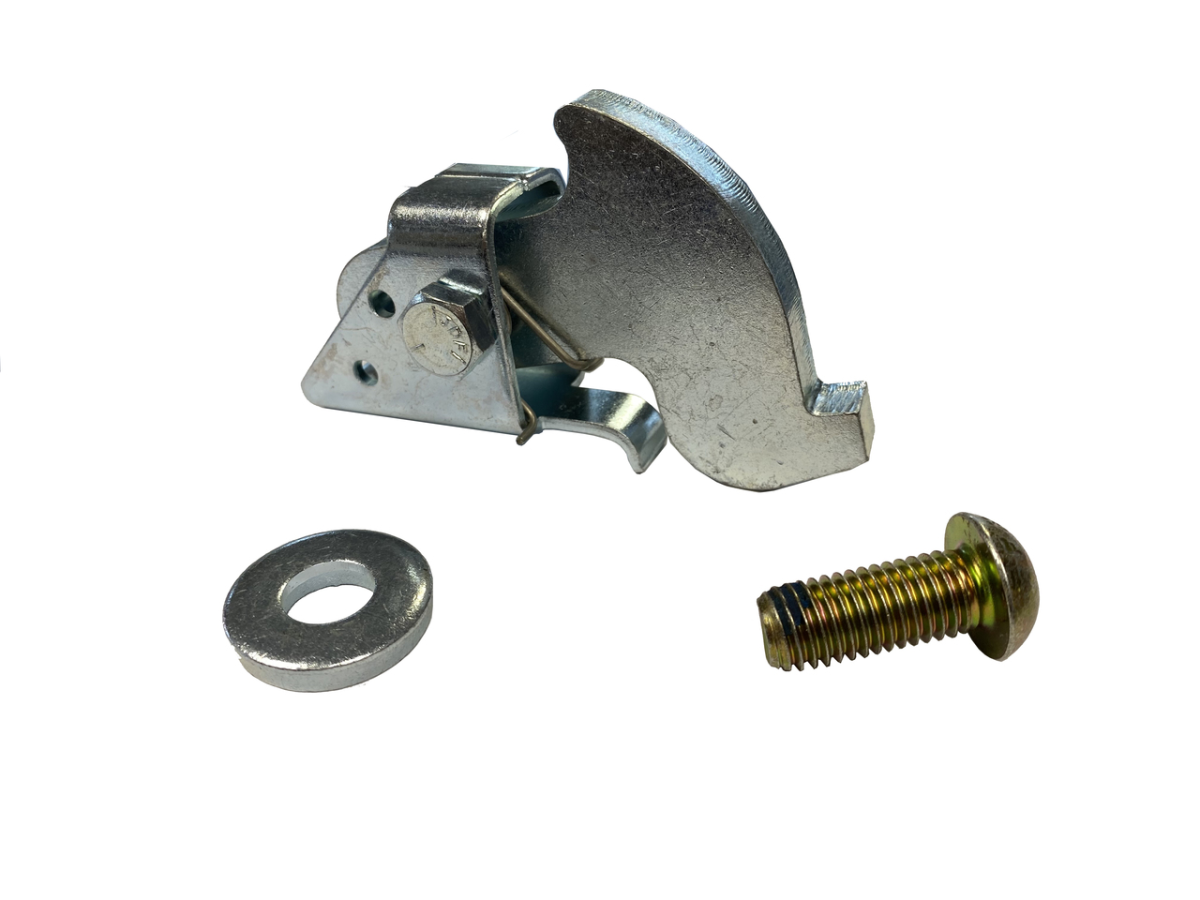

Get and fit a reverse catch, makes a massive difference when you have to reverse on slippy ground, where there is not enough grip to overcome the auto reverse brakes. They fit just behind the handle in the slot on your pic above.
The first one I came to when I had a search, but loads to choose from, https://gttowing.co.uk/product/knot...to-reverse-over-run-brake-stop-catch--p00915/

I don't wish to appear a knob, but if your 4wd is offroad only, why not just get an old dumper on flotation wheels or even a tracked one? Fair enough if you are bringing in spoil down a road, but for moving around on site I don't think anyone will disagree when I say it's not the right tool for the job.
Tbf doob id tend to agree id never dream of taking an Ifor off hardstanding round here...learnt the hard way . That's before we talk about the speed of dumping ...
Especially with a brand new trailer. That swivel that @Mogman had for sale would've been perfect
