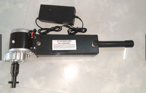

Up until now i had been using my drill to start it (its too worn out to use the pull cord) but the drill dosent like it because its got an auto brake when you release the trigger.

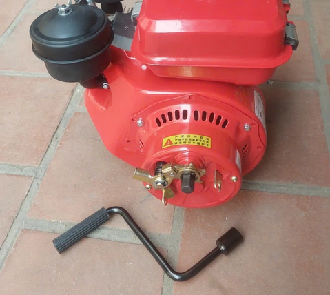

How about a crank-starter conversion?
While either would be pretty good, can you get the diesel chonders locally?
I bought one, but yet to try it, so I can't exactly recommend it, but it looks like a good idea.
I've also seen wind up spring starters for these engines too ... the crank also looks better than the damned recoil pull cord starts

The drill does start it but you would need a ratchet as my drill has an auto brake when you release the trigger, as the engine starts it fights against that. The second problem is the nut comes off the flywheel.

Funny - this subject came up in another forum a few days ago.
Kubota (plus clones) make a huge number of engines in the 10 to 30HP range (filthy beasts, but probably no worse than a Lister). So there are lots of 'ghetto starters' on the market.
